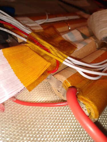

I can’t see any notable corrosion there… have you checked the individual cell voltages through the balance connector?

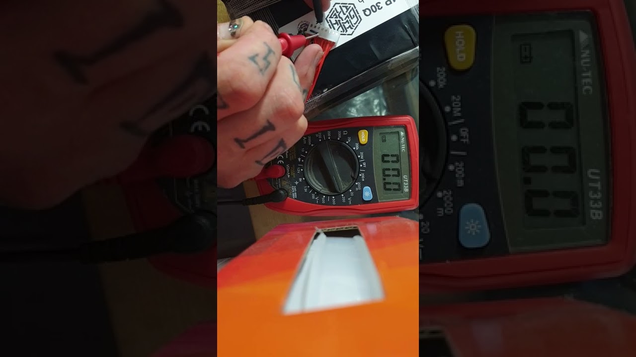

it’s 12.7mm by 1.6mm and it will be 610mm long on each side.

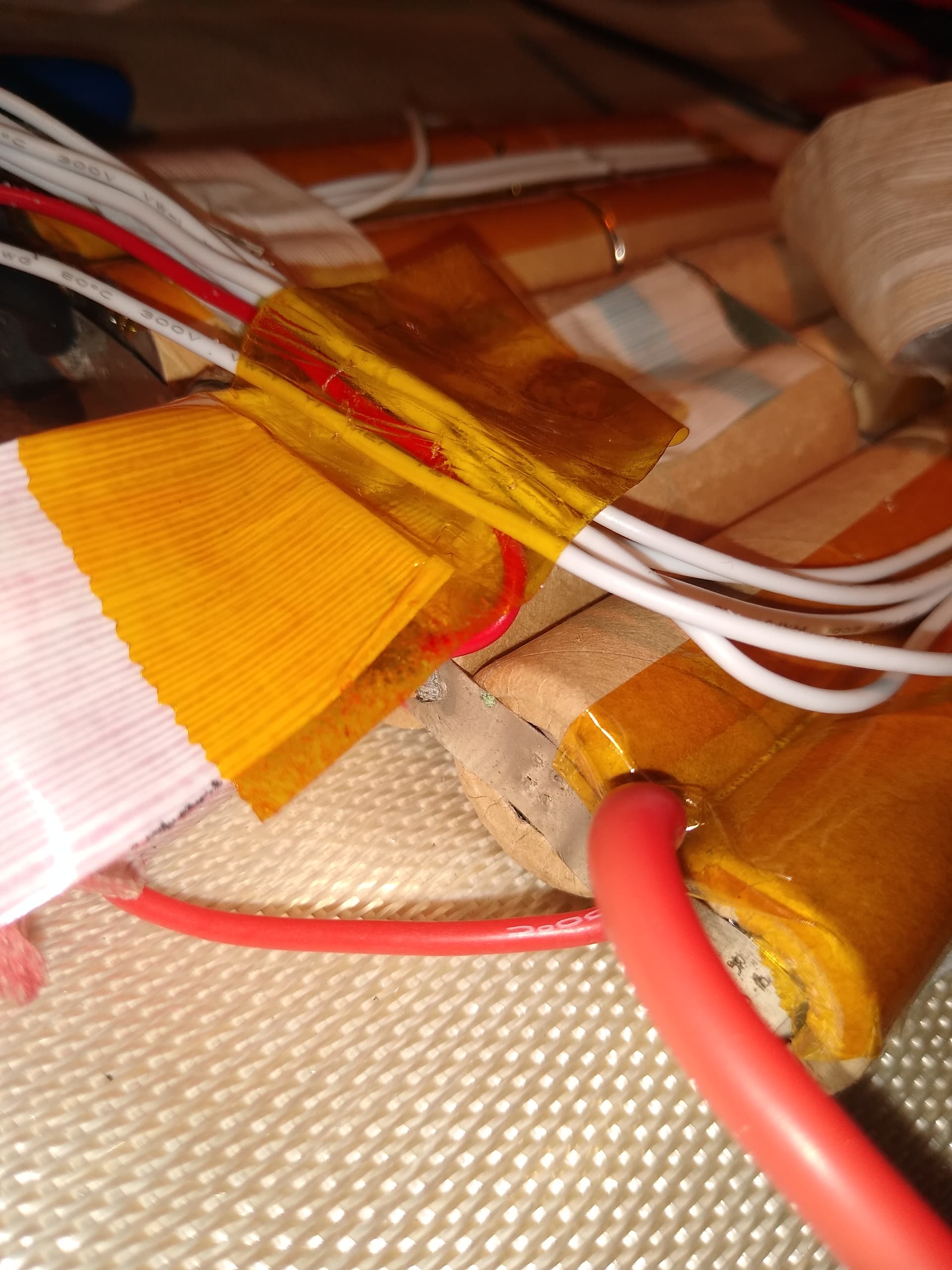

It’s the little green powdery spots that have me nervous.

Thats a very small amount of corrosion and I wouldn’t be too concerned about it.
You should be able to clean that up with a bit of isopropyl.
My bet is that your pack is out of balance for any number of reasons and that may be the cause of your problems
