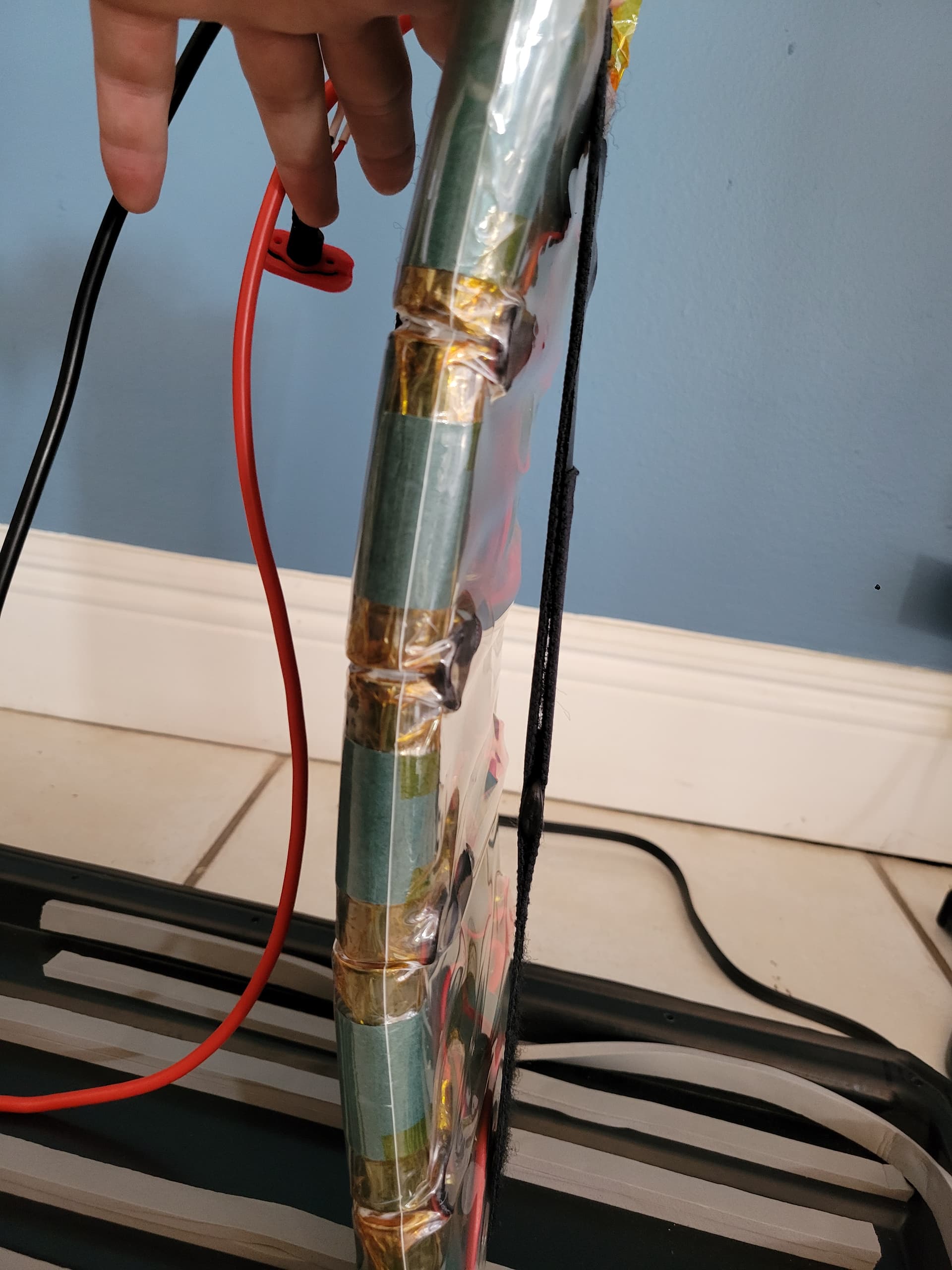

Hi, i’m making a triple stack battery without flex (for a shortboard)
Would this safely work with 2 0.2 x 25mm strips for the series connections? I plan on only drawing 50A max. I don’t really want to use wires because those are quite thick.

With 0.2mm nickel you’d definitely be in the safe zone for drawing 50A with a ~3 cell wide connection like that :+1:

Yes, those are plenty, even a single 25mm would be enough. Are you running a 6p pack?

Done
looks very good!
It has some flex to it, it a kinda stiff flex though
It charges, but I dont want to fully charge it because i have no way to discharge it. So I will keep it at storage voltage untill I am ready to finish my esk8.
Nice work dude!
Is that a tiller enclosure? With flex like that you can rest assured the enclosure will break before the battery does :sweat_smile:
