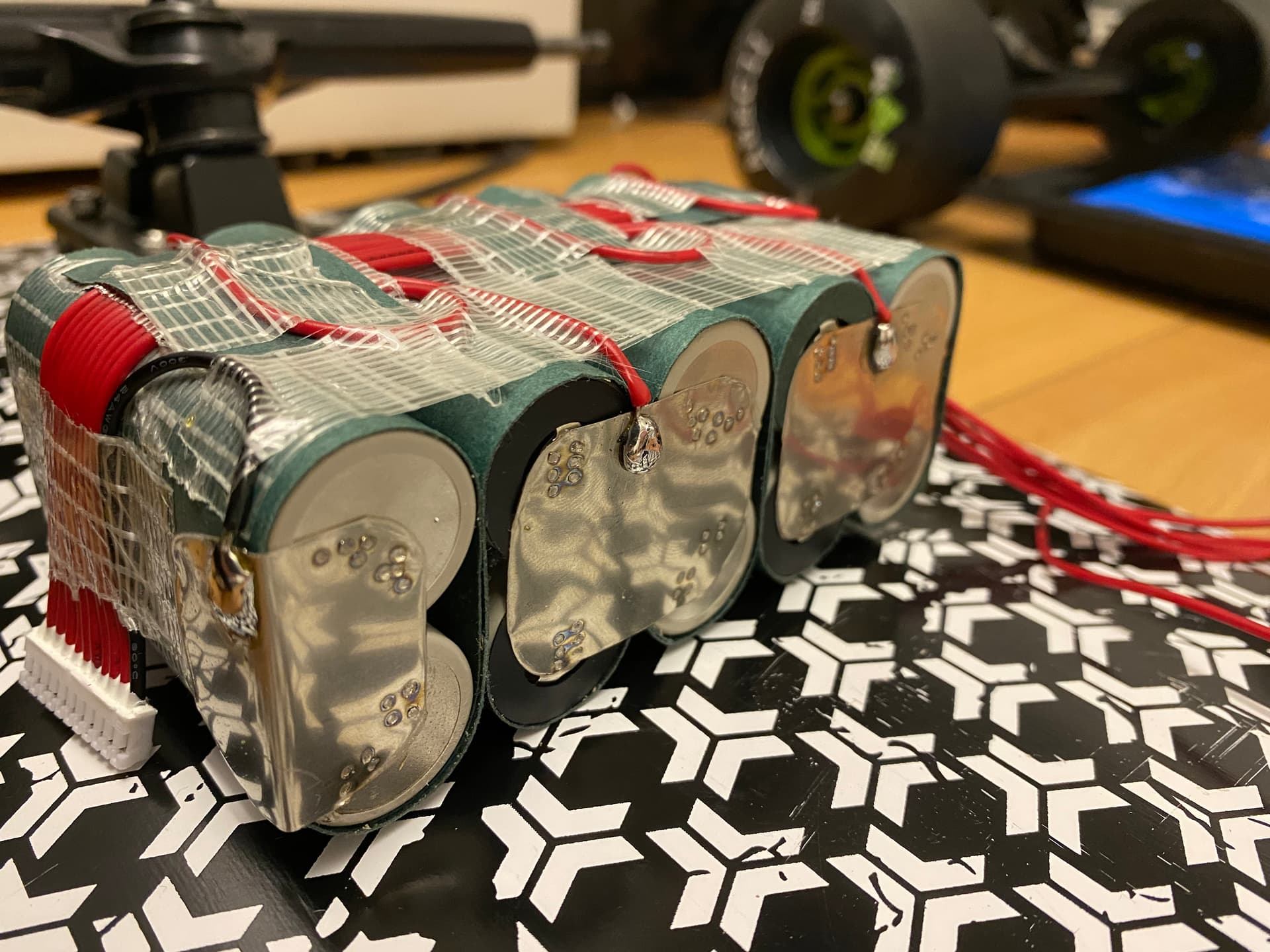

Whats wrong with the soldering though?? Its the way the wires look all a mess that turns me off about it… kinda like this LaCwa antispark i picked up… no idea what all those wires are for…scares me a lil…havent even attempted to try finding anything about it yet. .
Sweet little 10s2p
I’d reccomend using a bit of a longer nickel strip on the cell connections and going over the edge so you have a balance tab and there is no nickle limiting current, if possible
i.e
I was thinking about doing it but for balance leads I’m gonna just solder between cells

Sweet little 10s2p p42a
Just needs charge port and main leads done
Not bad.
Getting better, but try to avoid welding near the middle of the negative terminal
