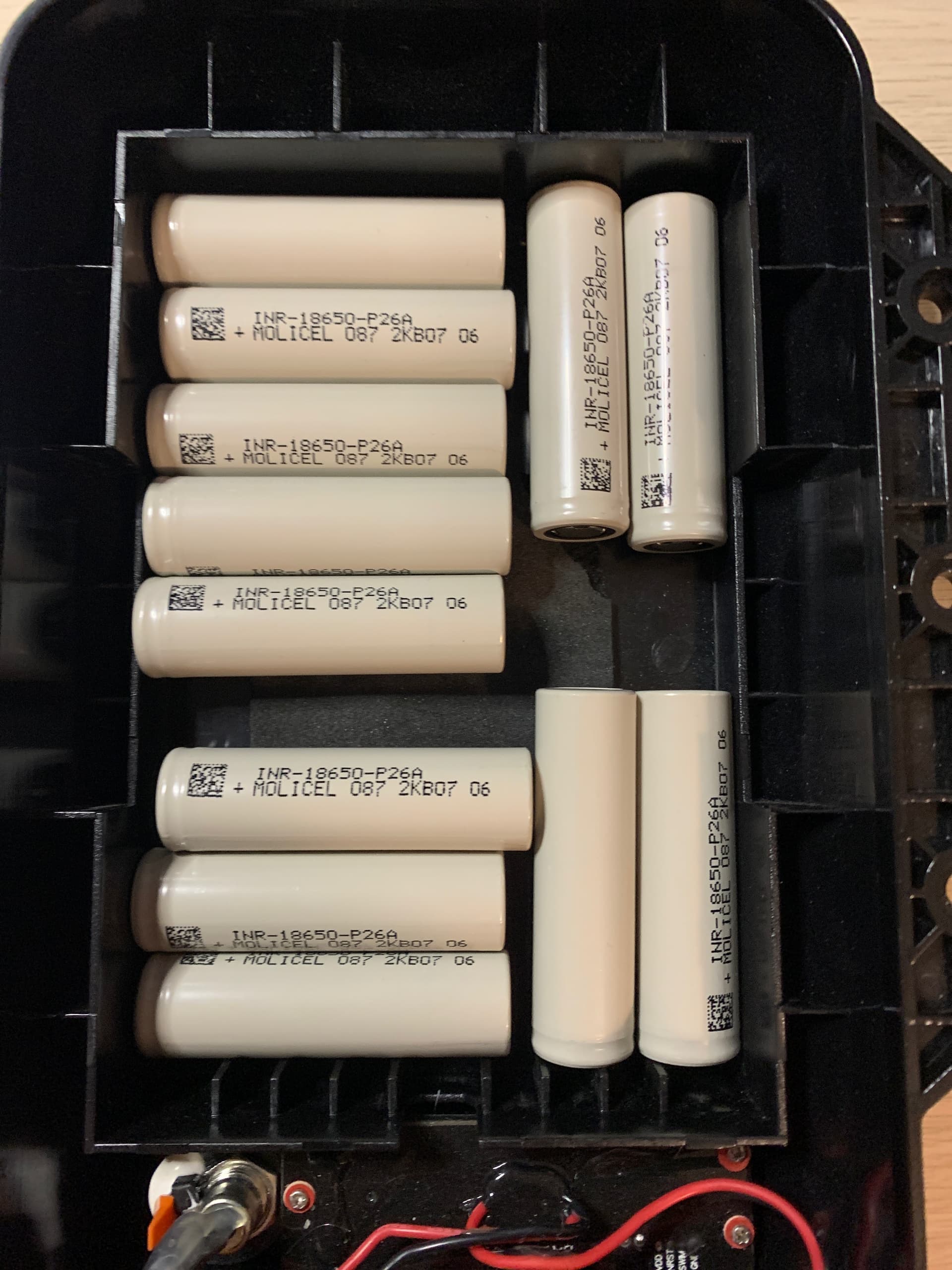

I wanna put a 12s2p P26A with LTT BMS in a Meepo V3 enclosure, what’s the best orientation?

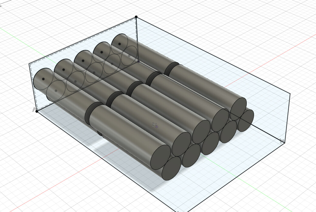

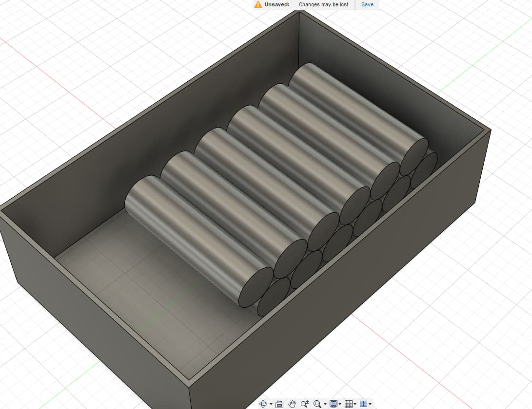

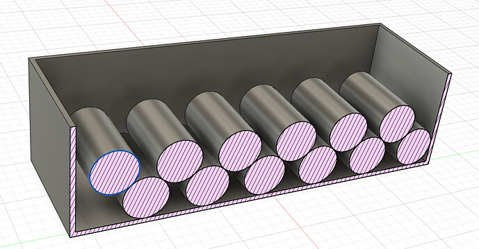

Try like this. Easy brick pack. Still ~10mm on top for the BMS.

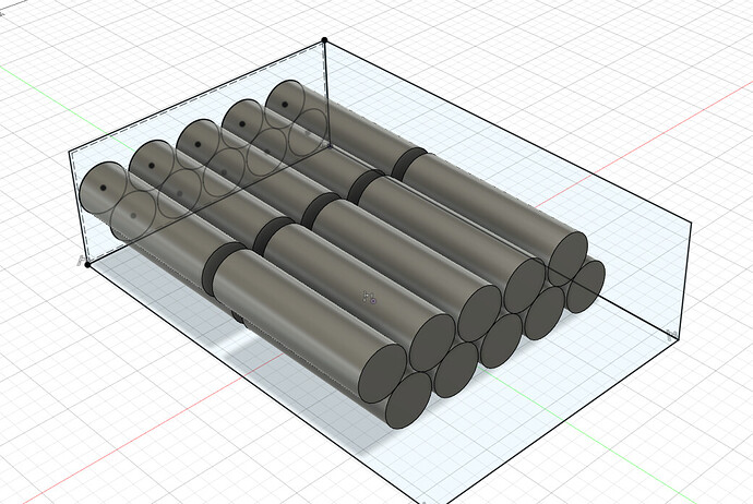

If you need even more vertical room, you could stretch the stagger a bit like this:
edit: Had a brain fart and only put in 12 cells, not 24. Derp.

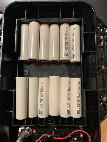

I only put half the cells in, would be 2 layers thick already
20 cells is easy, 24 plus a BMS… I dunno.
Maybe two bricks like this, plus two individual p-groups?
Or add one extra cell to each brick (make each 11 cells) and one extra p-group? But then you’d have a split p…
I might just remove the bulkhead plastic and do a front and back 6x2 stagger block with the BMS on top, I really don’t want to split a group
Yes I somehow don’t have a pic with it but if you just remove the plastic from one of the sides you’ll be able to fit 12S2P and if you stagger stack it I think you can fit everything easily.
Sounds good, guess I’mma have to make some dust
You can do a pretty good job to cut it out with some stout flush cutters/wire cutters.
