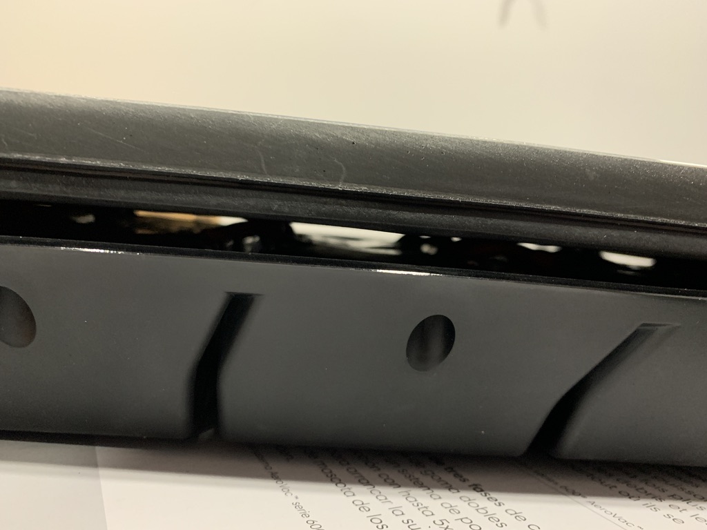

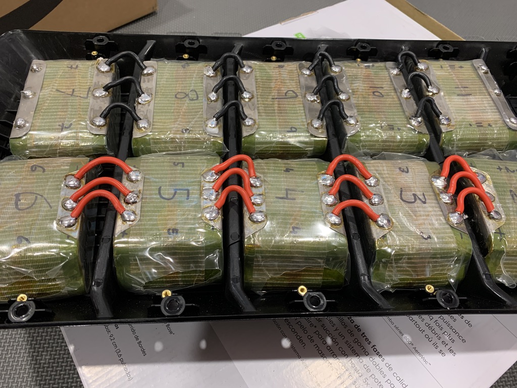

I’ve run into a little bit of a problem I could use your opinions. I was making good progress on the Flux AT2 battery (12s9p + P42a).
I tried to a fit test and unfortunately, there is a gap.
Questions
  1. Should I redo my solder connections to make them flatter? Should I redo it with something like a copper braid?
  2. Do I need to make a gasket? What materials do you use for making that?

Braid would reduce the thickness and @glyphiks recommended using X vs = configuration.
These are you p-groups right? Did they fit before the copper series wires?

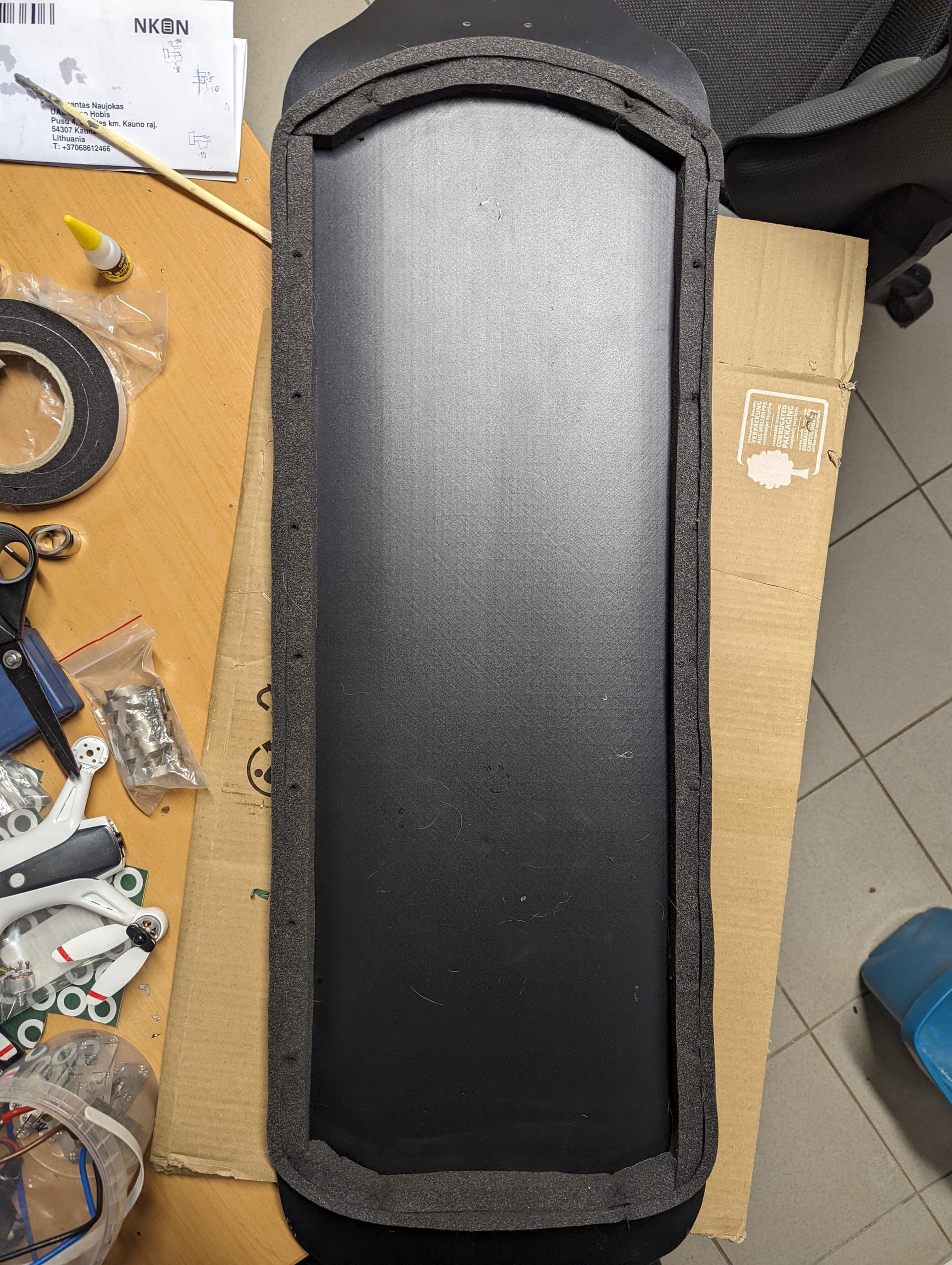

I’ve fit 12s10p 21700 in the AT2 with additional foam sealing padding.
You’ll need longer bolts too. 20mm works fine.
Yes, they were fitting before I soldered.
Do you have links for the screws and gasket material?
Screws are basic DIN 912 m5 20mm ones from the local hardware shop. The tape can be found here but it’s a Lithuanian store, not gonna be of much help.
It’s very squishy so fills up the gaps good. Though, I’m yet to see how it will hold up to puddles.
