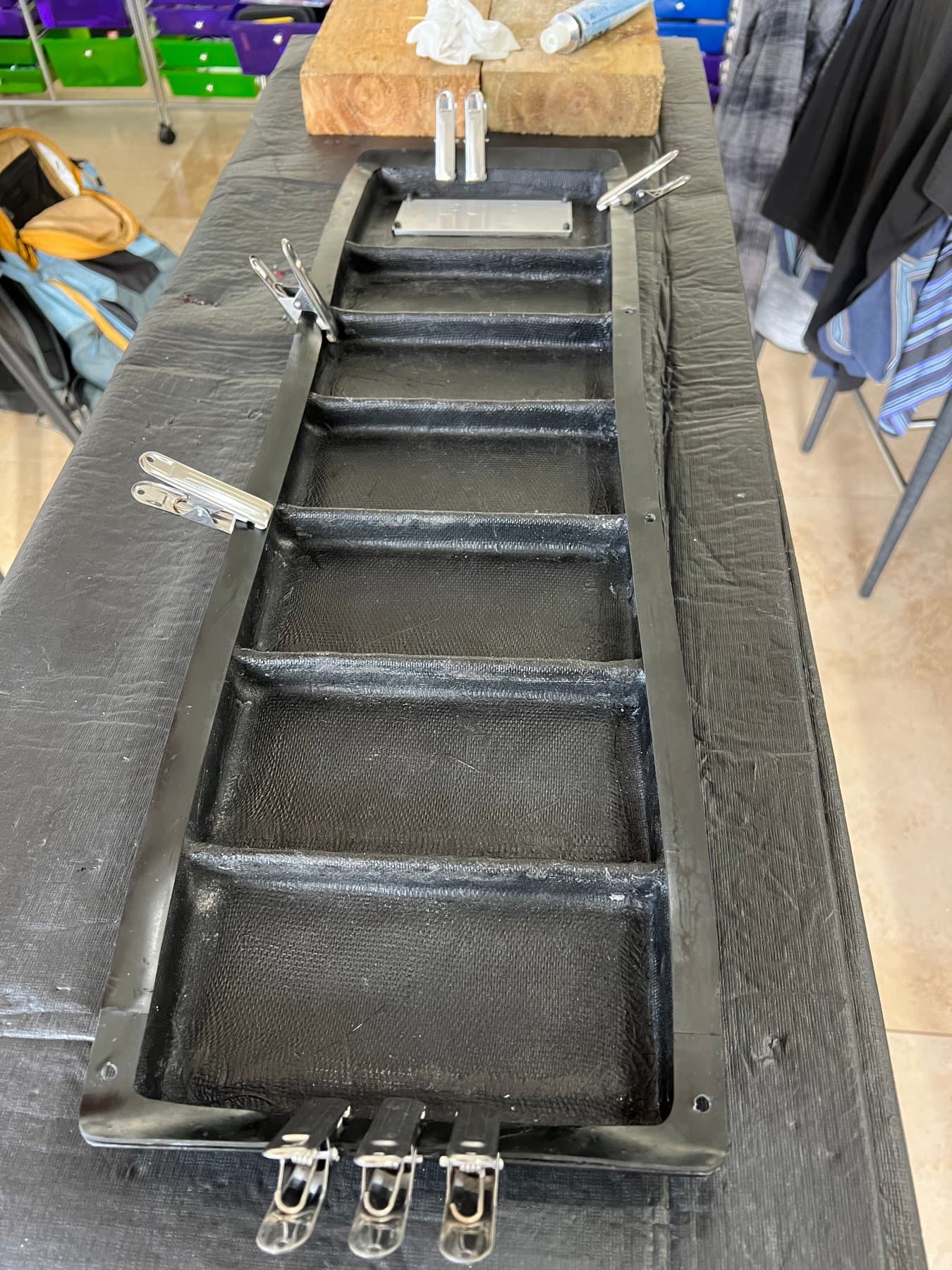

when you build flex.battery for enclosure with multiple pockets, do you sit your individual 4P groups on some soft padding (foam), or do you attach it to the bottom of the enclosure (double sided tape, silicone glue,…) ?
I suppose you wouldn’t just leave it there bouncing around ?
Mine is potted in silicone. Built by @longhairedboy . Can provide more specs later.
I like to use 3mm eva foam on both sides

“both sides”, meaning one layer at the bottom of the enclosure and 2nd layer attached to the board with the battery sandwiched between them ?
I usually line the whole enclosure with it, and put it on tge top of the battery too.
Dont stick it to the deck. You’ll hate yourself if you ever need to remove it

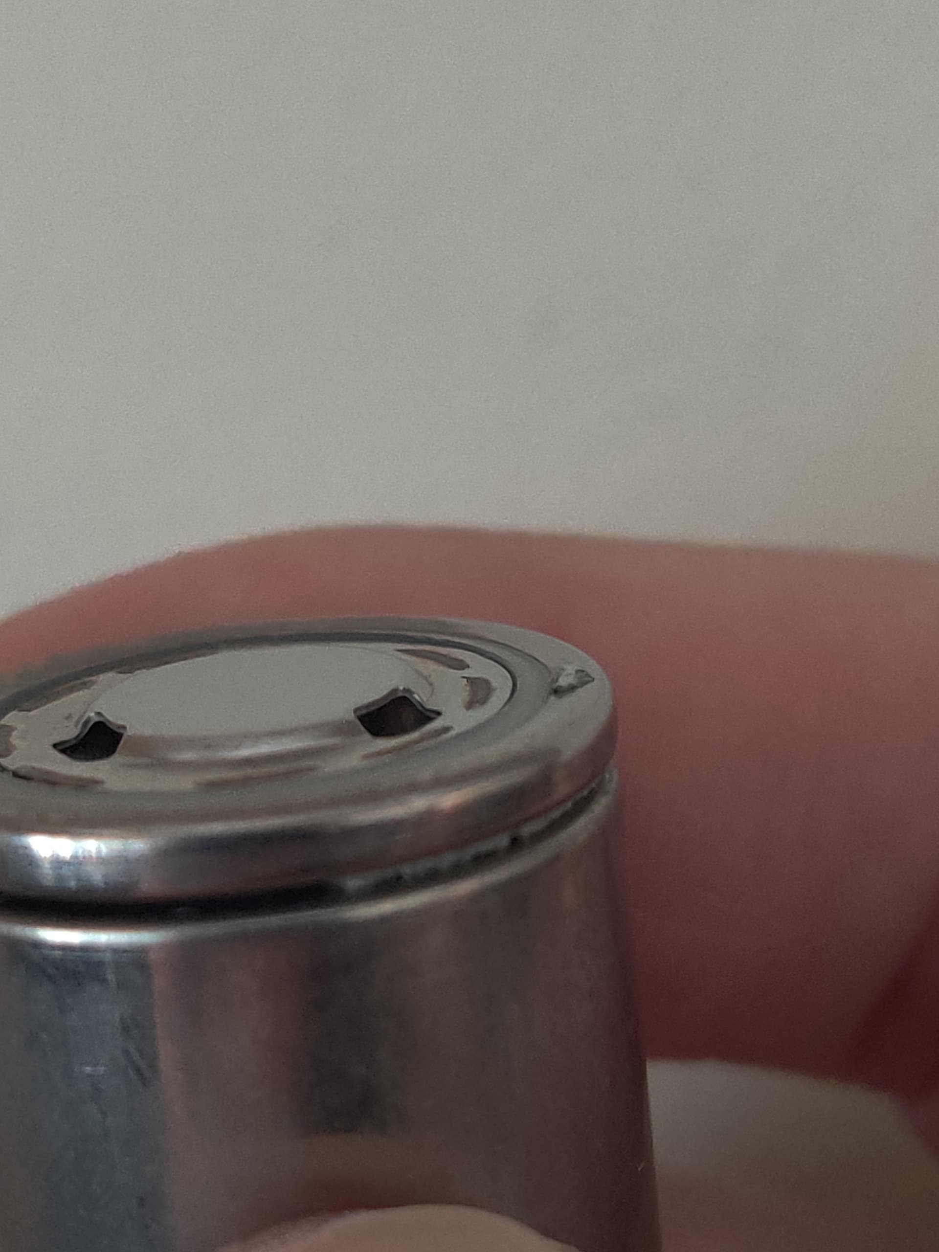

Quick but vital question: I got these model 3 cells a while back from battery hookup, and like half of them have this little chunk of metal stuck to it on the lip cell:
My question is, should I strip them down and sand these nibs off? Or should I be fine with the insulation ring that comes with them + another plastic ring on top when I spot weld these?
What the heck is that…debris from the spot welding on of the top contact by BH?
I say get rid of it. But not by sanding and creating lots of metal dust. Try a plastic spudger, or equivalent tool, and see if you can get it loose. Make sure it drops free of the cell and doesn’t wedge under the top contact.
