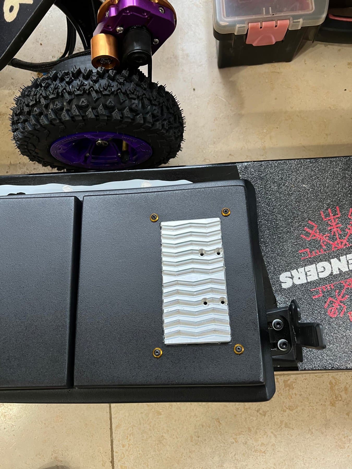

sure, and don’t get me wrong - I’m still building the battery to the best advice I received here.
however I cannot build an ESC, I have to buy one commercially available and there lies the bottleneck.
so I’m only raising a question in case I still missed something, because I’m building a battery capable of safely delivering 100A and then plugging it in to an ESC that’s limited to 40A.
whether this is acceptable practice, is really what I’m asking.
sure, I can swap the Xenith for Stormcore with XT90 connection and AWG10 wires from my battery terminals but that at 55A “optimal” limit would still be way off the capability of my battery.
as long as I’m told this is usual practice by other builders then I would know I’m not doing much wrong.
the previous eBoard I built (except the battery was done by an external builder) is running same Molicel but in 12S3P config and I’m limiting max battery current to 2x 37.5A and it has plenty of torque to climb some tasty offroad hills with the gearing I’m using.
the new board I’m building is also going to run with generous gearing 14T/76T and 160kv motors so I think limiting it again to 75A should be plenty.
and I have installed decent heatsink from @glyphiks
so hopefully this is reasonable setup

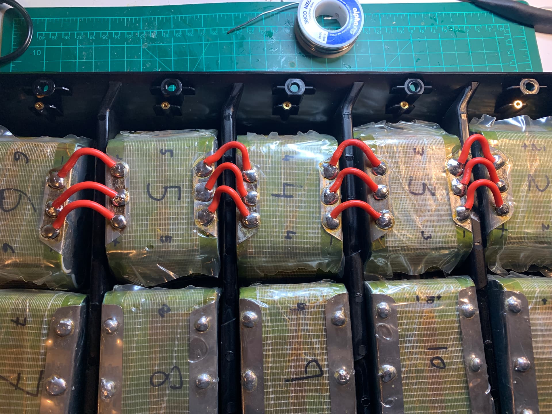

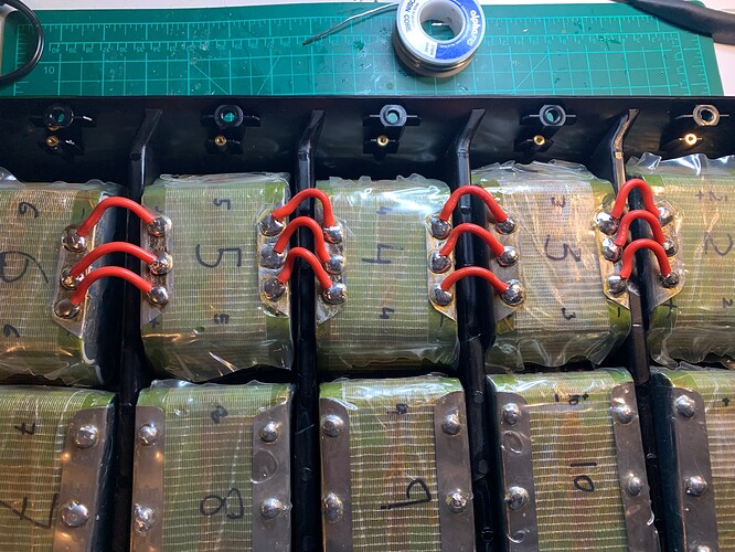

Hey friends. Any feedback on welds? I tried tugging and pulling and they hold.
Those solder joints look fine to me, there’s a good amount of flux and solder coverage. As long as the underlying surface was clean you should be fine. You could probably use a little less solder in your blobs if you want less heating of your batteries.
Looking good!
Looking pretty good dude, only suggestion would be to try and be a bit quicker. It looks like you have a decent amount of wick in some of those wires.
Avoiding wick is such a fine art
Just the right amount of time is required
Fine? Its more like “gotta-go-fast” :grinning_face_with_smiling_eyes:
Not too fast though or the wire doesn’t wick enough
Just get a big iron, thermal mass is everything. Or something very finely controlled.
My TS100 has been the best thing since cow tits and it’s so small
What temp do you solder at? I tried it at 300 and found it underwhelming
Custom FW, I use 350
If I solder big stuff like main lines or nickel I set mine to 450C. Works very well for big stuff as the thermal mass of the wires dampens the heat.
