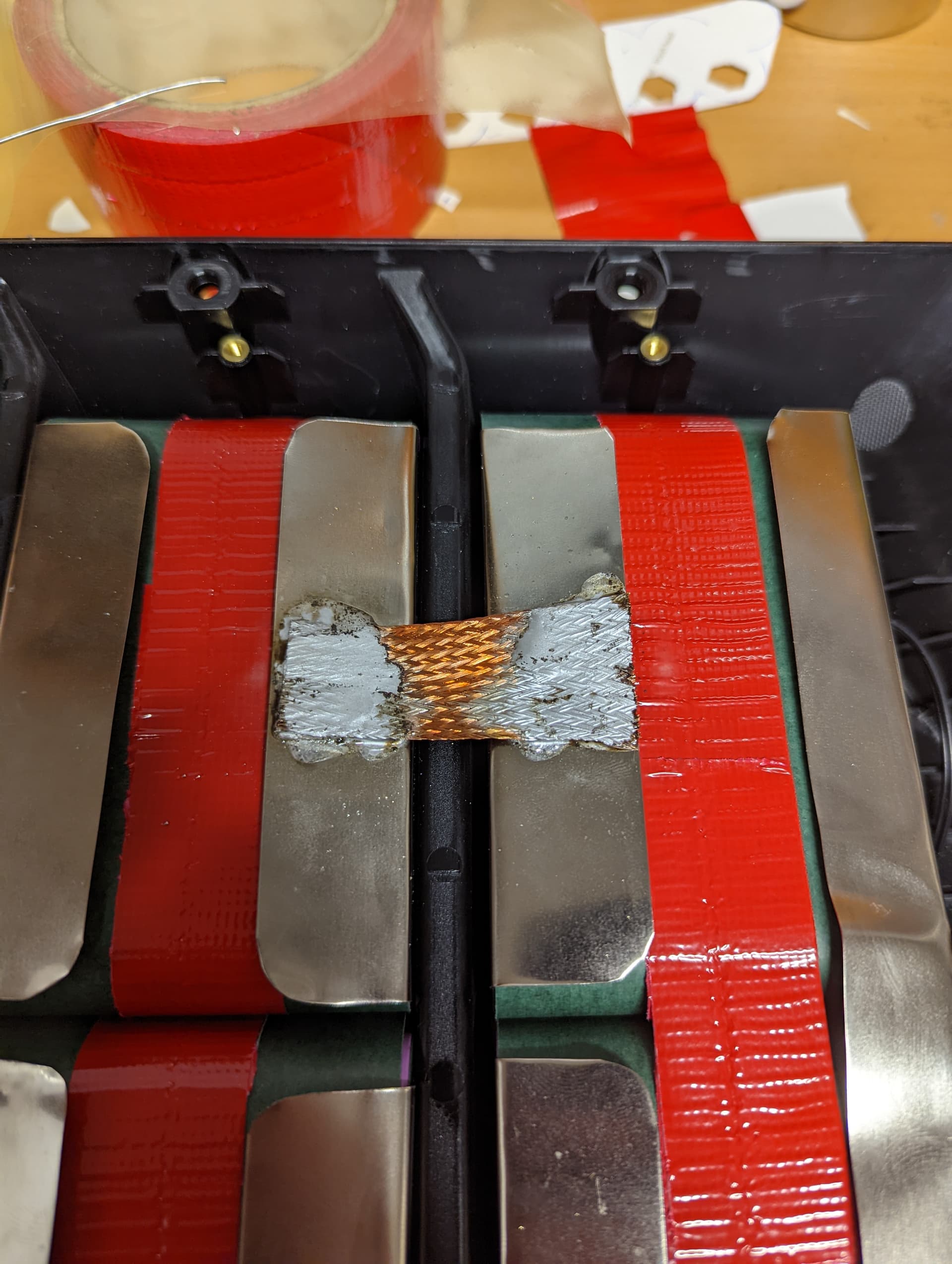

First time working with copper braid, does this joint look okay?
I’ve got a 200w iron so it did flow through all the way.
Should’ve gone for the tinned braid though.
Looks a bit cold if you ask me. Its probably fine though. This is a non-flex pack right?
it’s Flux at2, very little flex.
If you must use braid, it’s likely better to use it in a configuration like this…
It keeps the braid longer so that there is less chance of the solder wicking all the way through the braid. @TheRef has some good examples of this.
Personally I’d recommend silicone wire like this
Give it as much length/curve as you can to mitigate solder wicking.
Thanks.
