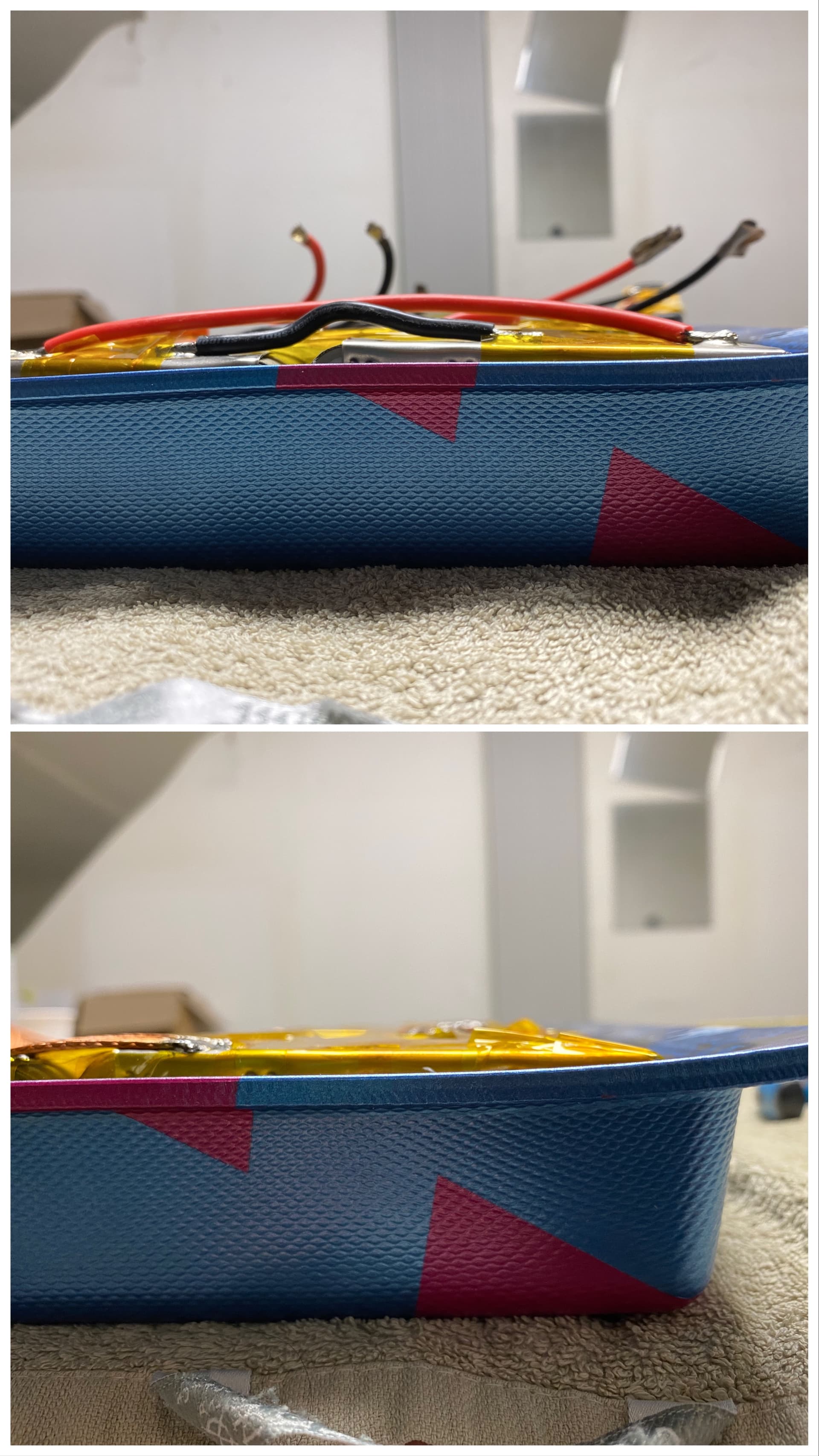

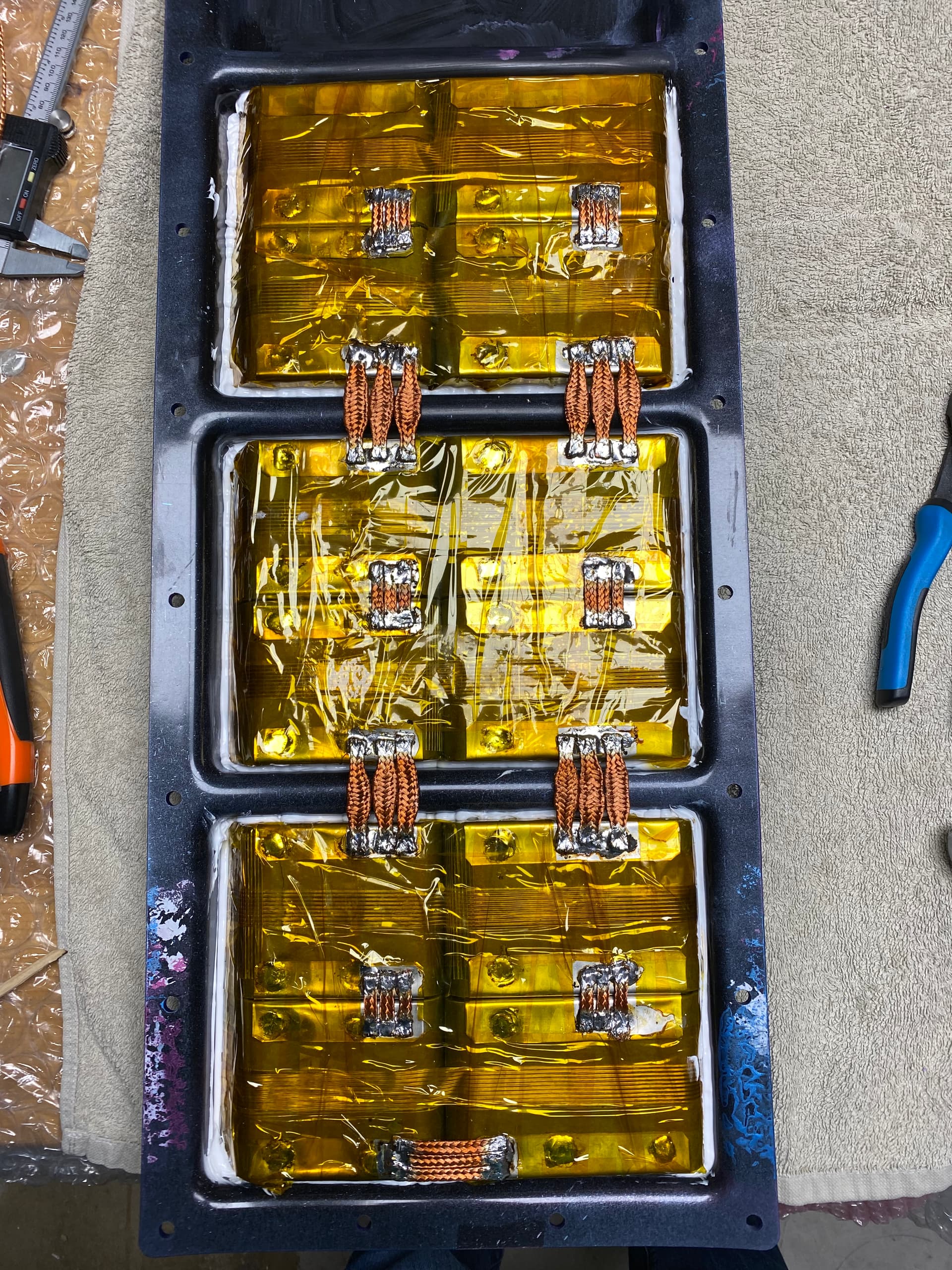

All right battery police. I need you to take a quick look and tell me if you see any issues here.

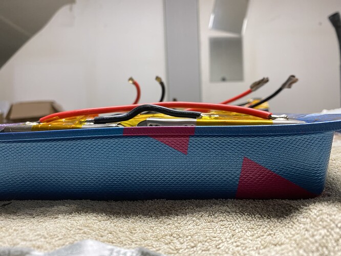

I had this battery made by @Acido so his usual stuff. Double fishpaoer between p groups, no welds at the center of negative pole. So that was top notch work.
But the battery came with 2x 12Awg wires between p groups. Unfortunately it is a bit too much in terms of hight for my taste to feel confortable.
I had a copper braid laying around so I’ve decided to go for it as a p group links.
I have weighted same length of stripped 12 awg wire and this copper braid, and the braid weight about 2% more. So I have assumed it can carry same if not higher current. But just in case I went with 3 links instead of 2.
Definitely saved some height.
Do you see any problems here? I’ll do balance wires today.
Always check voltage on the leads before you plug it into the bms… this will save you many a bms
Looks good from a glance… I would have used tinned braided copper. You are good in terms of ampacity though.
P.S. beautiful build man… you may have won this year… watch out for next :joy:
I personally would have tried to space the braids out more evenly along the tabs to avoid any high-current concentrations in the nickel as much as possible, but honestly this is more than fine as is. That would just be gilding the lily and nitpicking, for likely only a theoretical benefit.
I don’t like braid for flex connections. Gives me the heeby jeebies.

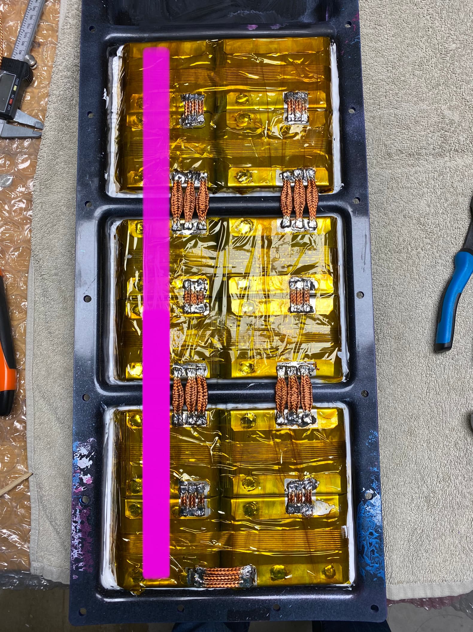

I get you. Why I did it this way is because I am planning to run all the balance wires on the left side of the pack. That’s the only route that is possible due to things I have on the bottom side of the deck.
I have similar feeling. What I did to try to mitigate this issue is to compact braid at places where it will flex a bit. It is much more flexible this way. But to be honest flux deck doesn’t flex much if any under my weight. I am 79kg.
