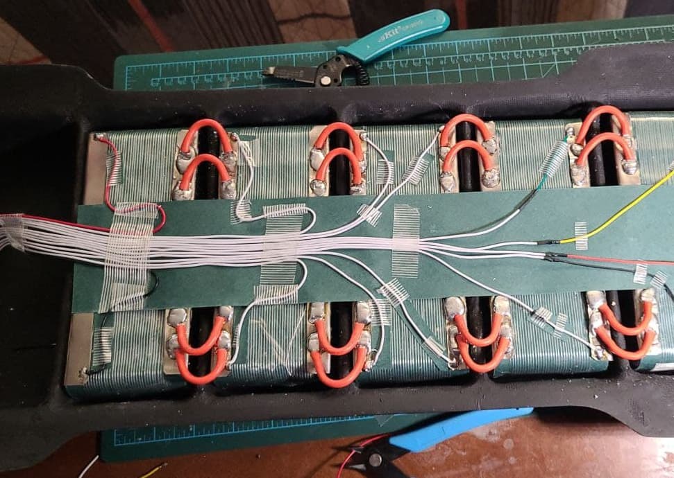

I think it looks pretty decent, all things considered. Definitely way better than most mass-produced battery packs that make it into eks8. Balance wires look clean.
I’d like to see something a little more robust than foam as a separator between the pack halves. Some plastic from a cheap cutting board or similar would be an easy swap.
If it were me, I’d probably do something about the solder-soaked series connections, even if all I did was take some flush cutters and cut out the middle, and add two pieces of 14awg in its place, without desoldering the rest of the wire.

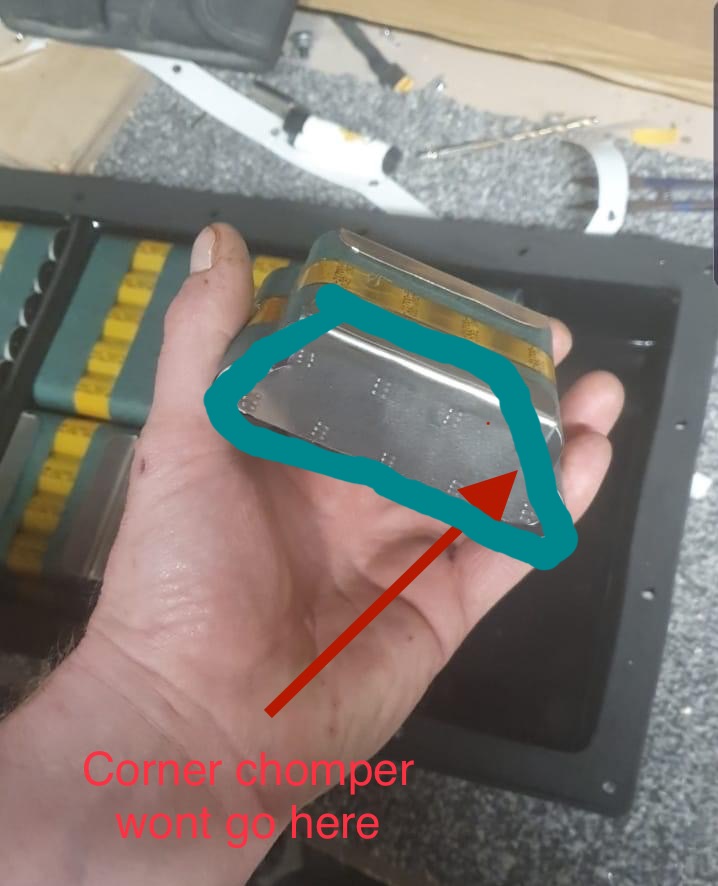

Not that it really helps you now, but i cut staggered nickel like this
Can’t use corner chomper, but decent scissors are fine.

Thank, for some reassurance. I know the soldering is not on point. I was thinking of redoing the series connections, but it didn’t occur to me I could just snip the hard wires away and solder on some flexible ones. I am a bit afraid of handling the pack. because I seen some videos of those things going up in flames + I newer did any soldering before that.
I will swap the foam for some hard plastic…that is easy enough to do. Thx for the tip!
So you think the balance wires are good enough? No need to cover them with neutral cure silicone or something like that?

Balance wires are fine, just maybe add a layer of kapton over it all.
Since your pack has zero flex tolerance, then you need to strap the battery something flat and stiff than is not the deck itself. This separates the flex of the deck from the battery.

I covered everything with kapton tape. I just forgot to take a picture.
I am actually planing to enclose the battery in this enclosure
Ad a wooden riser between the deck and the enclosure so I can take the whole battery off.
Would that be stiff enough? Any suggestions for a light stiff material?
A piece of wood would be fine, just something to keep the battery from any kind of bending or flexing whatsoever
