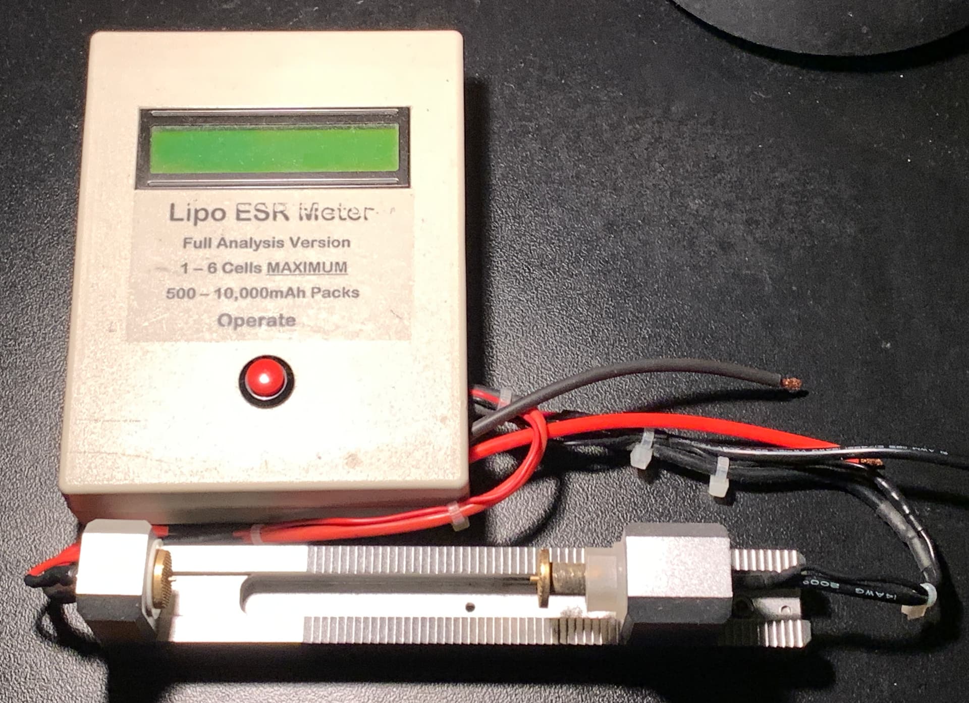

Could you post a pic of your test stand for single-cell testing? I’m having trouble picturing what the actual usage of this device would look like, though I’m certain that’s just a lack of imagination on my part.
Here is the jig. This unit needed a external PSU mod to do high-res testing of single cells as 1S didn’t supply a high enough voltage to operate. I also removed the balance connector and wires as this is a single-cell-only setup for me.
Check with Progressive RC or the manual to see if the external PSU mod is still needed for 1S. IIRC the manual had a graphic showing the connections for single cell testing.
The two loose leads are for any cells/packs that won’t fit in the holder.

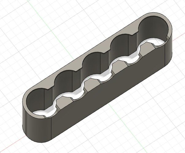

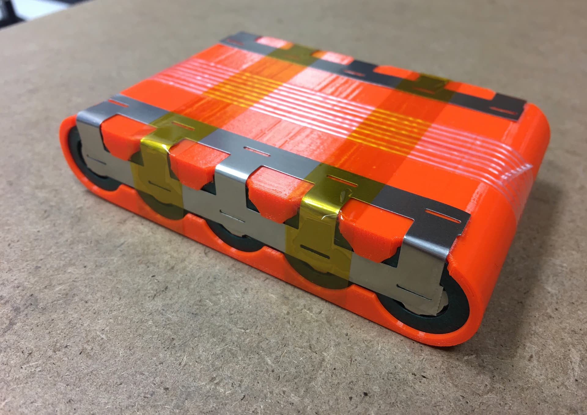

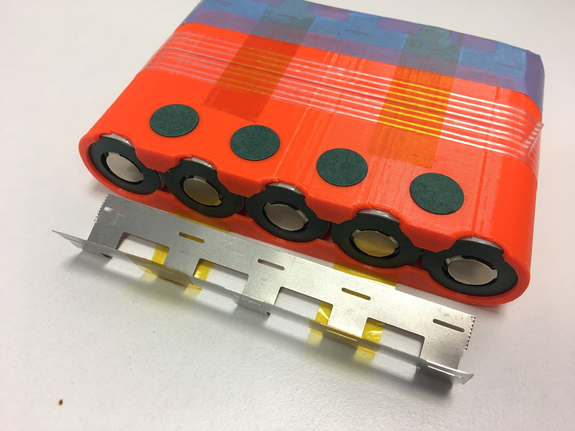

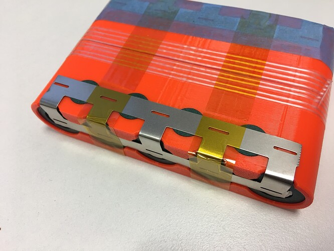

I’m starting to rebuild my 12S3P NESE battery to a 12S5P. Now, the problem is that I don’t have space for 12S5P with NESE modules. Spot welding seems inevitable. I haven’t done it before but I have read about on the Internet. :slight_smile:
To start with, here’s my idea of the parallel groups. Since I’m generally clumsy and I don’t like glueing things together and I don’t have enough fishpaper on hand and I like to 3D print stuff, I came up with this to both make the cells hold together and to insulate the P-groups:
Here’s a mock up of how I imagine the end result will look like:
The walls are only 0.8mm thin so this actually isn’t a lot bigger than if I wrapped the cells in fishpaper. It takes quite long to print but after that assembling the P-groups is super easy.
One potential issue I have considered is that when soldering wires on the nickel to connect the series, the printed part under the nickel gets hot and may deform. I have actually tested it and it doesn’t seem too bad. It’s printed from PETG so the heat resistance is decent.
Any other thoughts why this could be a bad idea before I go down?
That’s my concern too. Maybe if a little more heat resistance is needed you could use ABS?
Just solder wires to one end nickel tab before welding and when you are going to solder groups together put something between tab and print.
Or solder wires to one tab, and when doing second connection leave nickel perpendicular to cell and than try soldering.
That would work but it seems hard to do. And, as Homer Simpson likes to say, if something is hard to do it’s not worth doing. :slight_smile:
How about this?
