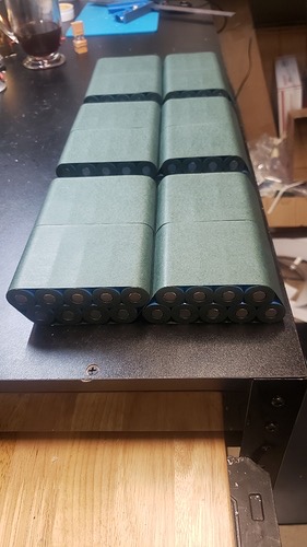

What width the preferred nickel width for a 12s9p staggered 21700 p group? I feel 30mm would be too wide since the inner diameter of the positive terminal is around 11m. Seems like I need around 22mm but I don’t think that is a readily available size. I can find 20mm, 25mm, 30mm and 27.5mm. I’ve long forgot my trigonometry :slight_smile:
I’m planning on 2 pieces of nickel: one piece folded over the the first row and a second piece over both rows of cells.

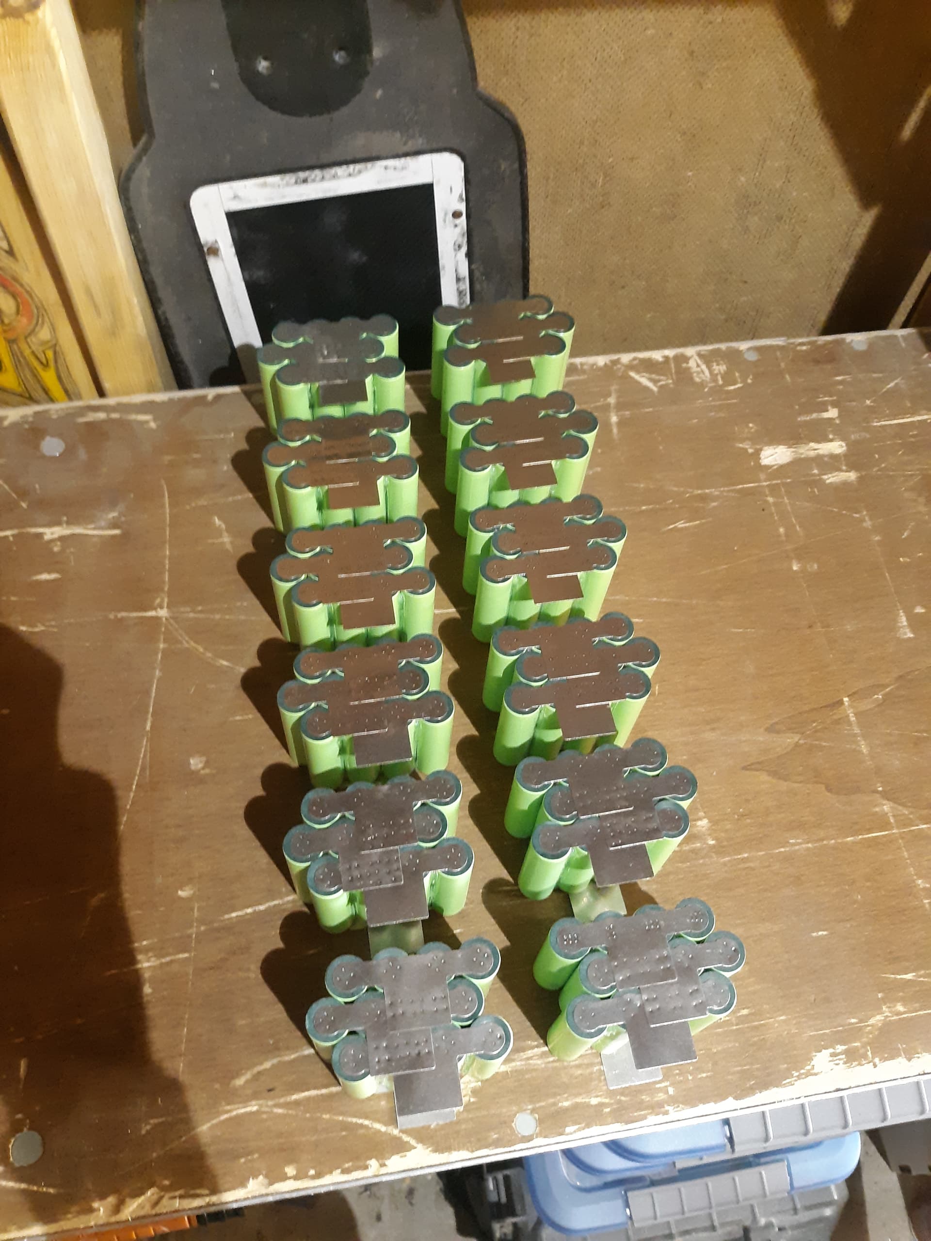

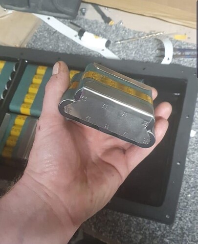

Here’s what I’m trying to build / mimic.
IMG_0651’
Well shit. Saw you’re doing 9p.
Using that would make my life a lot easier!!! I could live with a 12s8p too. I’m not sure it will fit very well inside the Flux and may cause rubbing between the deck the battery. :frowning: So decided to stagger instead of double stack.
If 9p fits currently, 8p will fit as well.
The flux enclosure is 4cm deep + 6mm foam gasket
8p double stack is 21mm * 2 = 4.2cm (so I will need to build a gasket which is not the end of the world)
9p is staggered is (21mm * 2)/sqrt(2) = (21*2)/sqrt(2) ~ 3.0 cm and plenty of room for wires etc. Did I do the math right?

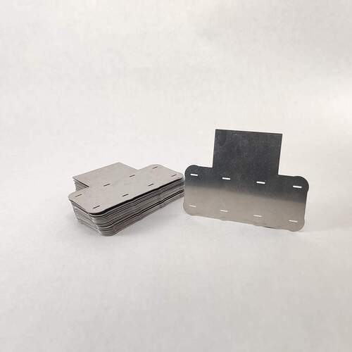

If you can handle 8p then just buy these and overlap the tab to the next set of 4
Like this
Ideally you want nickel wide enough to cover both the top and bottom layer of cells, and even more ideally have enough left over to fold over to make a tab on top.
Since a stagger-stack 21700 group is 41.05mm tall, you probably want a minimum of 30-35mm wide nickel to cover both layers. 50mm would be extra-nice because it’ll cover everything, and give you extra for a tab.
Thanks @MysticalDork I did the math wrong (60 degree angle vs 45). I need 42mm*.86 ~ 35mm. I will try to find a 50mm and avoid nickel on nickel welding.
50mm is ideal for this.
