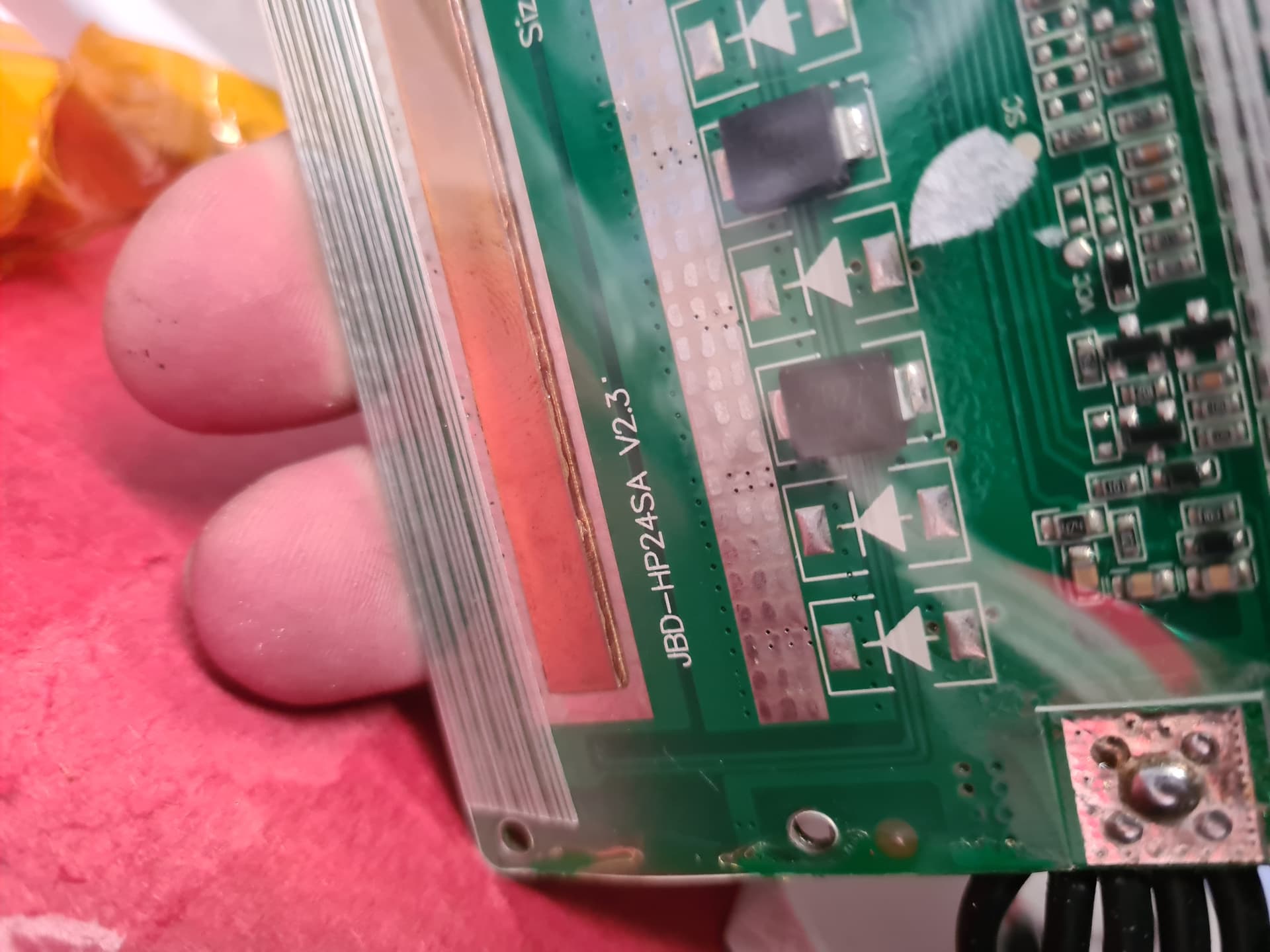

Anybody ever come across this bms before, and know where I can acquire?
looks like this one
Haha nice it does look exactly like that.

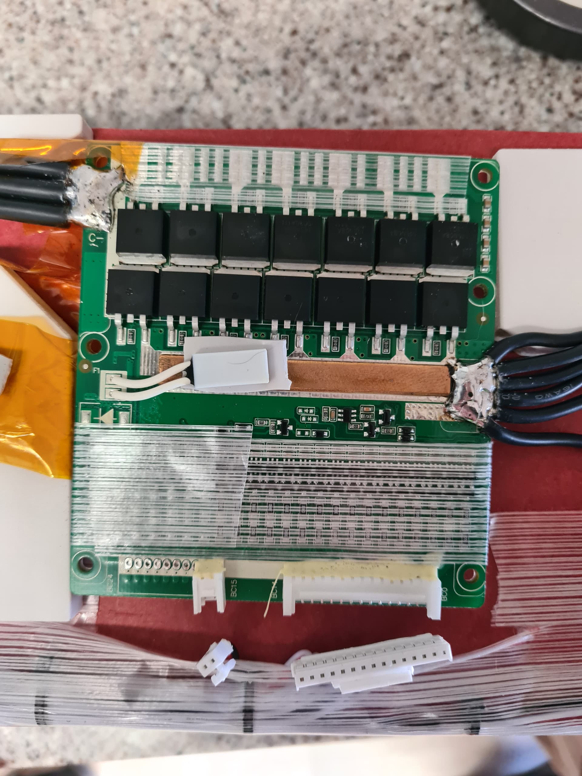

Local scooter distributor is having issues with batteries. I think i have just realised why.
The heatsink has been removed and there is no way for the mosfets to shed heat except open air
yeah when running anything close to 50A battery, these fets will get toasty in no time. These already are low quality fets. They need the cooling
It all makes sense now! This is an excellent revelation.
