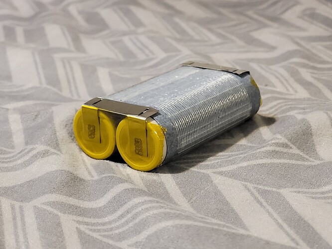

Do yall think that putting tape on top of fish paper compromises the abrasion resistance of the fishpaper?
My thinking is this:
If you have something you want to insulate, a layer of adhesive backed fish paper, and a layer of tape over that (kapton, fiber tape, whatever) then a cross-section of the stack of materials would look like this:
Tape
Tape’s adhesive
Fishpaper
Fishpaper’s adhesive
Thing you are trying to insulate
Lets imagine a scenario where the battery got packed in an enclosure carelessly and there is something pressing on this stack of materials while the esk8 (or whatever PEV) is under heavy vibration.
Assuming the tape on top is kapton or fiber tape, then it’s not abrasion resistant. So that gets worn through. Then what’s next in the stack? The tape’s adhesive. That gums up between whatever is pressing on the pack and the fishpaper, making the fishpaper no longer a smooth, low friction, robust surface. Rather it becomes a gummed up, torn up mess, and then it gets abraded through as well. And as soon as a small puncture is made through the fish paper, the fish paper’s own adhesive starts to work against it as well, speeding up the process. Then all that gets worn through and you have a short circuit.
Yall think this could be possible? I really hope not, because I almost always cover fishpaper with kapton tape to hold it down, since the adhesive backing on every fishpaper I have used likes to let go pretty quickly after it’s applied.

I would tend to think this too, also, how it is installed into the device matters too. There’s a big difference between just tossing a battery into an enclosure, and carefully adding foam padding on contact surfaces to prevent vibrations

  1. I’m not sure that sequence holds water. The presence of gumminess isn’t likely to make a difference to an abrasive surface in the positive sense. If the surface is actually abrasive, the texture would be smoothed by said gumming, making it less abrasive.
I also don’t believe that the smooth surface of the fish paper does much for its abrasion resistance. If an abrasive surface contacts it, it’ll bite regardless of the texture.
It’s how sandpaper will scratch a perfectly finished surface anyway. The material isn’t hard enough to cause a skid.
If you’ve got paper, and you have to tape it, I’m sure it’s fine.
Right, it’s more of its vibration dampening, thickness, and texture.
Vs if you leave a cell vibrating around in your enclosure, that plastic skin is gone.
Ask my lipos in my first build :flushed:
I’m not talking about abrasion from a sandpaper-like surface. I don’t know that any of the materials commonly used in our PEV batteries would hold up to something like that.
I’m talking about the abrasion that happens when you combine pressure and vibrations over a long period of time, even if the two things contacting are comparatively smooth surfaces. (Which, in my view, is the kind of abrasion we are talking about when discussing vibrations and abrasion in PEV’s.)
On my buddy’s first ebike build he didnt properly suspend his battery in his frame bag, so it was partially resting on the frame of the bike. The frame was painted completely smooth. The battery was in a nylon frame bag. The battery was wrapped up in several layers of fiber tape and fish paper. Still, after less than 500 miles of riding the paint on the frame was worn through to bare metal, the frame bag had a hole worn in it, and fiber tape/fishpaper on the battery was worn through, all the way down to the bare metal of the cell.
All that stuff is pretty smooth and pretty tough, but vibrations dont give a shit. They will tear through anything, given enough time. Luckily he caught that before it became a catastrophe, but it definitely taught him (and me) to respect vibrations and abrasion.
I’m just wondering if the fiber tape kept the fishpaper from doing it’s job. The hole that got worn through was pretty gummy around the edges where each layer was pulled back. I wonder if the tape, as it started to break down, caused the fishpaper to tear up little fibers along with it, similarly to how fishpaper (or any paper) tears apart when you stick tape to it and then pull up the tape.
