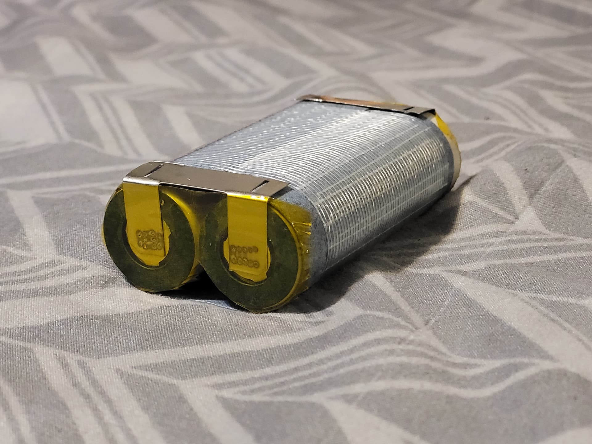

Hey everyone.
I’ve learned a lot from this forum and this thread in particular. I’m working on a 12s2p flexible battery with p42A cells. I ended up cutting some nickel strips that I had on hand to create a kind of U shape, then bending it over a 90 degree corner and welding it onto either end of the p groups. Max battery current will be limited to about 40A. I’m planning to do all the series connections with 8 gauge flexible wire/solder (what I have plenty of on hand) and I haven’t decided exactly how to make the “backbone” of the battery, but I have a couple of ideas.
Thanks in advance for any advice.
What you see here is fiber reinforced tape, fish paper, and 0.2mm nickel strip. The cells are also hot glued together inside the wrapping.
aaaaaand criticize.
Can we see the negative end? Also, the amount of welds on that positive end seems excessive for 40a haha

This looks mostly good, though you should check the Conductor Current Ratings chart to make sure you have enough cross-sectional area of nickel for 20A per cell. The legs of those nickel pieces look a little thin for that kind of current, though if you are not maxing out the amps all the time them it’s probably find.
My bigger concern is that it looks like you didnt round the corners out on the folded-over section, I see some jagged and sharp edges in that first picture. Maybe go back and make sure there’s nothing there that can rub through the fishpaper on the cells.
