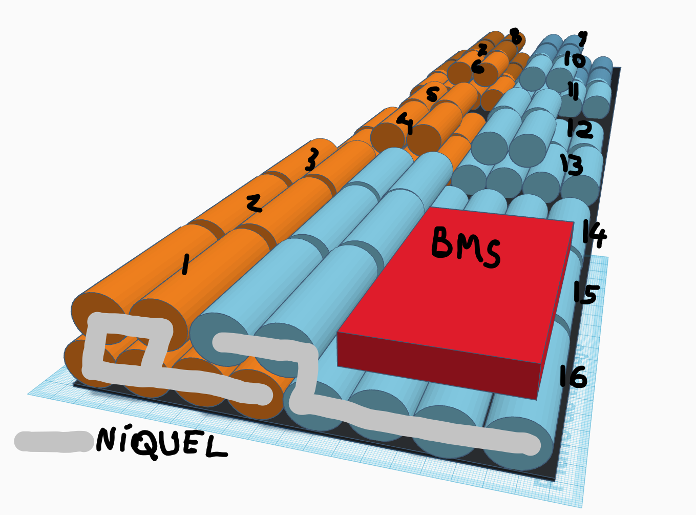

How do you see my sketch for a 16s6p battery?
It seems harder to build than necessary. What are you trying to fit this inside of?
The molicel p42a 16s6p, a bms (13x66x128mm) and I wish the ubox could fit, but with just the cells and the bms is ok. Inside eboosted haero bro ds
Oh I have this sitting in my shop, Ill try to find you a better config.
But now that I know the enclosure type I think you did create a good layout. Are you planning on using a smart BMS?
Yeah, daly smart bms with bluetooth, for charge only. Thanks a lot
