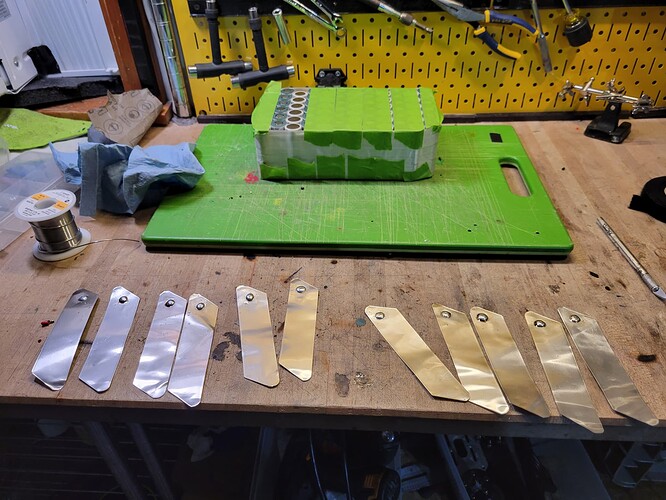

12s3p Molicel p42a for a OneWheel type thing. Most of the credit goes to @glyphiks for this one (thanks again!), first half of the build is probably a few thousand posts back, I’m just soldering the wires on trying not to screw up his good work :sweat_smile:.
Second battery ever and it seems a lot better, which no doubt owes a lot to this thread.
Bought a tube of black silicone, mainly to give the balance wires a flexible support off the top of the pack. Probably went a bit overboard with it elsewhere. Al was good enough to include a bunch of fish paper for the top so this will all be covered, just thought I’d post this before sealing it all up.
Interested in thoughts on the front of the pack (or anything else). This obviously needs to be covered up.
Plan is to overlap some bits of fish paper as follows.
This end of the pack faces the end of the board where the internal space ends in a bit of a wedge, so I’m not expecting any pressure to be applied to this area. Same reason why I didn’t cross wires on the top of the pack, there’s space to reorder the wires (BMS to top of pack order) in front of the pack.
Printed this little loom kind of thing to help to help out with that reordering process.
Please excuse the balance wire colours; ran out part way through. Of course, if I hadn’t been so conservative with the wire lengths when crimping everything I would have had more than enough. Clipped off enough excess length to wire another pack :roll_eyes:
