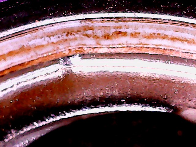

If this cell performs poorly or self-discharges quickly then perhaps the seal was breached and the electrolyte has started evaporating.
@Venom121212, is there a distinctly chemical smell coming from the top of that cell. Like a sickly-sweet solvent?
No smell but cell #2 has another similar defect.
WIN_20210929_11_09_16_Pro
WIN_20210929_11_08_06_Pro
Also, the second white insulator ring is off white and more rubbery like an O ring.
I jump this pack and offroad a lot with it. I wonder how much damage that could cause. It was suspended in foam but definitely felt some vibrations.
I’ve never seen damage like that on a cell so perhaps it is from welding, as @TheBoardGarage posted. It’s way off to the side though….weird.
The manufacturers say to protect cells from shock and vibration but I haven’t seen any data on how much they can actually handle before being damaged internally. The frequency of the vibrations could be as important as their strength.
