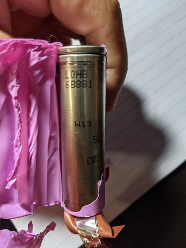

  1. ring was free floating
  2. Line1 - L0HB
    Line 2 - 6B881
    Line 3 - W13
    Line 4 - B01
    Line 5 - C01
  3. backwards y
    WIN_20210928_21_30_08_Pro
  4. looks like C0
    WIN_20210928_21_43_54_Pro
IMO everything points to those being genuine. :thinking:
I’m wondering what’s going on though at the circled points in the image below. Point A almost looks like an opening in the seal and Point B looks like a burn mark? Those shouldn’t be there.
If I were to guess, I’d say the welder electrode missed, pulsing the nickel over the gap.
