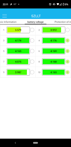

Alright I tried my best but I’m reaching out once again for advice.
Background:

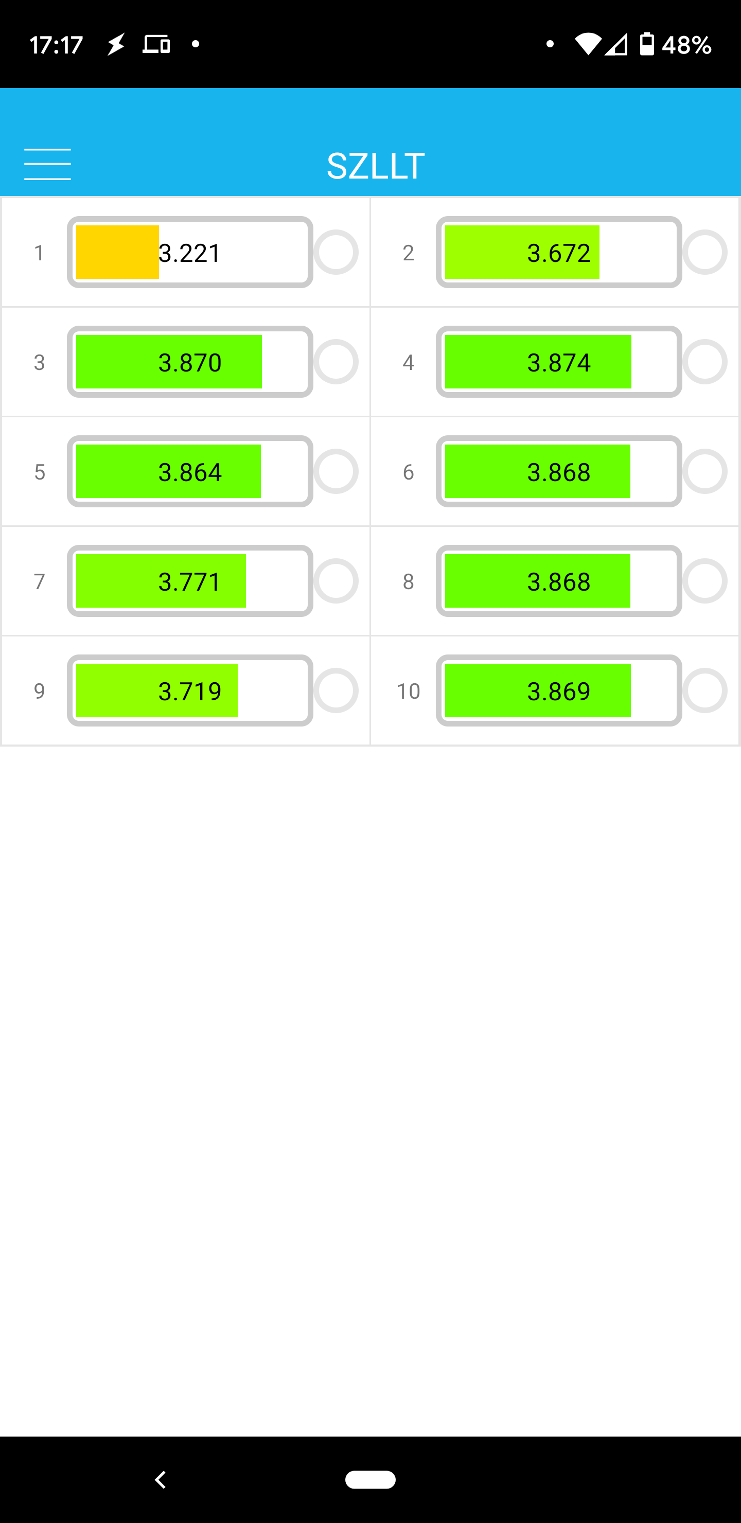

10s5p would drop ~2v right off the charger. Got a smart bms installed and saw one p group sitting low.
Fully charged:
After some discharge:

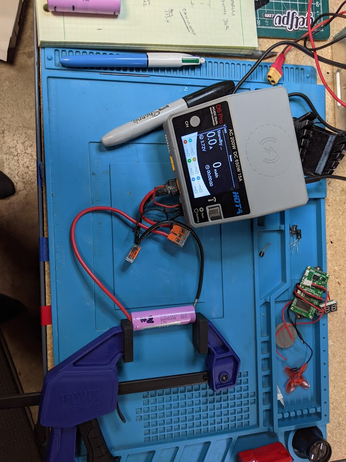

Started tearing out the p group.
Started isolating cells and they’re all at a relatively similar voltage level… No dead outliers. Measuring the internal resistance gives:
Compared to a fresh cell IR of ~53 mOhm
I don’t know if that p group being wonky for a while would cause that, if replacing the whole p group would fix everything, or if I should just cut the pack down to 4p.

How did you measure the internal resistance? Are you confident your measurements are accurate?

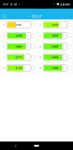

Before replacing always try to work/ improve on what you have. Try bringing the p group up to matching voltage with a slow charge and give it a run. If they are damaged internally ¿ they will show you within the first ride. How new is this pack?
D6 pro
@Bigdaddyhawk, the pack is 2 years old but acted funny from early on. Bms would get stupidly hot when balancing and I had a feeling something was wrong.
Bringing that p group up slowly worked but it still dropped off pretty quickly the second we removed the charge leads.

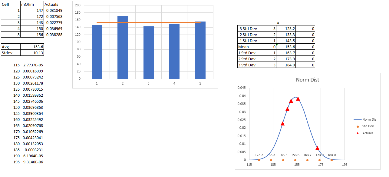

140-170mOhms is astoundingly high and a really bad sign. New Samsung 30Q’s have a DC IR of about 22mOhms. All the cells in that group being that way is very strange too.
I can see one cell doing that but all of them? Could that p-group been discharged down below zero volts or badly overcharged?
Carefully charge each cell in that group separately, let them rest for a couple of hours, and then measure their voltages. Leave them for 24 hours and check voltages again. If there’s much more than a few millivolts voltage drop (should be less than that though) then that cell is probably badly damaged. The high IR already indicates that but a high self-discharge rate is another good indicator.

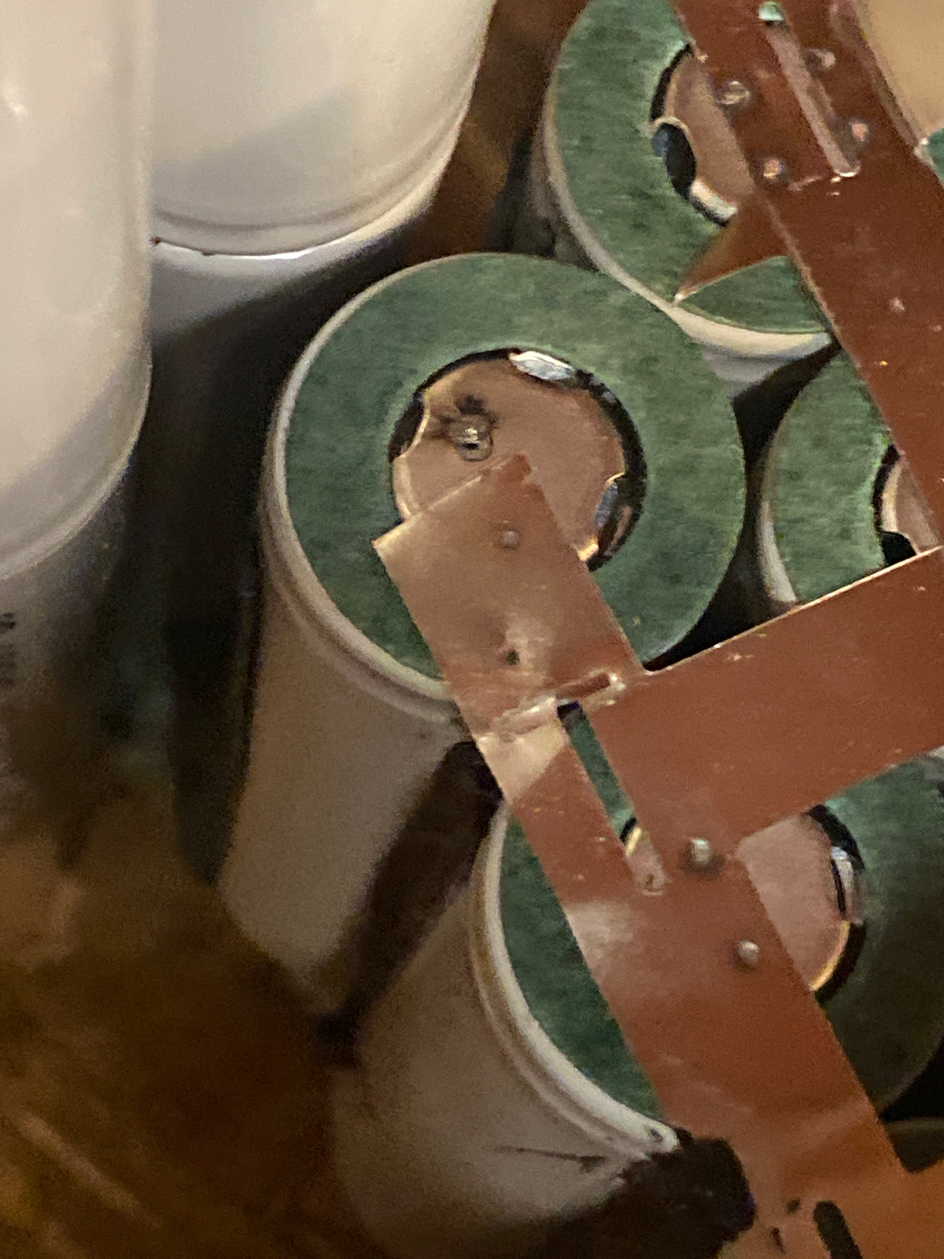

So I’m building this battery… do you guys think I’m doing alright? I got the nickel with the slots for extra hoorah!
Corners aren’t sharp enough. Needs more fire also.
I thought you were going to bed… also I hear you have hot memes for that. :joy:

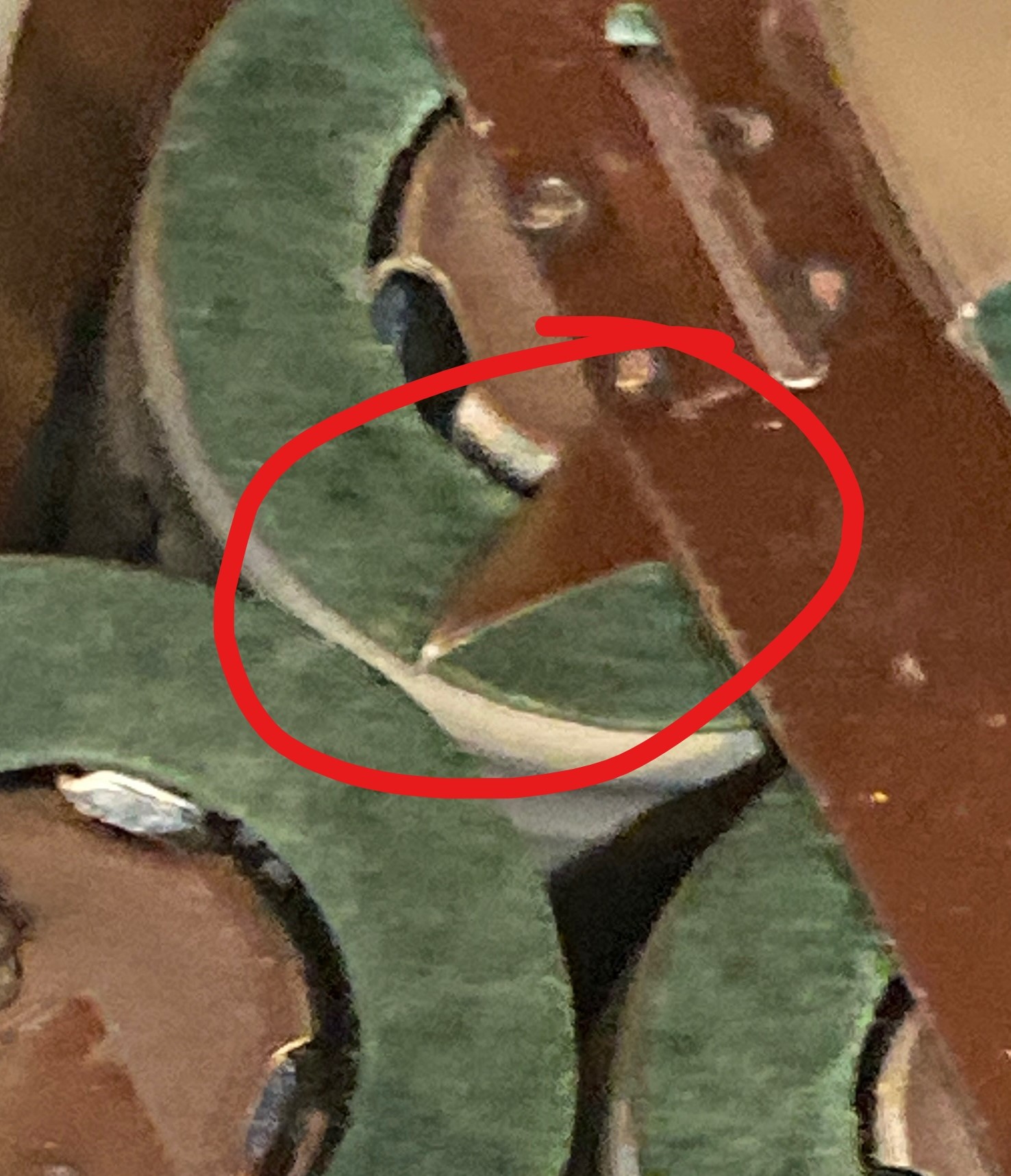

I like this unessecary sharp bit that was added to accelerate the planned obsolescence.
Two spot welds might not be enough. That’s good for like 10 amps right?
I call it the cloak and dagger feature…
That’s assuming they both hold.
