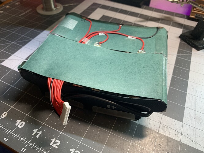

10s3p P42A barely fitting in a BKB duo. The pack is curved and has split p groups… quite annoying to build.
Nice

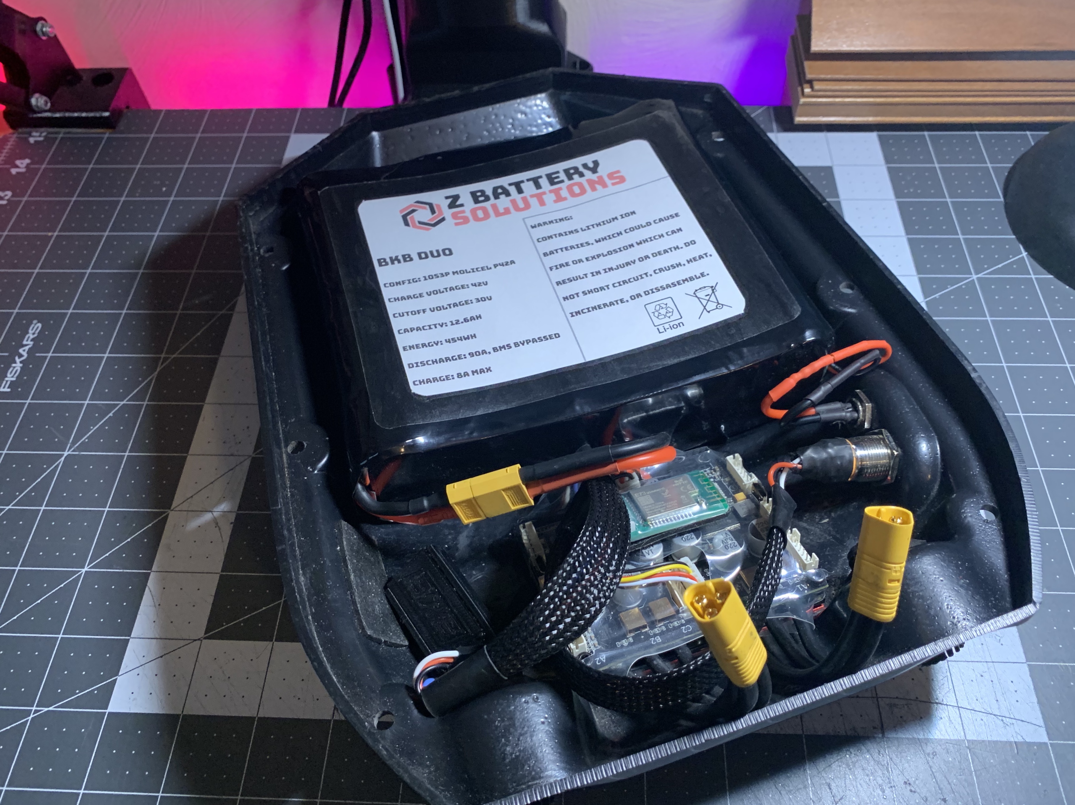

Like seeing the effort that you boys have put in got 3 battery builds coming up 2 will be pretty straight forward, but the 3rd although could be straight forward I’m going to try and squeeze as many WH in to it as possible and the enclosure is smaller than the other 2
I’m on the heavy side 110kg so I’m trying to build a battery that will get me a sweet 45-50 k distance whilst also being a top performer?
I’m a simple man a bit of range and speed is all I ask.
Big facts.
That looks slick though. Nice placement of all the bits.
Damn, nice.

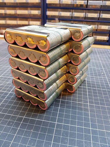

How do you guys glue your 8P groups together? Two 4P groups in a 1x4 then join them on either side? Or some other way? I feel like putting them together in the way I mentioned doesn’t seem very robust, but if you’ve done it, has it held up well?
** I’m asking since I plan on making an 8P pack connected to some PCBs
** in a 4p double stack config
Ah I was going to make a guide for exactly this… easiest way to build 8P groups.
I recorded some clips and took a bunch of pics. Editing it all together is such a pain tho…
Tbh I don’t mind if the method adds more weight or build time, I just want the pack to not vibrate apart lmao.
The answer is getting really good at using RTV/neutral cure silicone effectively or using a shit ton of it.
Don’t skip fiberglass tape, shrink wrapping the entire pack at the end and it should hold up.
If you build a pack like that, even if it is packed loosely into an enclosure and ridden on too high psi tires it will still survive long enough to have a good time.

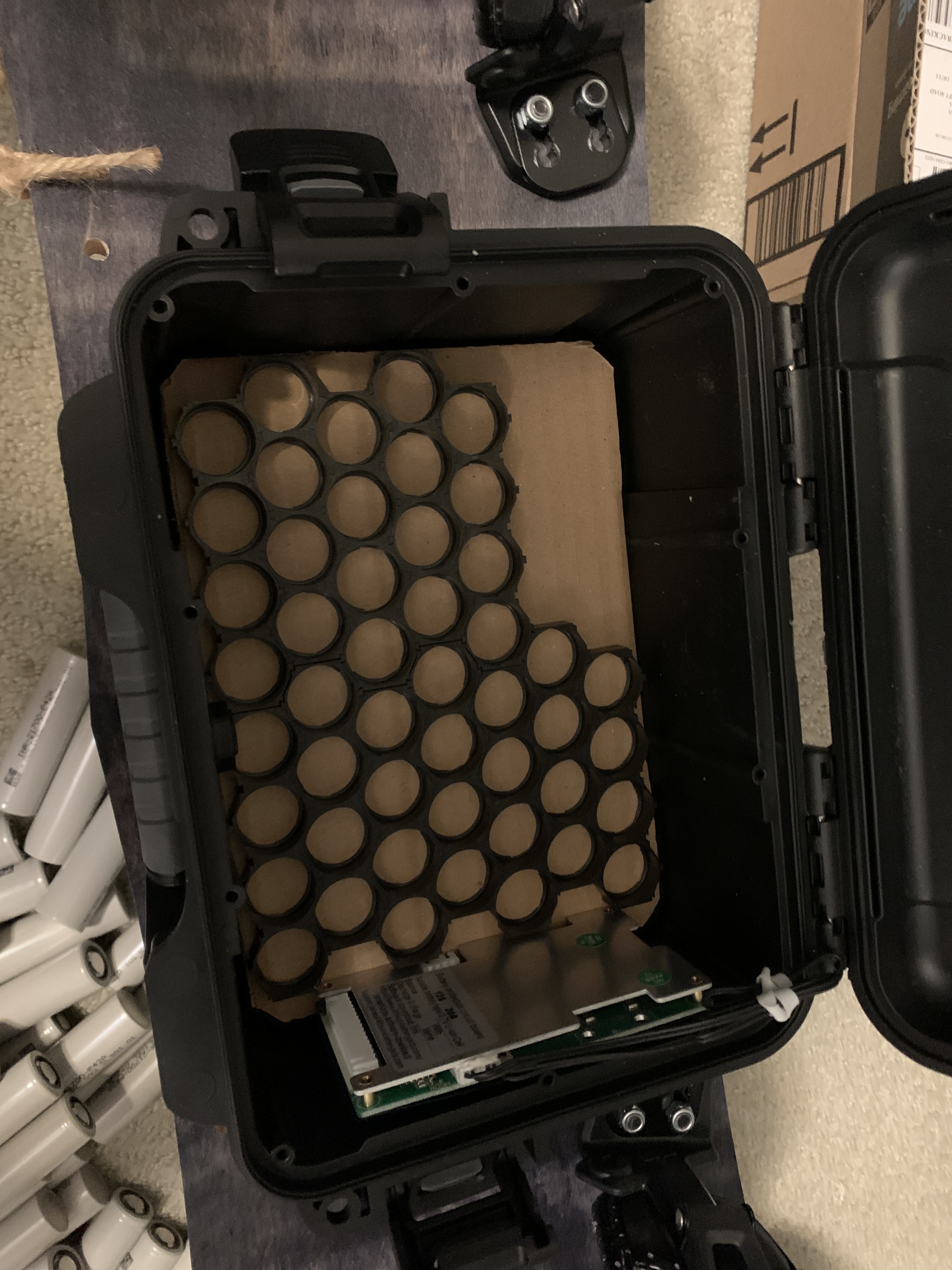

Does anyone know where I can get an XLR panel mount that uses a nut on the back?
Also perfectly sized :ok_hand:
