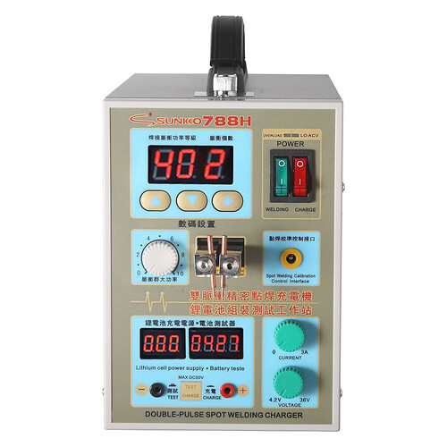

Sunkko 788H…
I got this one on order is it fine?
It’s probably a different one but welded by the same dummy (me).

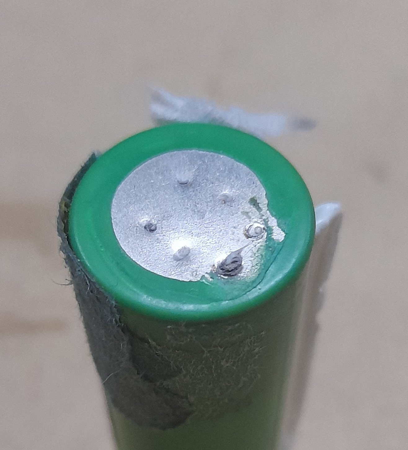

Here is the cell that leaked.
Oozed from the 1st weld at the bottom right

Yes, very bad. I can’t see how that is anything other than the electrolyte liquid from inside the cell. It is flammable organic solvents, additives, and dissolved lithium salt. It is toxic and should not be touched.
That cell is useless now.
Because you were lucky. Do not touch the liquid with bare hands and certainly do not weld anywhere near it. It is flammable and toxic. Thoroughly clean anything the liquid might have touched.
Carefully wrap that cell and recycle it.
Your sad trolling aside the liquid is dangerous, both flammable and poisonous.
