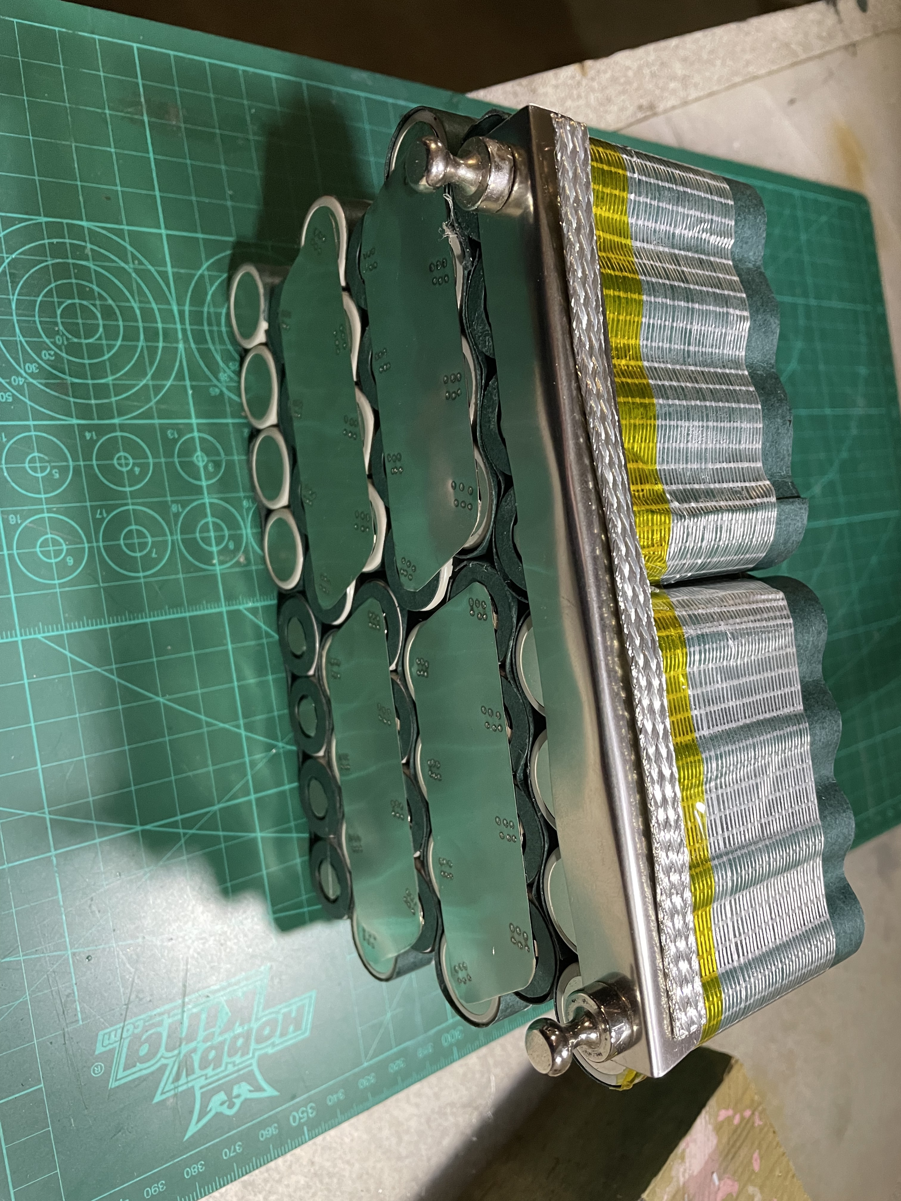

Sup Peeps,
Need some advice on connecting two P groups. The nickel strip Im using is 2mm, I ok to use the braided wire on the back like in the picture. I want to avoid saldering it on top of the cells after they’re spot welder.
Is that braid for current collection on the most negative group? (Edit: I can see its not on 1 group, but the point I made still applies)
It’ll work well, but you can actually solder before you weld, so 0 heat will go to the cells. Its also WAY easier because the nickel sheet has basically no thermal mass so the solder will flow much more easily.
In saying that, i usually just use a couple 16AWG wires to collect current. Only needs a few solder points, and does the job. The nickel you have there can already do about 80 amps or so, so you’d only need 4 16awg bridges to make it to 200A output.
Yep the braided wire is for current collection on that specific P group only. The others are all front to back although for one its side by side. I wasn’t sure if there would be heat build up between the first cells if it were configured this way.
Thanks for help!
The length of the “cable” (the nickel and braid in this case) is not long enough to have a real difference in resistance between the path from the further cells and the closer cells. If you have a 200A capable connection and then only run 50A, it’ll be fine (Most batteries run well below 50A 99% of the time, and only burst higher for such short times it won’t ever heat the nickel)

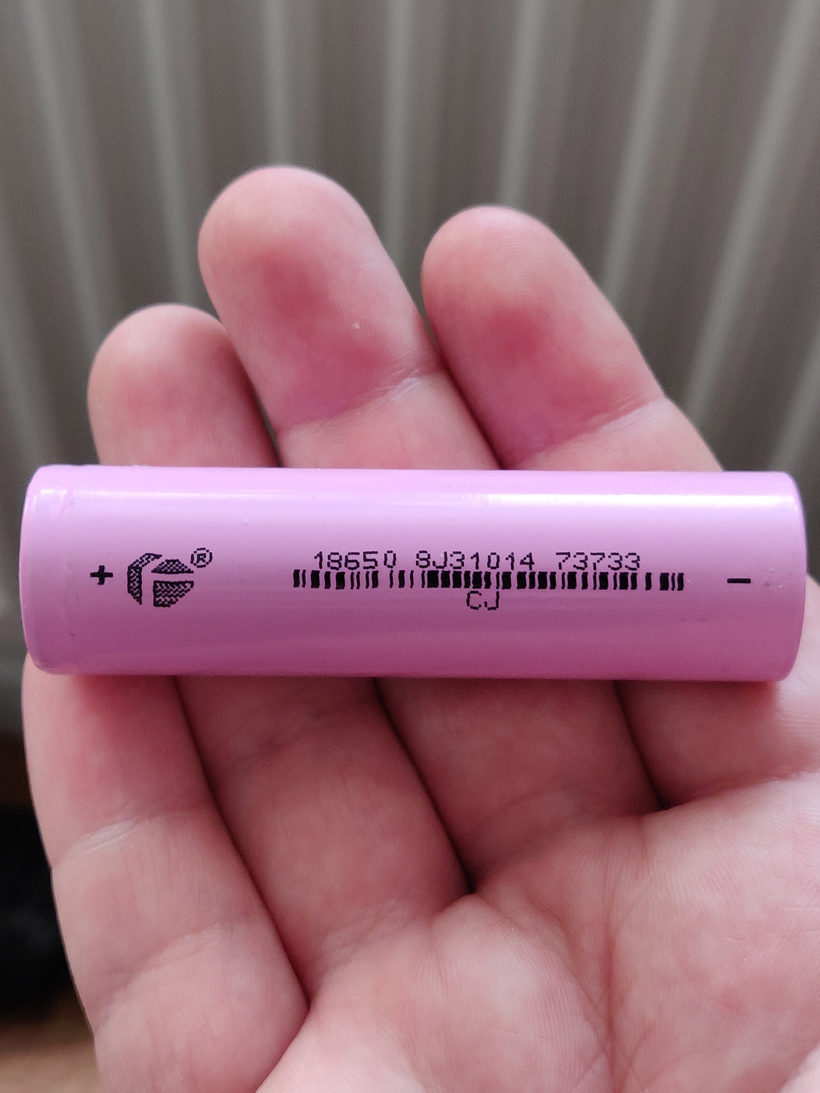

Why did they catch fire?
I’m somewhat having a hard time identifying these cells and what they can output.
*They are from a powerbank which is a few years old already.
