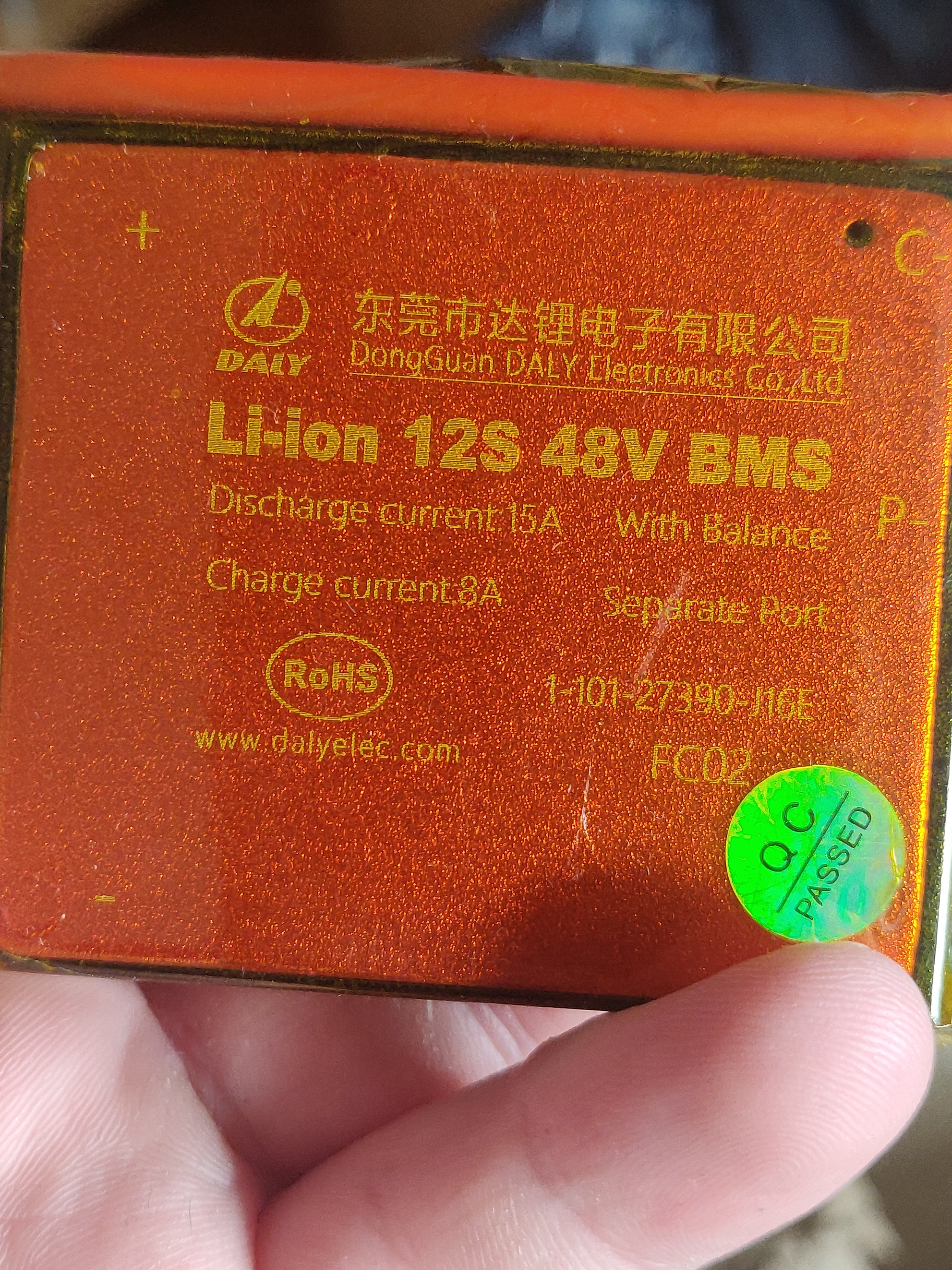

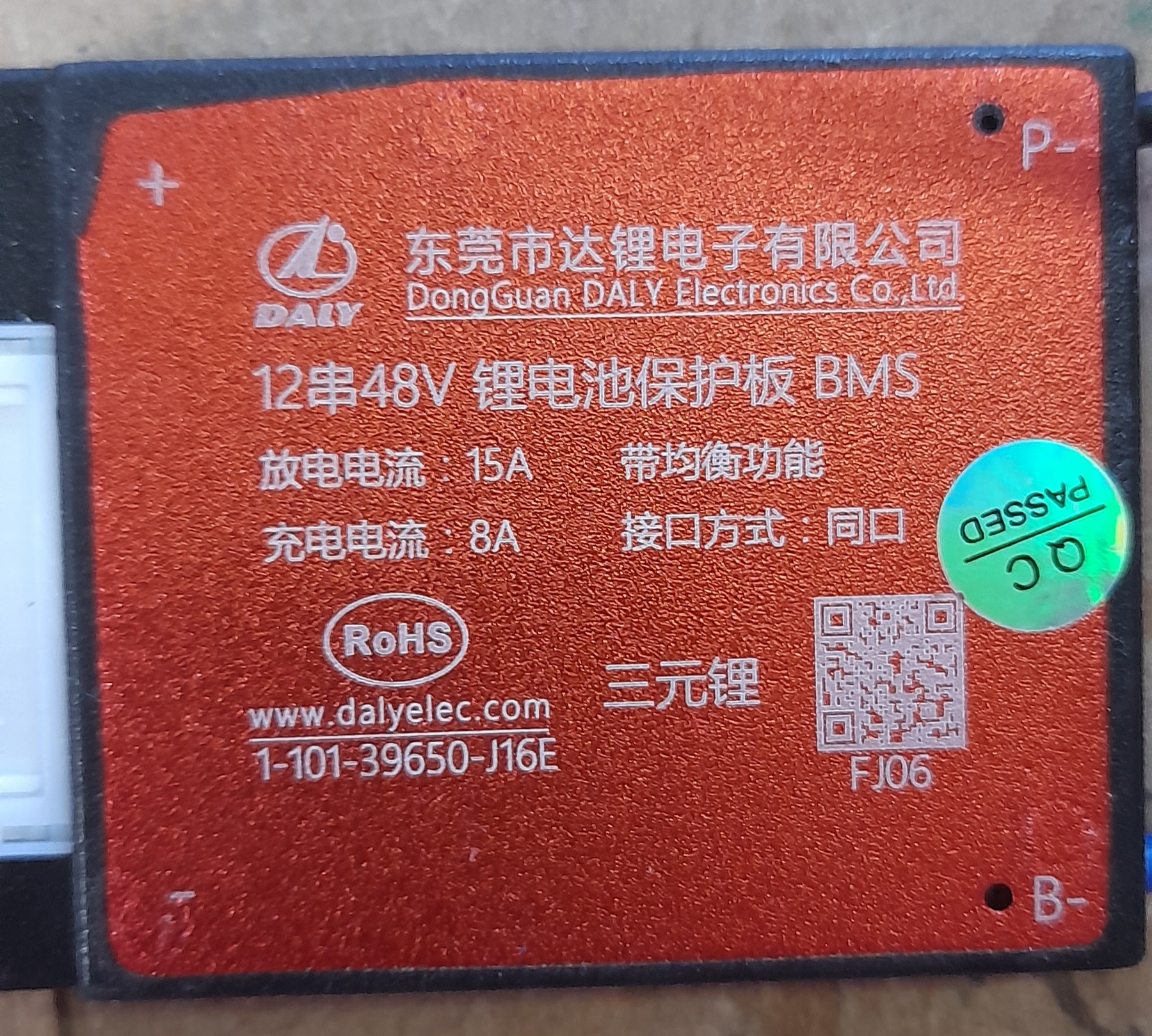

Hmm… I went to charge my completed battery after a very short first ride and it charged for about half an hour or more then my charger lit the green light and stopped charging. I checked the board and it’s not at 50.4 volts but 45.2 volts (12s). The charger reads 50.4 so could the BMS be cutting charge off? it’s a 48v Daly with up to 8a charge and I’m charging at 6. I have a 2a 50.4 colt charger I could solder my plug onto and try out?
For now I’ll leave it sitting on the big charger and check the voltage later but the fans not spinning so I don’t think it’s charging.
I know it charged since I built it with cells at 3.51 - 3.53 volts each. all but 8 or so were 3.51. 45 / 12 shows each p group at almost 3.8 but I have not checked them individually since I built it.

Far as I know, the 12s Daly BMS units are marked as a 44.4v nominal BMS.
You sure you have the right BMS for the pack?

Well first what charger? Green light very rainy means fully charged. Normally the current has dropped below a threash hold that’s set by a China man and his guess of a voltage.
It could be your bms stoping the charge as the cells are drifting and it needs time to drain 1 cell from over volting befor it continues to charge.

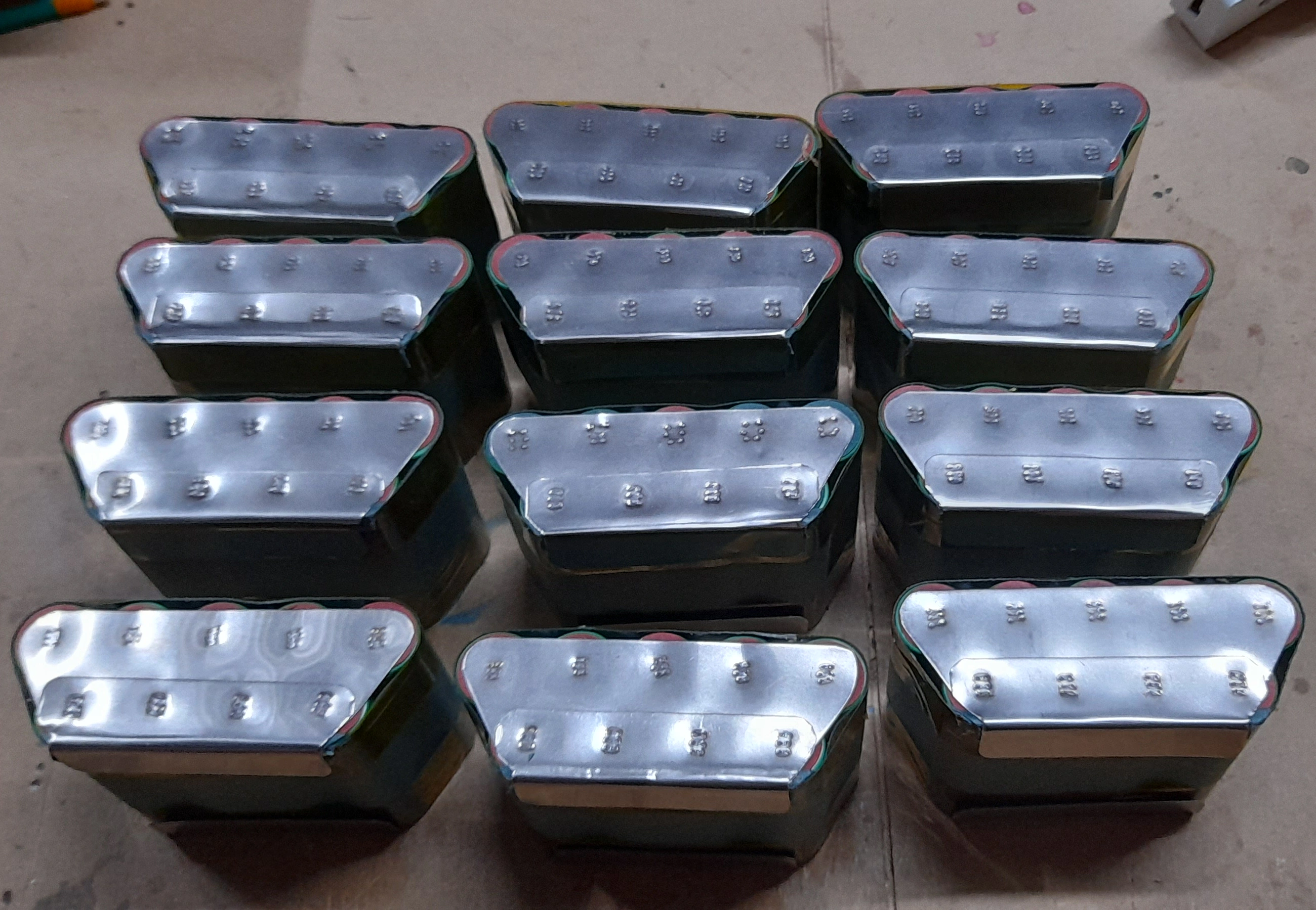

bought a heat gun and did some huge pieces of shrink wrap and still same issue
it refused to wrap around the pack
it just would either curl up on top or be to short
no idea why it wont be normal
How far out to the ends did you start? You basically want to shrink the ends down so far that they won’t fit over the pack, then work your way inwards until everything is snug.
If that doesn’t work, you may need a smaller shrink tube. You don’t want it to be all that much bigger than the pack itself - maybe up to 20-25%, but not more than that.
How fast are you heating it up? in my experience its better to do it verrrrry slowly and evenly the bigger the pieces are.

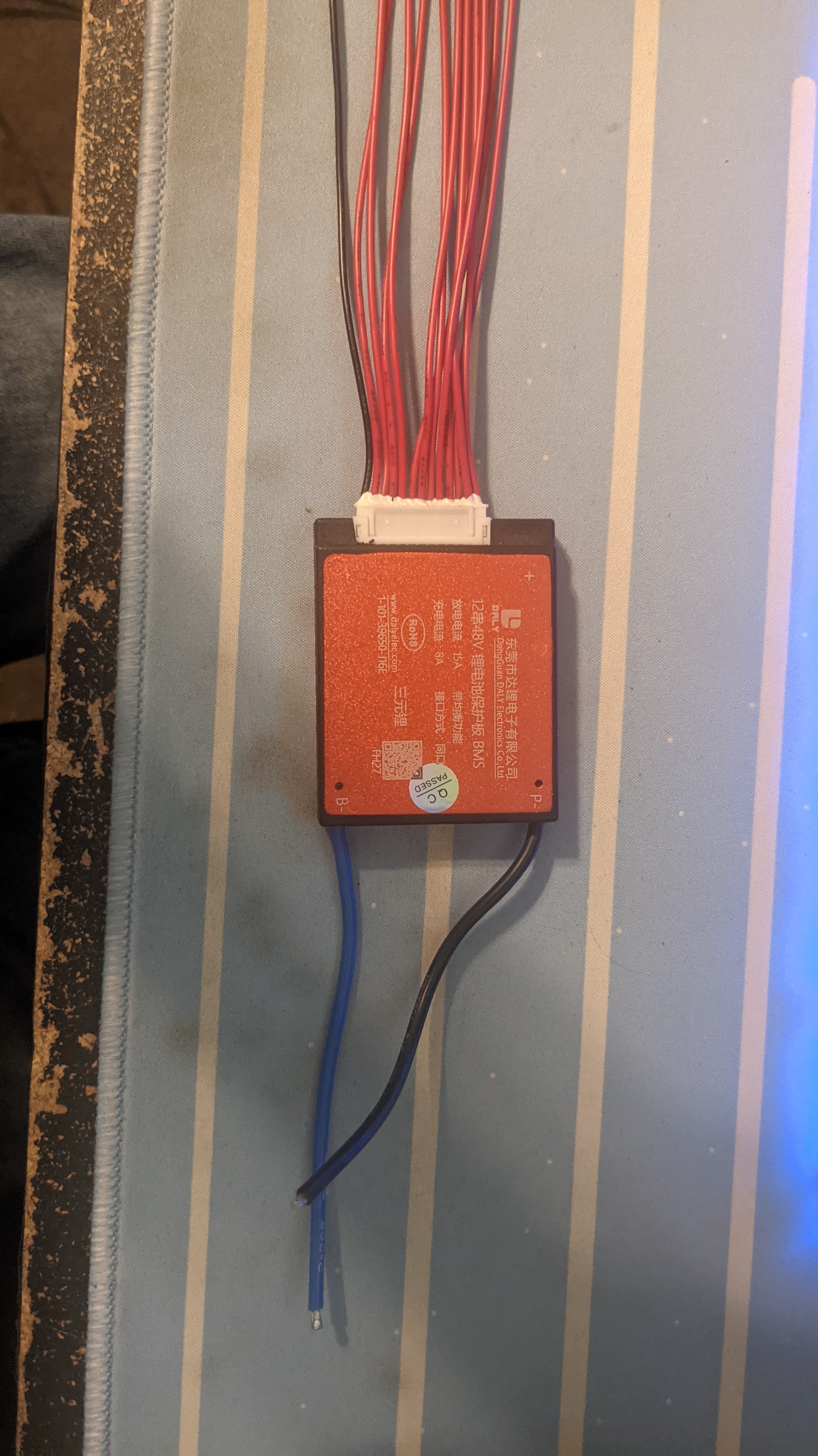

Someone gave it to me and I wanted to check with you guys if it was a 12s for sure.
I got the p groups done and have to wire the BMS, can I use that one and later on swap for a smart one? Or will there be issues with balancing cables order?

bought a heat gun with 2 settings
it shrinks it very fast
used to use a hair dryer which was slow
had issues with both
280mm wide was a squeeze usings 300mm now
i managed to get it working on a couple of the groups but its super messy and tons of bits at the end left
gonna keep going and learn to get it right
13 pin = 12S, daly always puts 48V on them.
The daly smart and daly bypass bms use the same JST. The LTT BMS uses a different one.
You will probably have to trim the ends to look nice, after you’ve shrunk everything.
Also, since your packs are so wide and short, they’re probably always gonna be a little ugly. You could run a second layer of shrink in the other direction (or a layer of other plastic) just for cosmetic purposes.
be careful, Daly sell a lot of liFePO4 BMS
