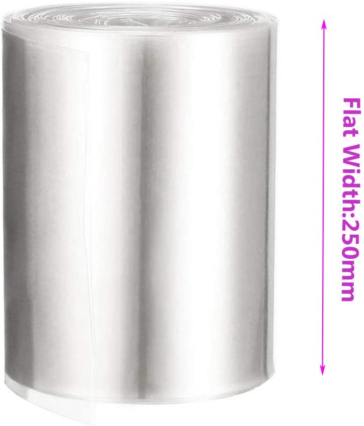

The clear stuff that @Skyart linked me on amazon the other day was pretty great to use, no idea if it would work for your setup though. It’s probably at least 2-3 times as thick as that stuff

you couldnt by any chance link the heat shrink you got?

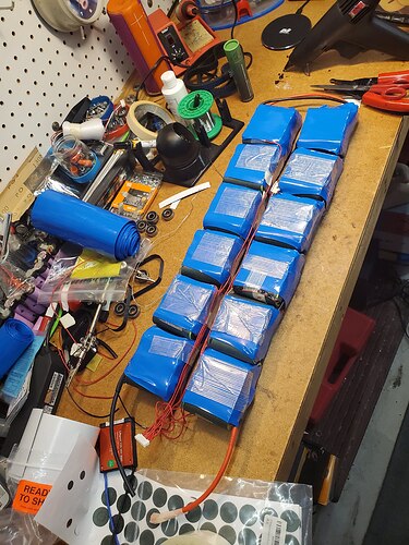

Uploading: 20201105_213326.jpg…
Here’s a partly completed pack that I made last year with the blue stuff on it
It didn’t upload properly from my phone bc of poor reception right now
I bought this stuff:

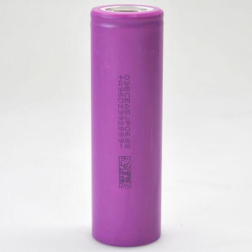

What’s up with these cells? Not the worse price but have they been tested with esk8? What’s kind of cap is on the negative and can we still weld on to it?

That is a secondary venting disk on the bottom and in my opinion this cell, and any others with bottom venting, should never be spot-welded with anything that can interfere with the operation of the disk. You could also pierce the cell if you welded on the (pre-weakened) line and welding down the venting disk means the cell could burst instead of venting if something happened to increase the internal pressure (internal defect, short-circuit, over-charging, over-discharging, etc.) and the top vent was not sufficient or blocked internally.
This bottom venting is added because sometimes just having a top vent is not enough to prevent bursting.
Got it to upload
ah nice
a lot better then mine

this?
It still doesn’t look great though I prefer the clear stuff now
My pack clean up skills have gotten much better too. The one in the video on Friday is quite nice
That being said this pack pictured here is still going perfectly fine, it’s a 12s6p 26650 pack, pretty large lol
