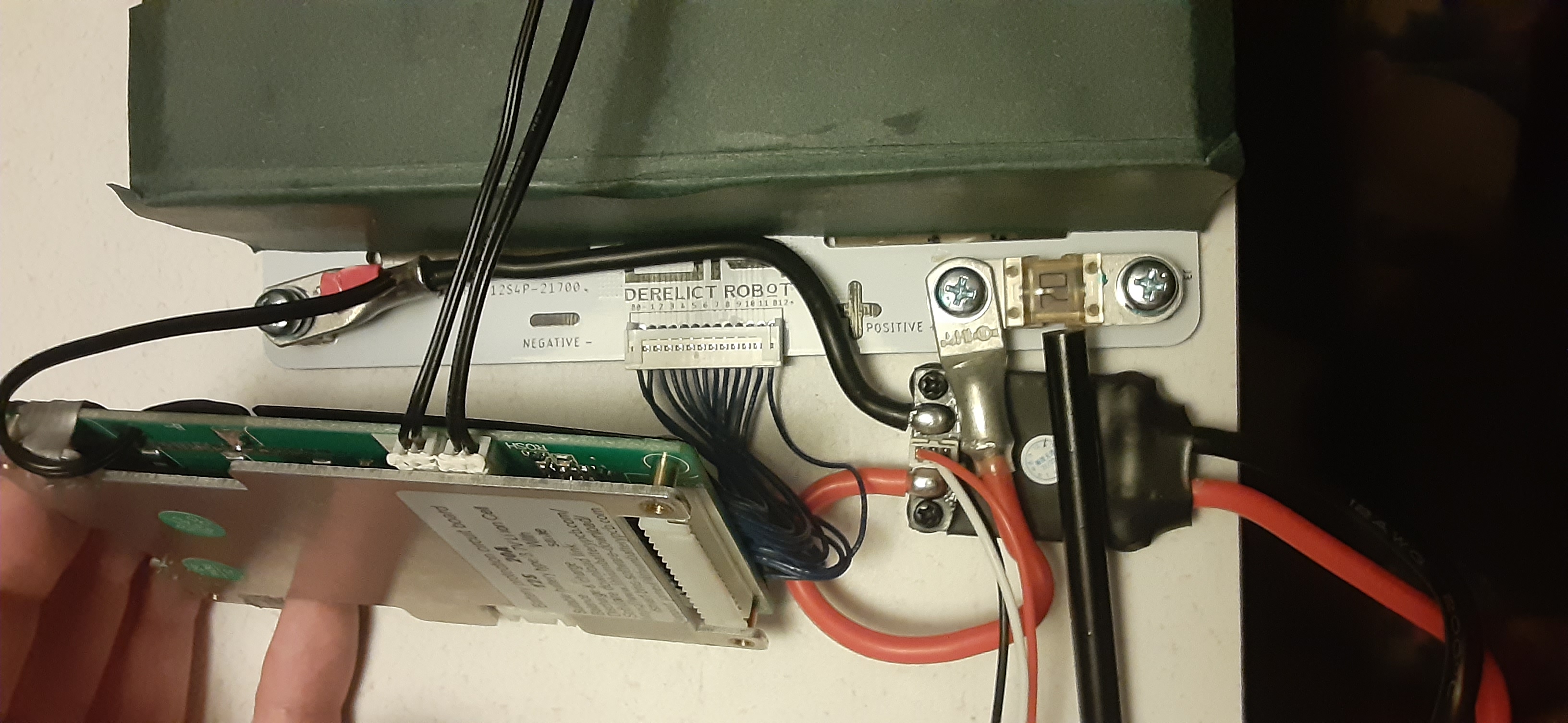

I urge you to redo those connections. IMO that is not a safe setup.
Unsolder the wires, soak up the excess solder with solder-wick (or something equivalent), clean the burnt flux off with alcohol, get new wires (or clip the ends of what you have), twist the strands of each wire together and then carefully tin each wire end with solder (use lots of flux if needed), place a bit of solder on each solder pad, and then quickly and carefully solder each wire to its correct pad.

nope can’t. I fucked up even trying to use the telfon this way. No thinking moment there.
that stuff does not come off with alcohol idek what is needed. Anyone here use flux remover?

you have any reasoning for this comment besides the poor soldering of the teflon wires?
which is only my fault for trying, there was no way I could have soldered them well. I was just slightly inexperienced with them. I would have used a 16 pin JST connector if I had one, well I guess that is where I really fucked up then.
I tried to post that to warn others about using teflon wires in any situation besides crimping or butt joints, so to have you reply saying to not use that wiring job and telling me how to solder it better seems to be missing the point what I wanted out of the post. hope you got that, sorry you typed all that out.
The proper way to do this because I have not explicitly said is to butt joint the teflon wires to silicone ribbon then solder that to the BMS. Silly me did not do that for… no reason :upside_down_face: ooops learned and try to teach you all.

I’ve only ever needed to use isopropyl rubbing alcohol. 91 or 99%, soaked in a cotton swab, or if that’s not aggressive enough, a toothbrush.
Most commercial “flux cleaners” you’ll find online are just isopropanol in a can with some CO2 as a propellant.
I was trying 91 and not having luck… I will try 99 but I think the dry spots need scraped off.

There are connections too close to each other and loose strands…this is bad.
Of course you could have soldered them well. The insulation material has no effect on the wires being soldered. Only the condition of the wires, the solder you use, and your technique affects that.
If that wire is too badly oxidized, your flux isn’t active enough or you don’t have enough, you burn the flux too quickly, or some other issue affects the soldering then the job will not turn out well. The Teflon is innocent. :slightly_smiling_face:

IPA works just fine…be patient. You burnt the heck out of that flux so it takes longer to come off. I’ve used 70% and 99%, both work.
So you didn’t inspect your solder joints as you did them and didn’t take a last look to make sure you didn’t have any shorted wires before you covered them? Was that part of the lesson? :grin:

guess you aren’t thinking about every detail of the sequence of events, the wires all looked ok but once I put the plastic down and bent them around positioning the BMS (this was a mock-up) then the loose strands shifted and I saw/smelled the wires being shorted. I did attempt to tin the teflon wires properly but my shitty blowtorch and tweezer stripping method made that not work as you see. if I was going for more than a mock up I sure hope I would have never tried this or done a perfect job there.

Just so you’re aware, you’re actually bypassing the fuse right now. Your red wire should be connected here*:
*assuming that you actually want to be running fused discharge. I am aware that there are pros and cons to doing so, and some might wish to run without a fuse.

So can someone show us in a short video clip or pictures how you strip and tin teflon wire? As mentioned I used a blowtorch which might have oxidized and or the bad stripping coated some strands in melted teflon.
