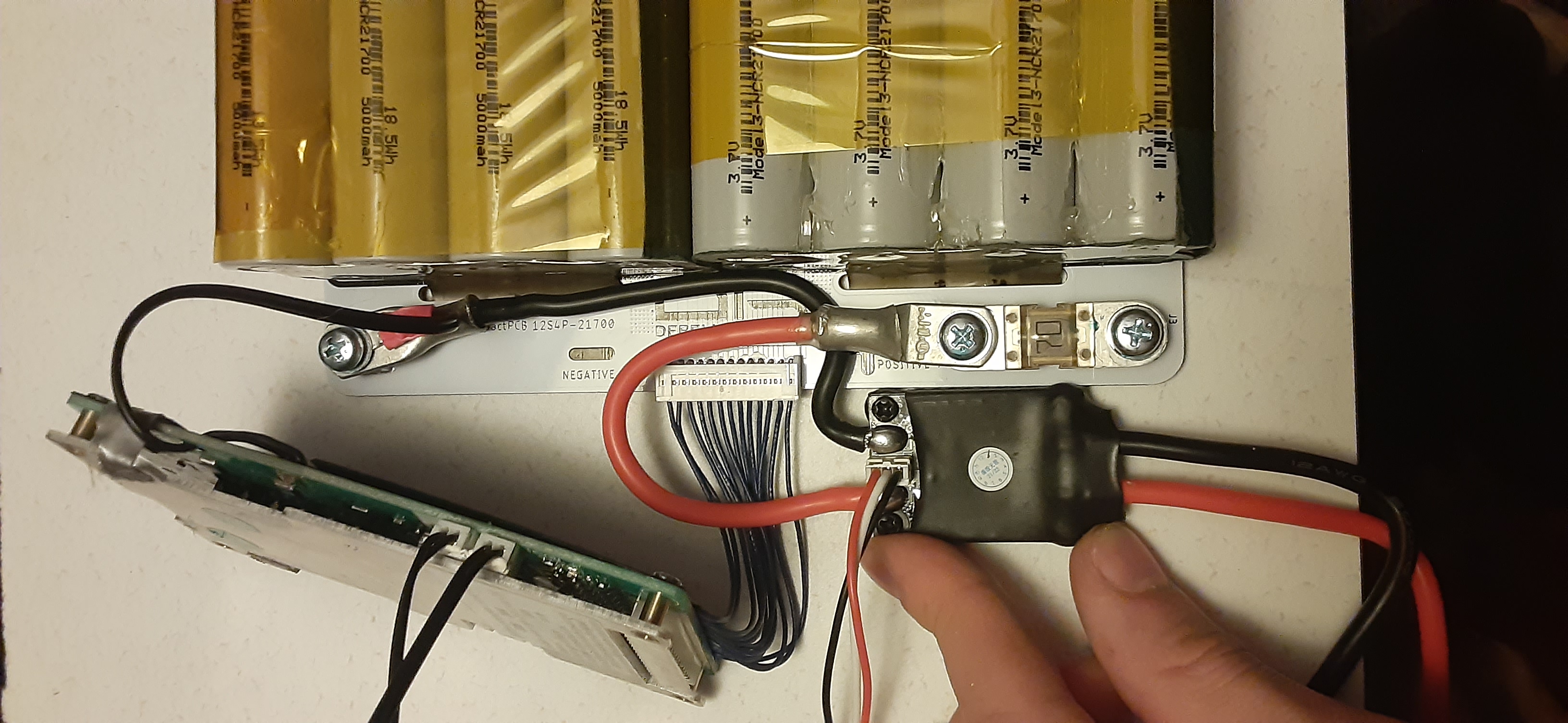

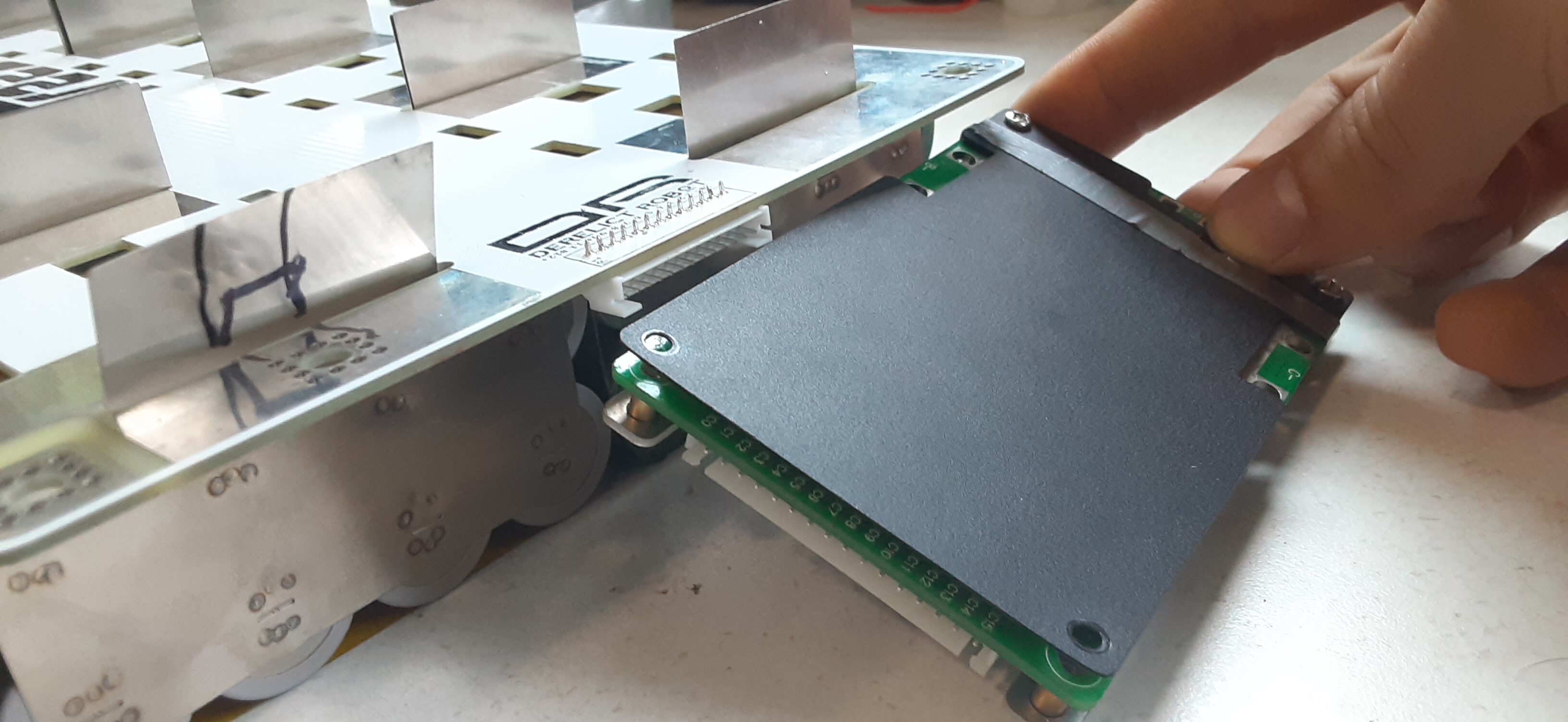

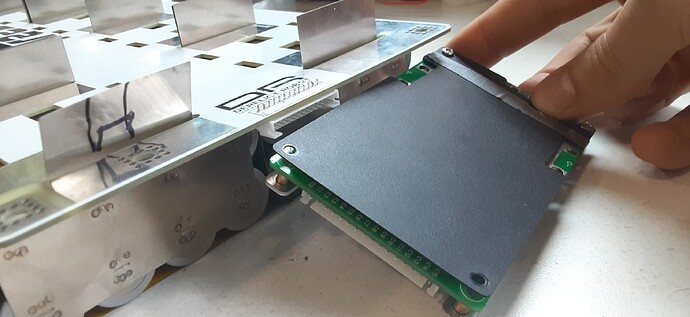

I was just trying to figure out where you could tuck it into a 12S8P 2170… yeah I wish it was skinnier and a bit longer would be good I guess.

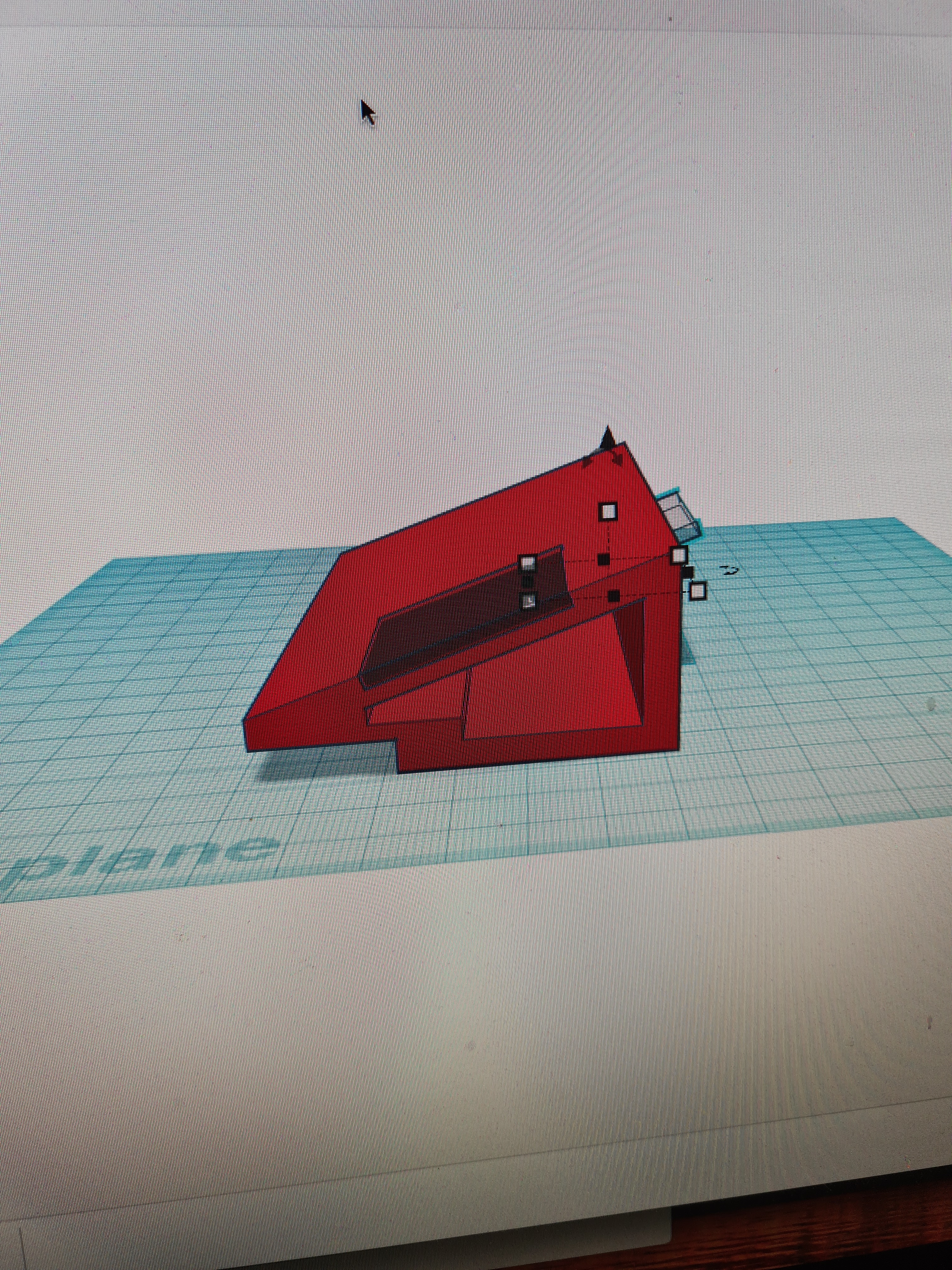

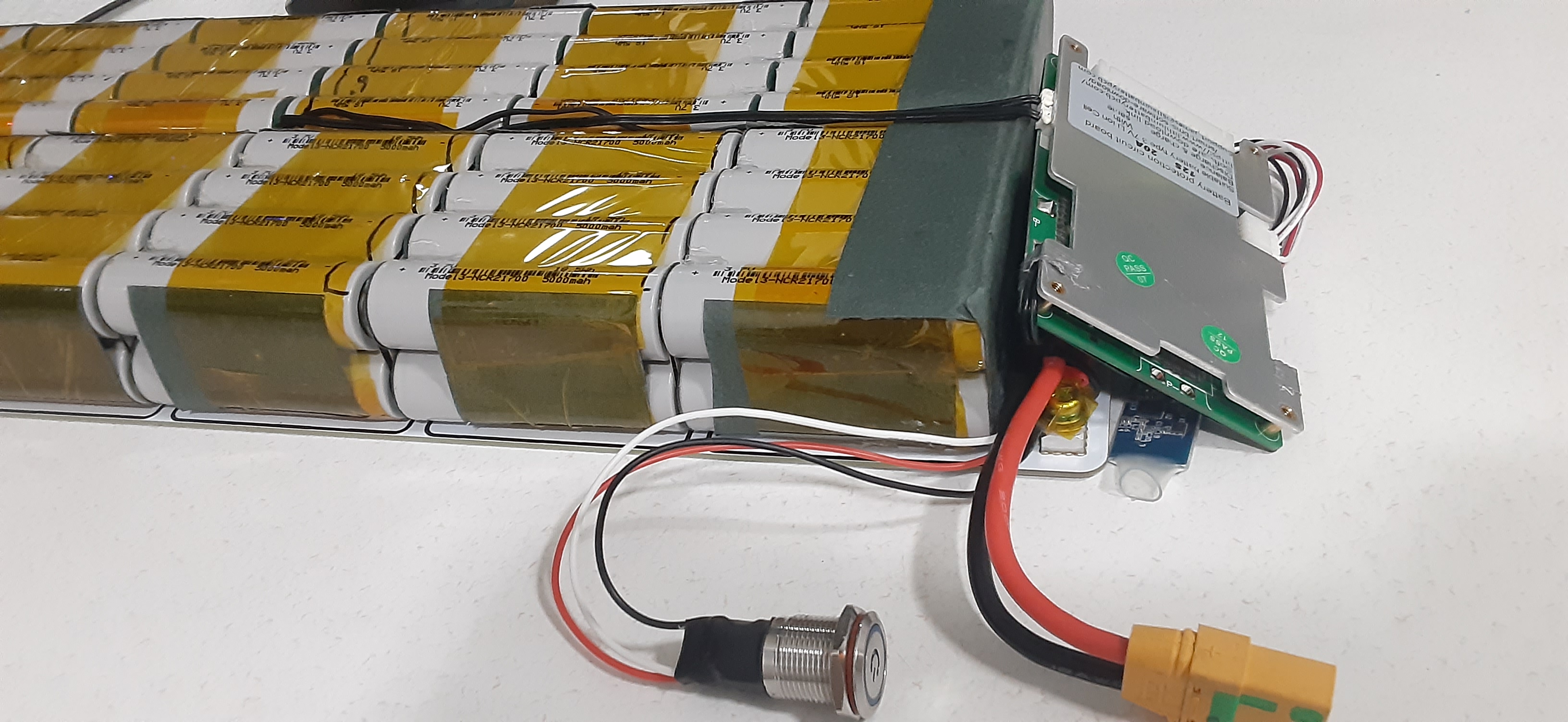

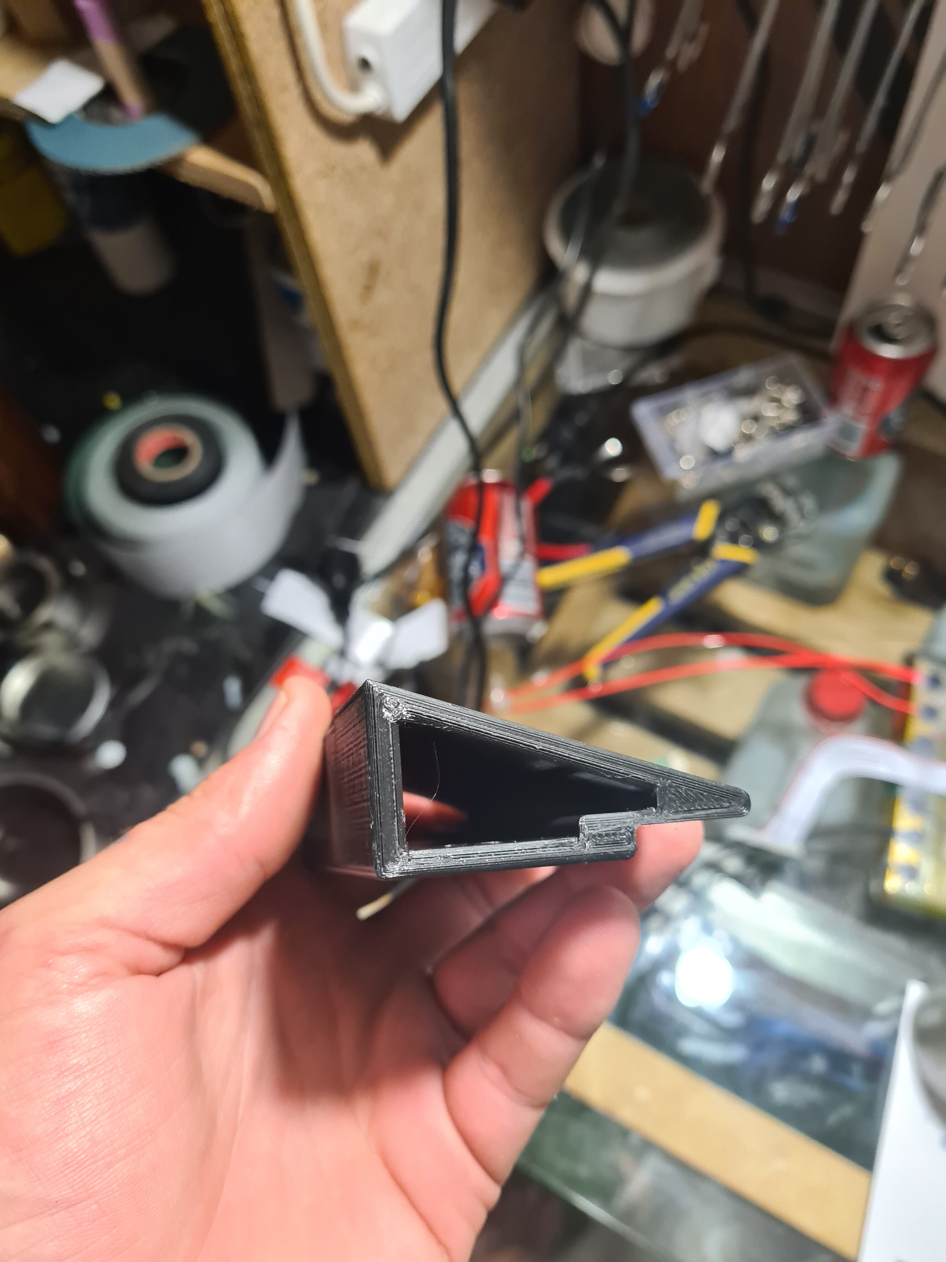

@glyphiks have you made any new versions of the triangle BMS holder?
That was the latest version of the triangle, to suit a Kaly DS and sit over the infinity sink.

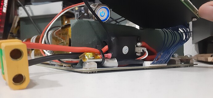

Also came up with this solution for another config

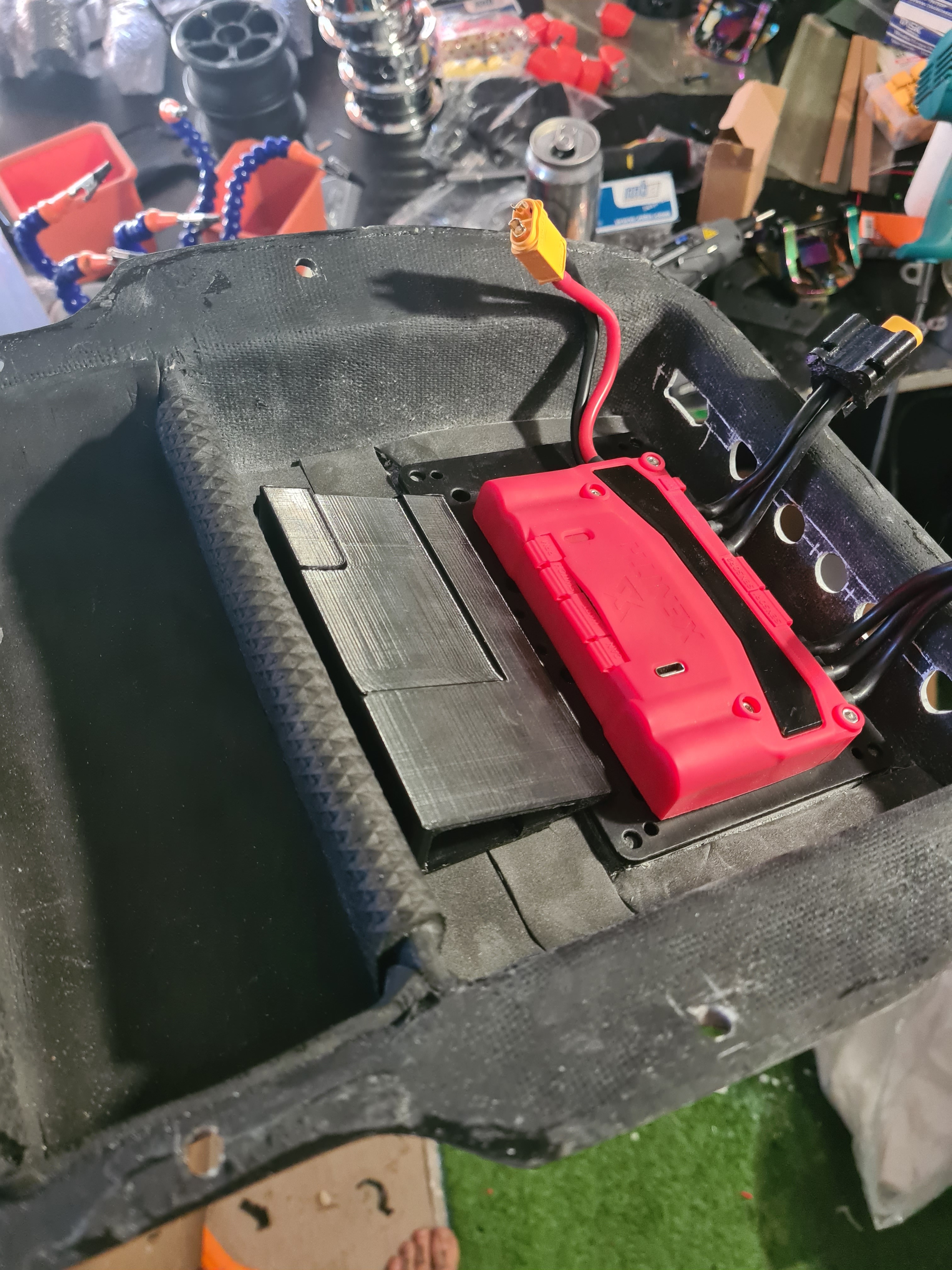

Working on a stormcore/18s version, and also alternatives to have the ESC below so that it can be mounted to a heatsink and bms on top.

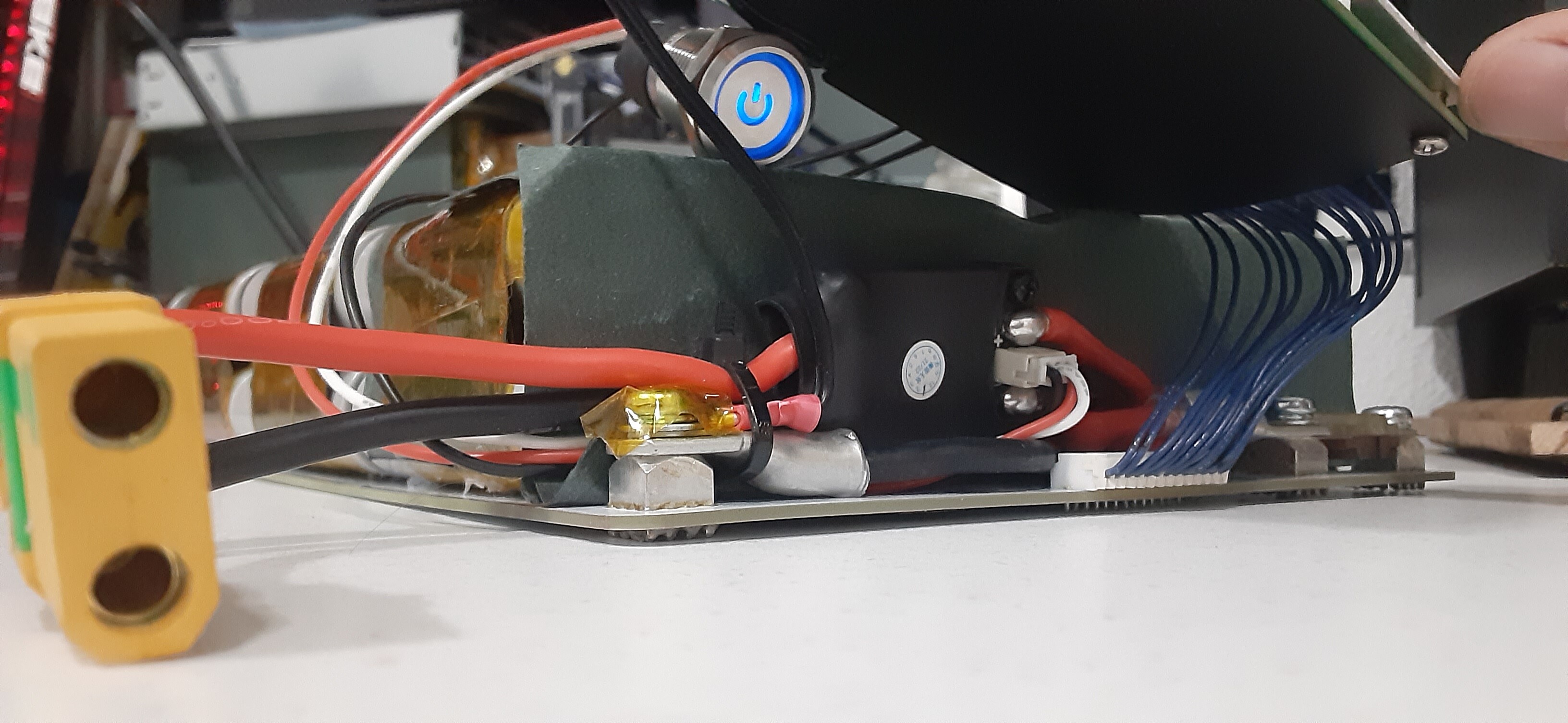

I was thinking about tucking it under the edge here. The BMS metal could short the battery tabs but FP and the printed holder will prevent.
I guess there is plenty of space in the tb40 but I like the BMS integrated, yet removable.

I already made a simular Stormcore version if you need?
bms lid stormcore mod v1 .3mf (95.1 KB)
bms base stormcore mod v1.3mf (101.6 KB)

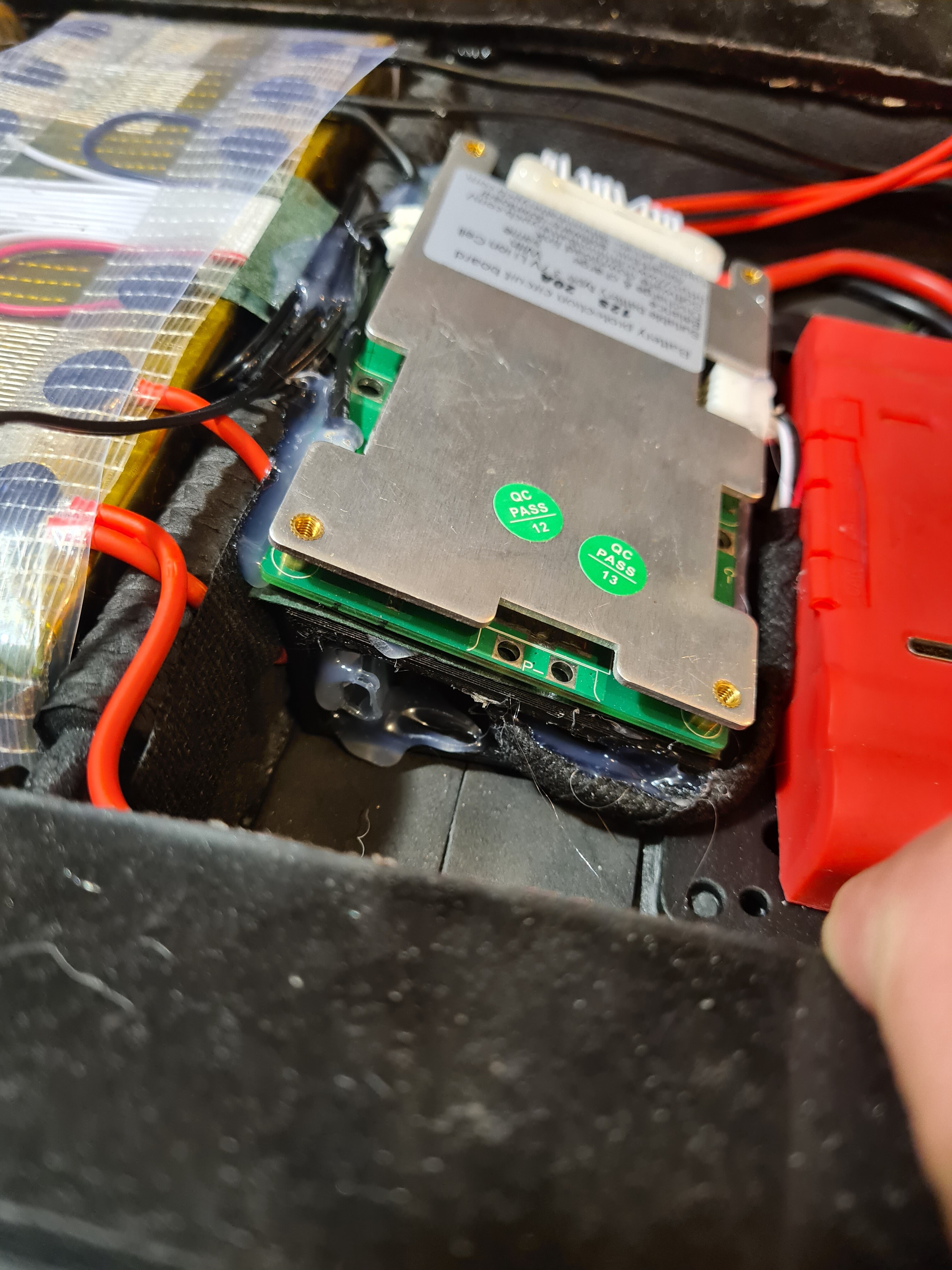

Typical Psychotiller craftsmanship. 🤦🏻
Is that electrical tape or butyl?
Melted electrical tape. Guess that spot was getting hot

@Battery_Mooch looks nice eh? see next I wish there was some mounting holes for printed parts I almost want to drill some, I am gonna stick with tape for now.
What I actually meant to ask you with this tag is do you think there could be a common bolt pattern for BMS/switch to these PCB battery things or can adapters always be handled with printed parts?
I am actually liking option C here

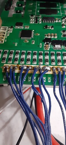

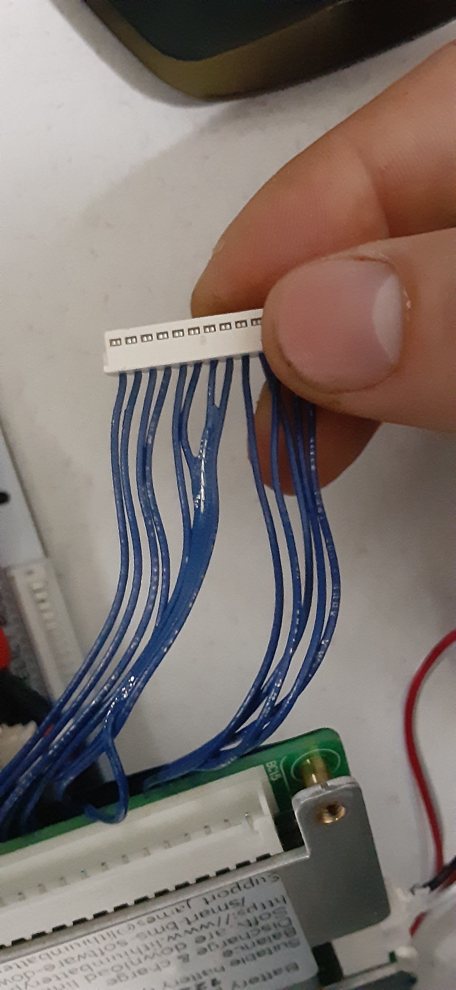

I thought I had stripped good but I failed in the tinning step, or putting glue. Oh well, watch your fresh wiring folks!!!
and yeah. only butt joints with teflon
