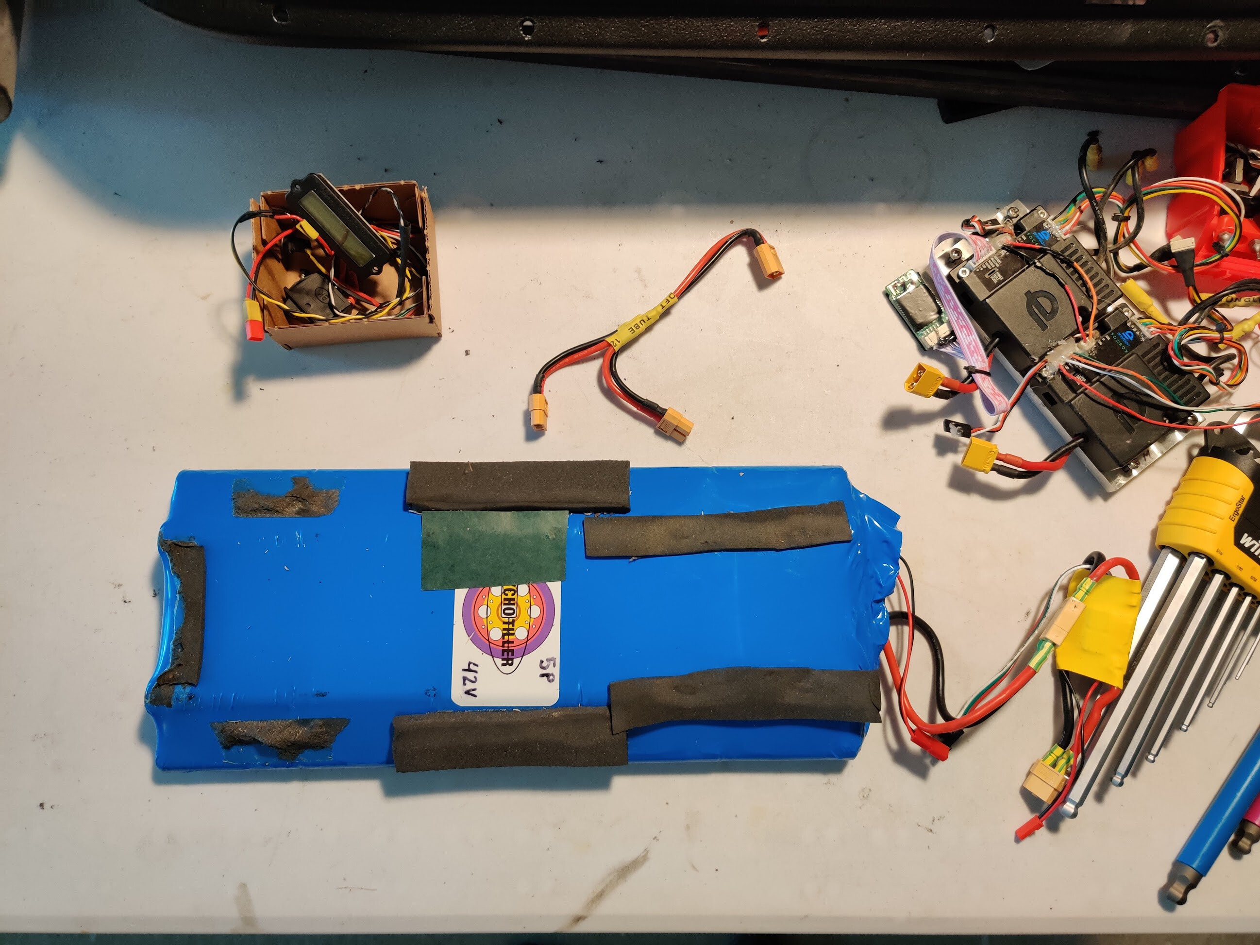

I have decided to go down this road. I’ve opened the tiller pack on my build from 2018. Since I’m refurbing the rest of the board (which now my wife rides) there was no way to avoid it.
To be fair, the pack charges to 100% and hasn’t given me really any problems, besides the massive sag- we’ll get to that.

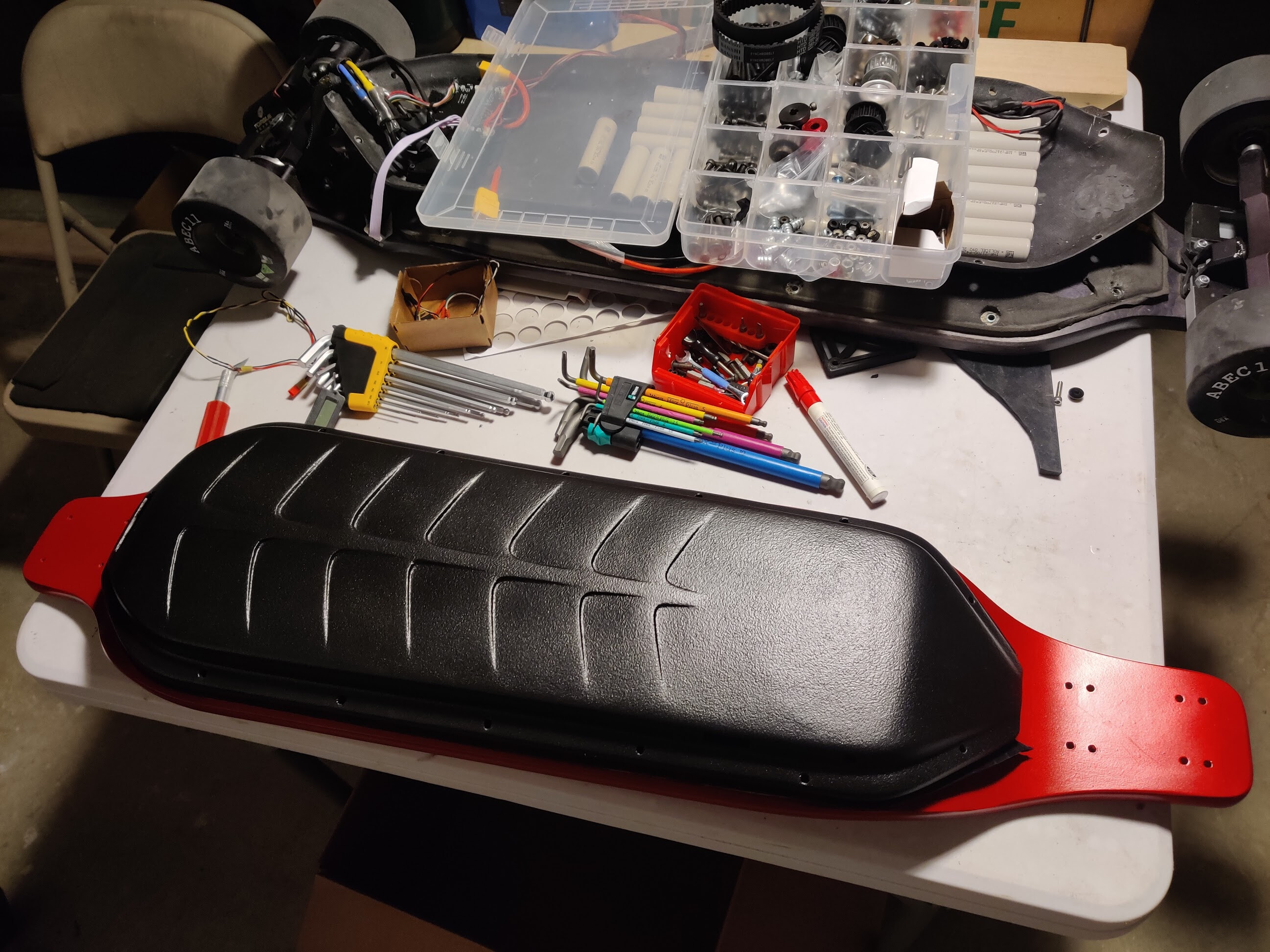

The refurbed board

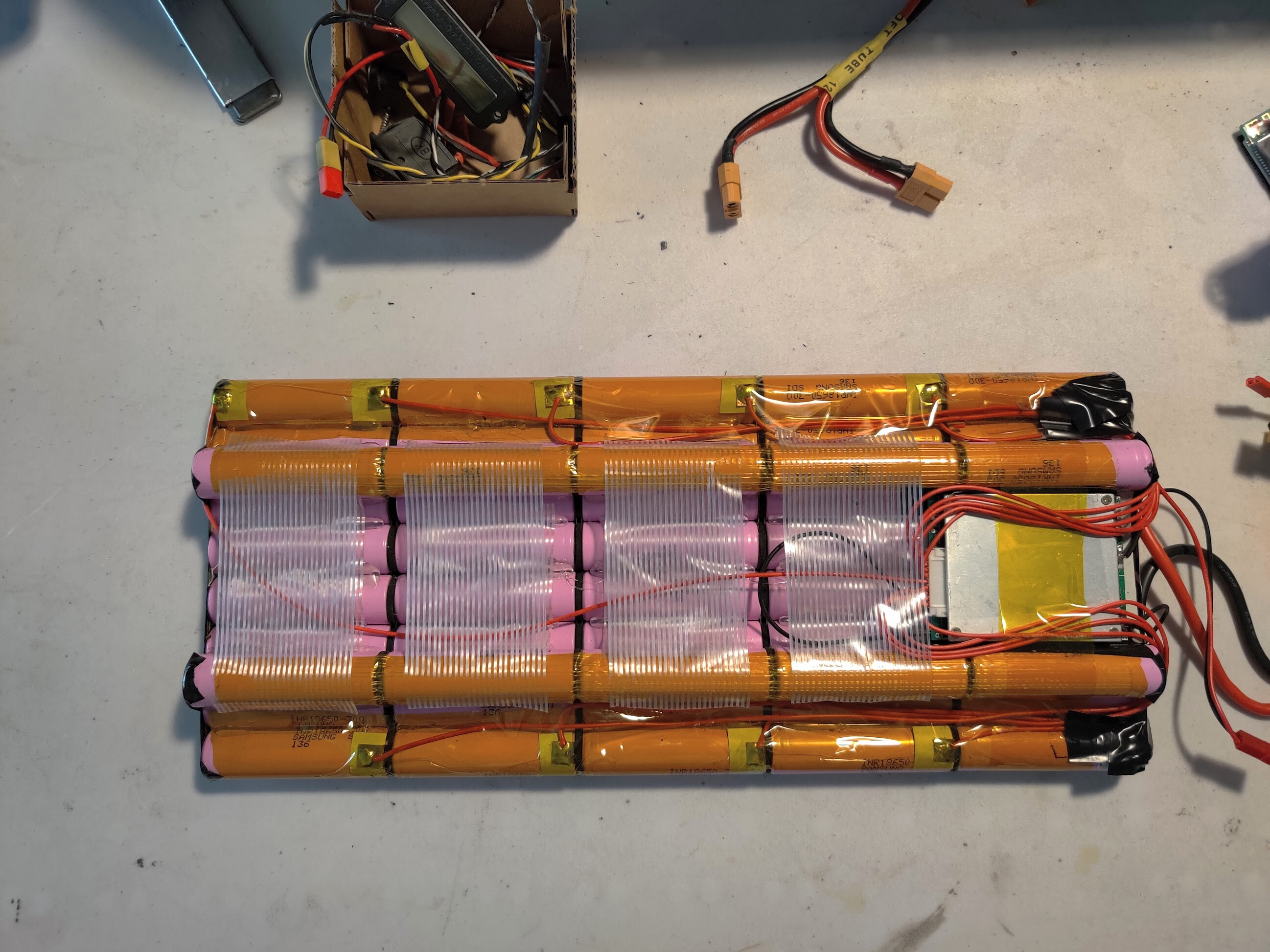

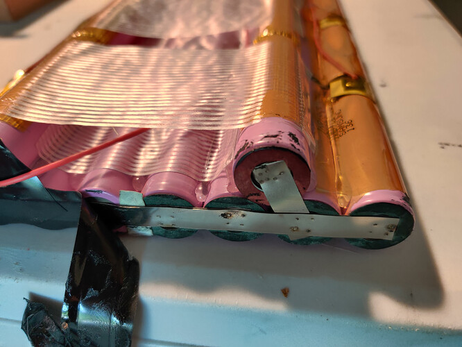

the guts
The battery
