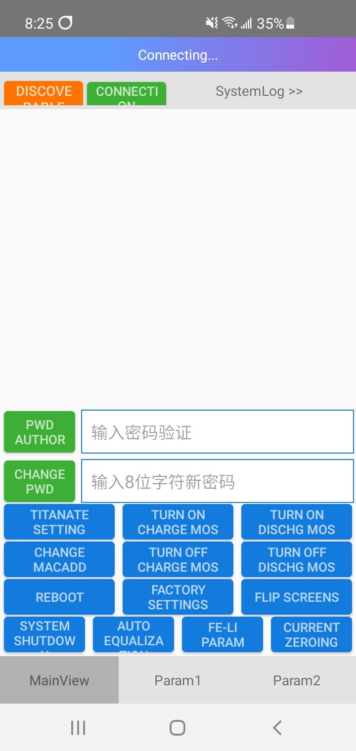

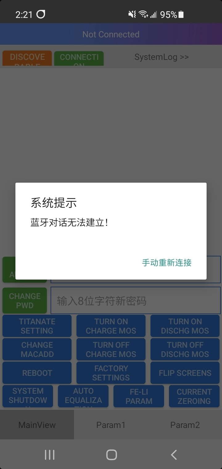

I have an ANT 7-16S BMS. When I plug it in and start it, I then pair with my phone and then connect to it and open the mayi app. Everything is good all functions of the app work. I close the app, comeback later and try to reconnect with my phone and I cannot connect. Anyone have this BMS, whats wrong? Anyone know what this means? When I restart the BMS and re-pair it works again
Also I don’t understand how the pwd author and change pwd work exactly.
I have an ANT 20-24S, I don’t know if they’re similar or not.
What I do know is, that the apps they give you are garbage, and you should use the VBMS app. It’s a few bucks on the play store, but totally worth it.
Don’t know if it will work with your BMS though, unfortunately.
I think it’s the same. They at least have the same product page on Aliex. Thank you I will look into that. @xsynatic you don’t have an APK for it do you? :pray:

VBMS.ver.V2.1.7.2.build.42.apks (2.8 MB)
