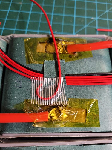

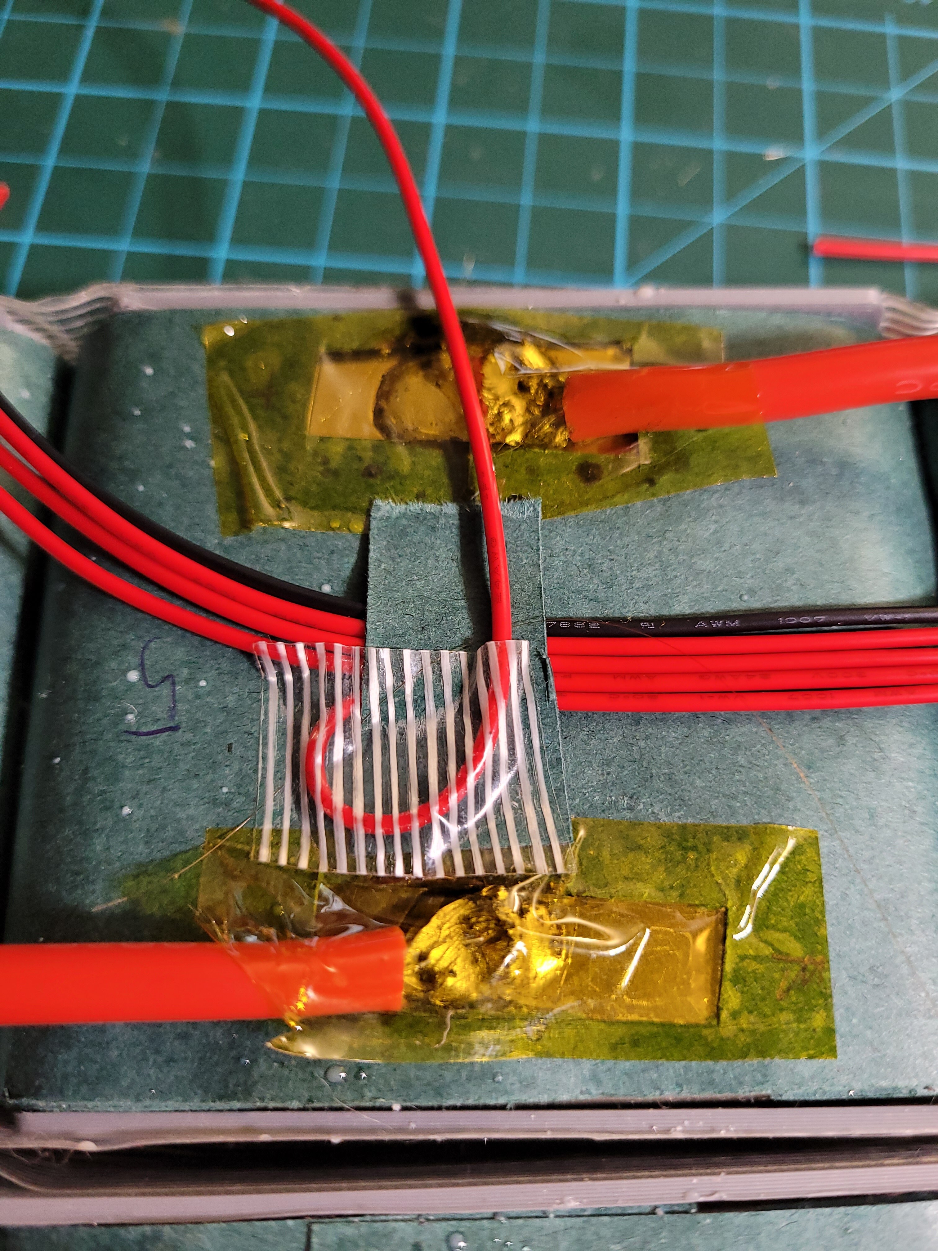

Brand new builder here.Seem to have run into an issue . Hoping you may have a recommendation. Issues being its no longer working. I purchased a charging port from m-board. Charging Port . And the battery was given to me by another build enthusiast. Its a samsung 36v 10ah of some sort. Since it had the same JST connector, I was advised to cut the ends of both the charging port and battery and connect them by way of soldering. Since the battery worked before, I figured it would work out just fine. Well that wasnā€™t the case and now doesnā€™t charge. Now I come to you in hopes that this is a salvageable situation.
Anyone have any advice?
I donā€™t know much but If it were me Iā€™d start by checking the polarityā€¦from the charger all the way to the battery. Iā€™d also check my solder job and battery/charger voltage.
Esk8 news approved?

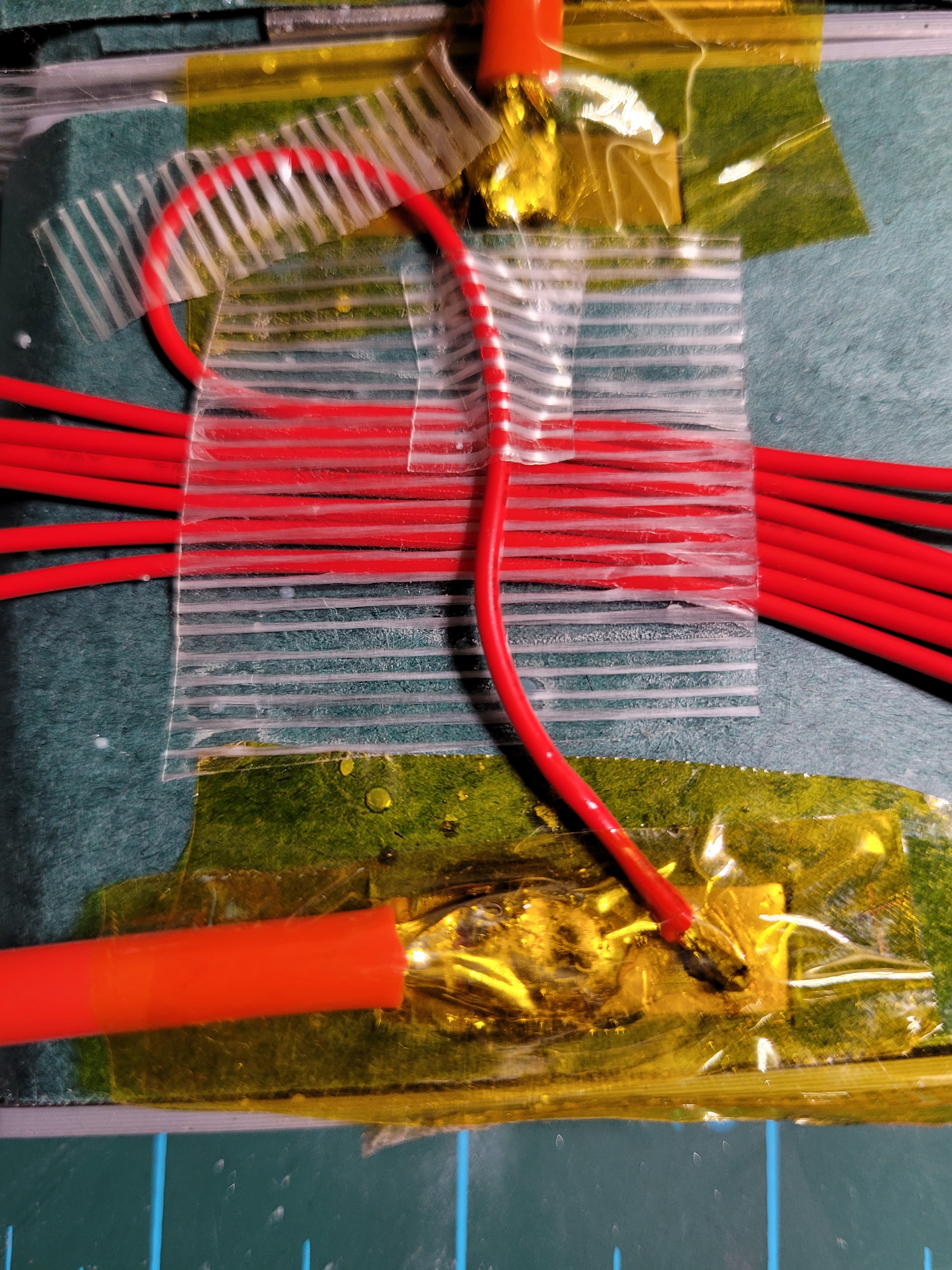

Would personally much prefer to see a fishpaper bridge. I also try to avoid routing near larger soldered wires because they can be sharp.
I would personally prefer to see a piece of fishpaper in between there, in addition to the tape.
Also that balance wire solder joint at the bottom looks very sketchy.
ah ok thanks. I already had FG tape there to hold the wires down so I figured it would be usable. Should I replace it or is it just something to keep in mind for the future?
also the solder joints did look janky to me too, but a hard pull didnā€™t move it so I decided to keep them.
You can leave the tape, but Iā€™d definitely add a strip of FP under the wire.
Perfect :ok_hand:

Iā€™d personally reflow these joints so theyā€™re a bit more cohesive. Iā€™m not sure if it matters though.
I chose not to as they didnā€™t budge after a hard pull and I donā€™t wanna keep heating up the cells
