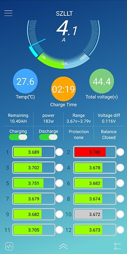

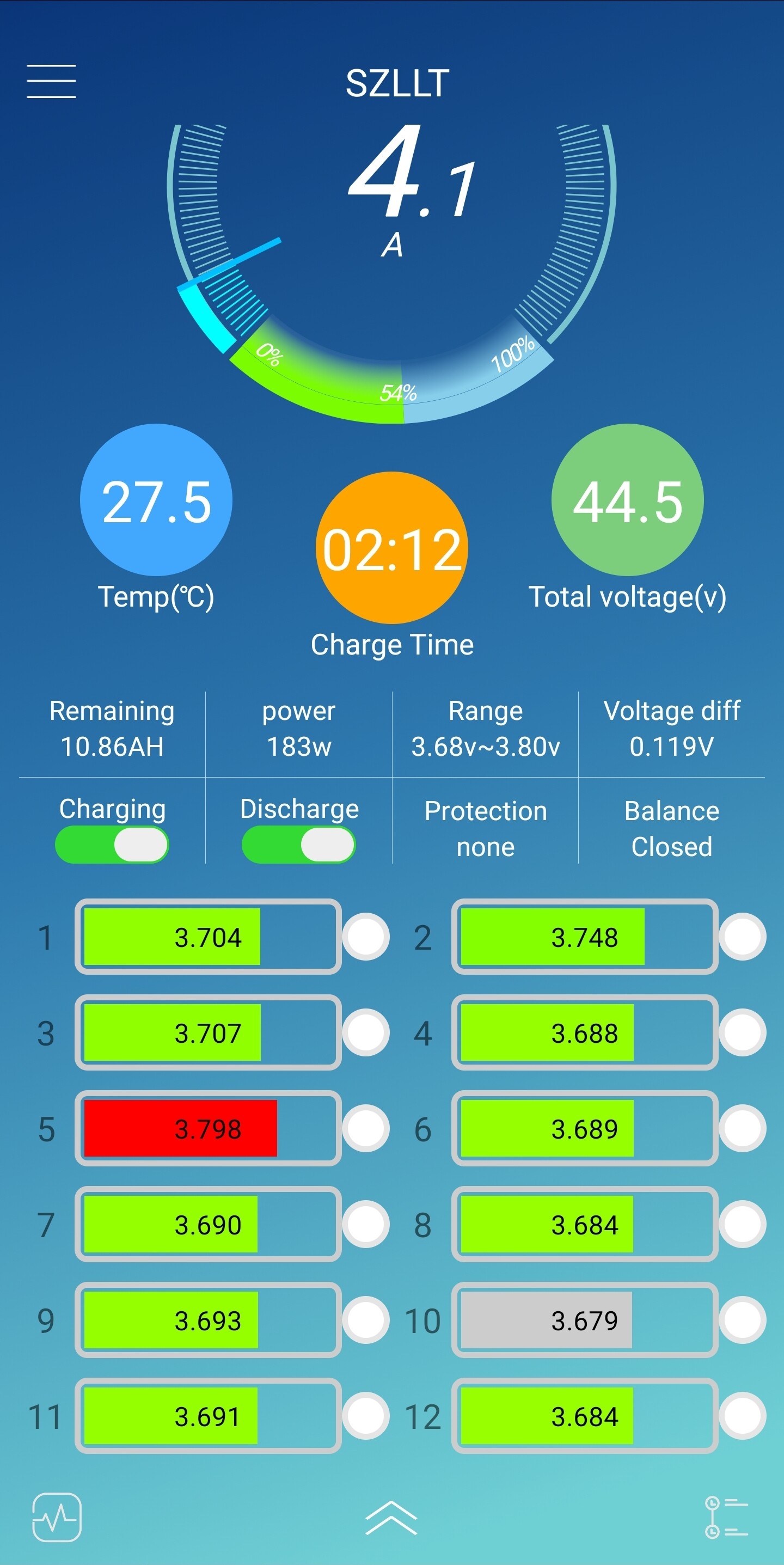

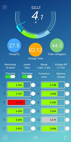

Is this normal? New cells P42A 12s8p. All cells were 3.53V and 3.52V. This is the furst charge.
Now number 5
this isnt normal. If group 2 is charging faster than the rest of them, it means the capacity of that group is lower. Perhaps a dead cell?
Or loose nickel
Well, I know what I will be doing for the rest of the day :smirk:
I’d bet on loose nickel, this is a nese pack right?
yes, when i wiggle the pack the voltages jump around so I think you may be right. I’m sure I double-checked all of :thinking:the connection
It should be within a 0.02V difference between p-groups as well as the cells that make up the p-group correct?
I believe that’s a reasonable variance for a decently used pack. From my experience(not much) new p42a’s should stay much closer than that, especially with a good bms.
setting the balance turn on voltage to 3.7V (default was 4.0V) is that a bad thing?
4.0 is about what you want as balancing at lower voltages can throw a pack out of wack
cool, thx
