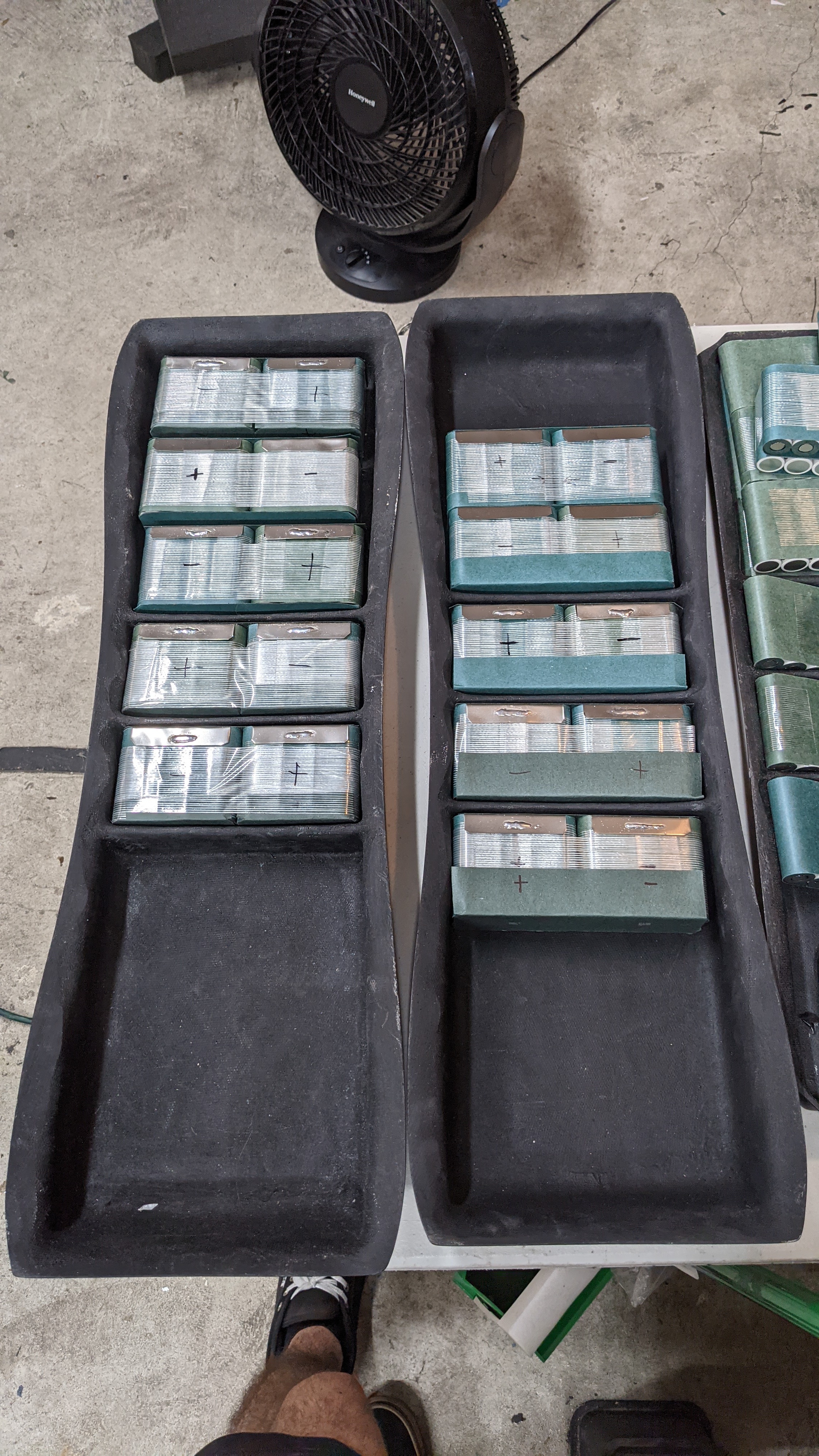

What enclosure?
Haero Bro enclosure from eboosted peru

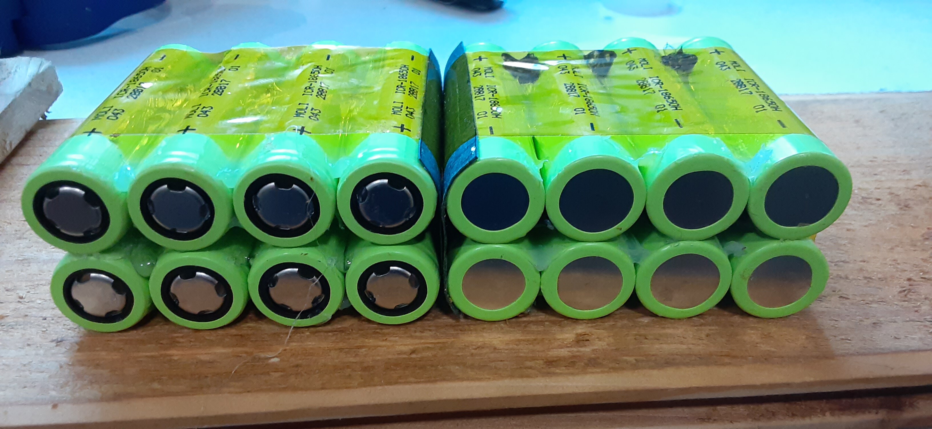

All looks good to me. Think I got the fishpaper right.
My hot glue alignment didn’t come out very good so I taped them while the silicone cures. I bet with this soft neutral cure stuff even if you let it cure off alignment you could pull the cells together with tape.
Now copy and paste, onto PCBs.
Hmm maybe I could have glued the cells to the PCBs at this step/the hot glue spot step?
I’ve tried silicone on cells, I’m not a fan. After a month, it peeled off easily from the cells and did nothing for rigidity or structure.
I’m using the Trendbox black glue, it doesn’t ever move.
I used this exact silicone before and it works like a hot damn it doesn’t want to peel off in one piece at all it’s extremely bonded to the wraps. It also stretched like an inch before breakin. Nice stuff that I am using for sure, kinda removable too.
I am sure the dab of hot glue totally makes up for and of the inadequacies of the silicone :laughing: oh and the 35J welds to .2mm nickel.
What kind did you use general purpose or what?
I tried two types of the GE Advanced Silicone 2, an electrical grade, and the Loctite Marine.
Left them on a set of the Sanyo GA cells for about a month and a half. Was able to disassemble all the cells by hand. For me, that wasn’t suitable.
The pliability doesn’t work much for me either, as I would prefer not to leave all the rigidity of the pack to the welds, and have the structure spread over the glue as well.
35j seems low for 0.2mm. I’ve been using 50-52j. Unless you’re not also using a KWeld… I actually have no idea outside of a couple welders.
hmm was this covered in the ow pack rebuild video? would have liked to see that.
Honestly I have not welded .2 in a while so I was guessing lol. I know it was more than 30, I use less than 30J for .1.
Nah, I don’t end up publishing content on most of my tests. In that video I used the Trendbox glue.
The silicone tests I did when I first started making the CBXR mod, and it didn’t work out so I disassembled it all and shelved it to move on to other stuff.
If the stuff you’re working with works better, that’s good. I was mainly concerned because the silicone held fine after curing, but lost its hold after a month, and I figured it would also do that inside a pack well after it’s been in use.
The stuff I glued with the Trendbox black glue essentially never lets go and remains near impossible to peel off. I’ve actually ended up using way less inside an enclosure for the sake of being able to remove or replace components. Learned the hard way.
Idk I use 54J on 0.2mm and it seems to be good
