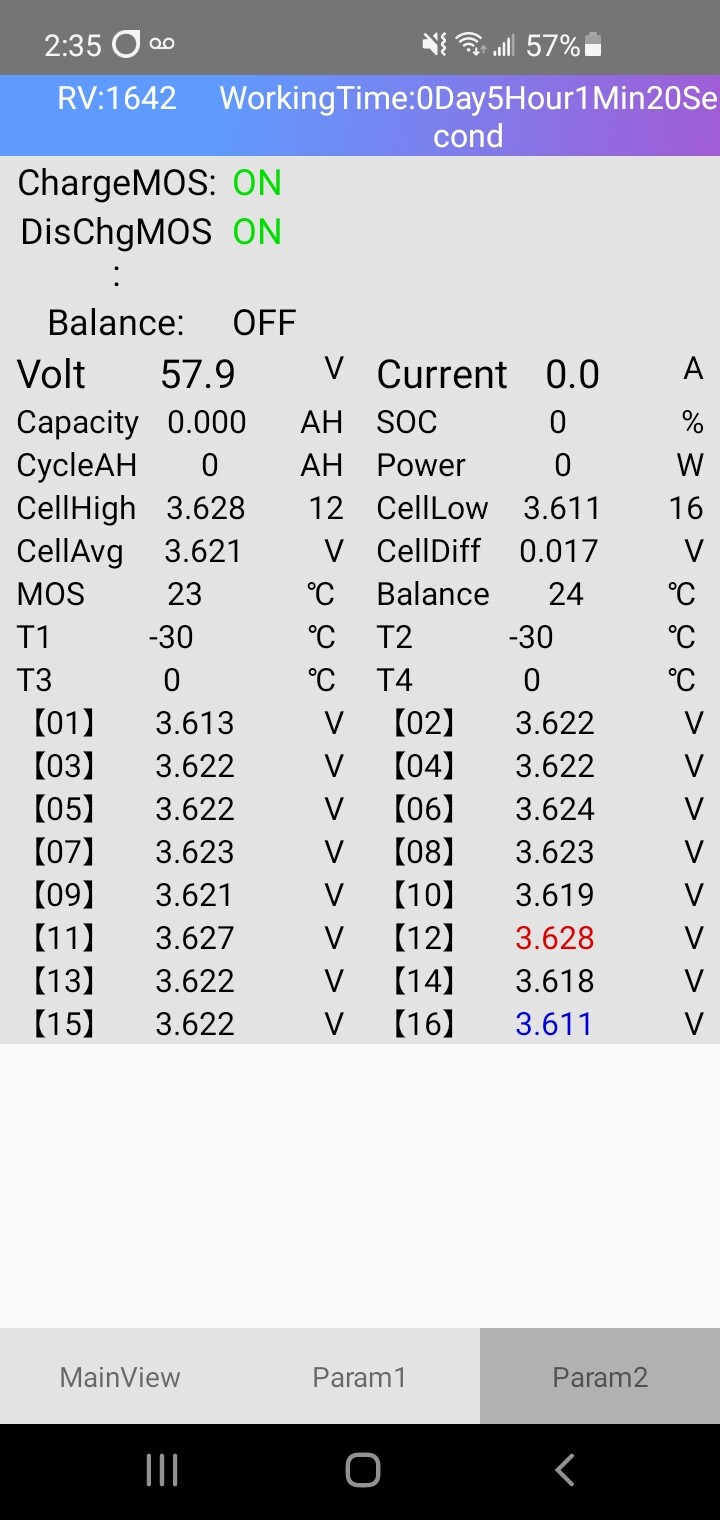

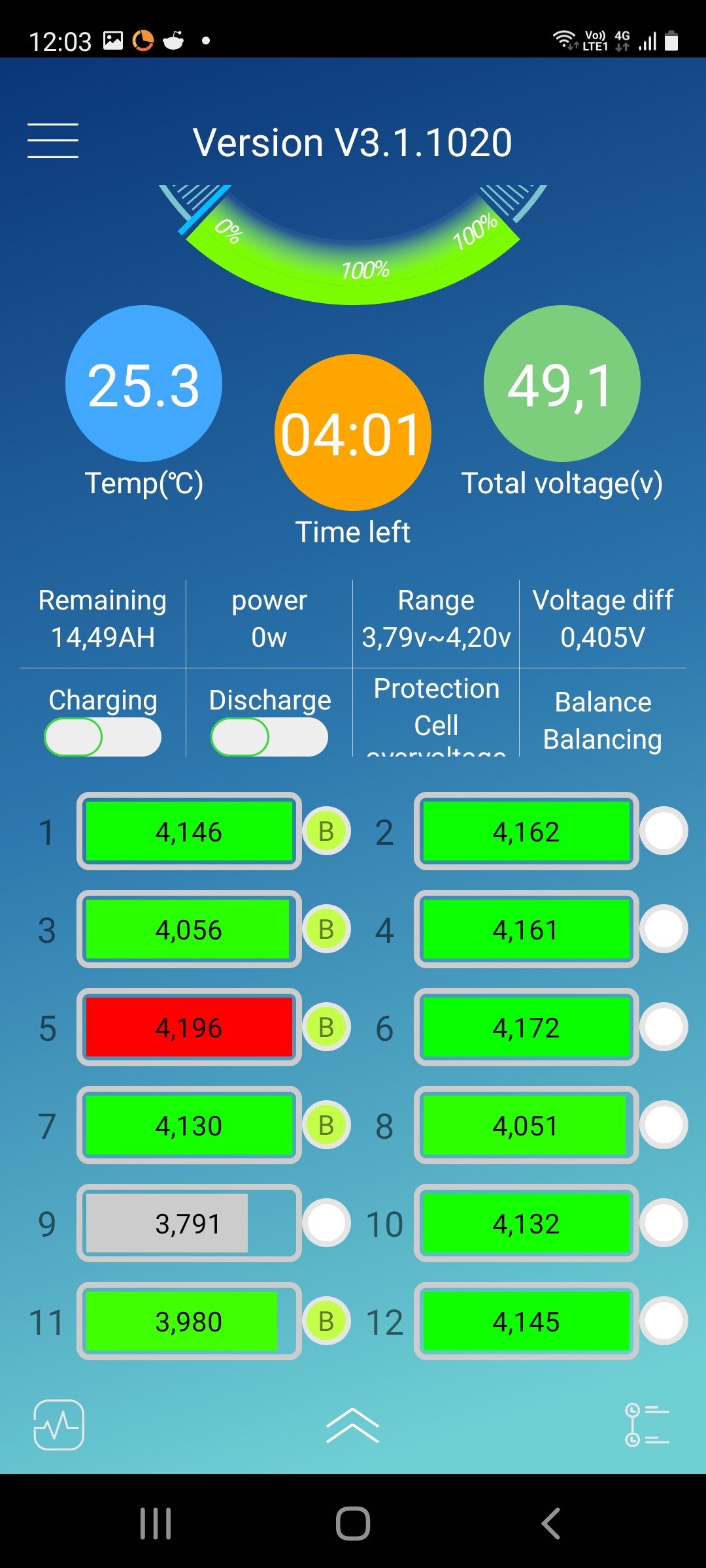

Group 9 doesn’t balance anymore. I will probably need to remove the wrap and check the bms wiring of group 9.
But Is my batyery still safe? I mean, are big voltage differences in p groups potentially dangerous? And can i still ride my board with such a big voltage diff.?
doesn’t mean grey that this one is the lowest p-group? How else would it know the voltage if it isn’t connected to the p-group anymore.
Also, if the p-group doesn’t go over/under critical voltages, you can theoretically still ride your board, but it’s not advisable, as there could be a poor connection which produces a lot of heat.

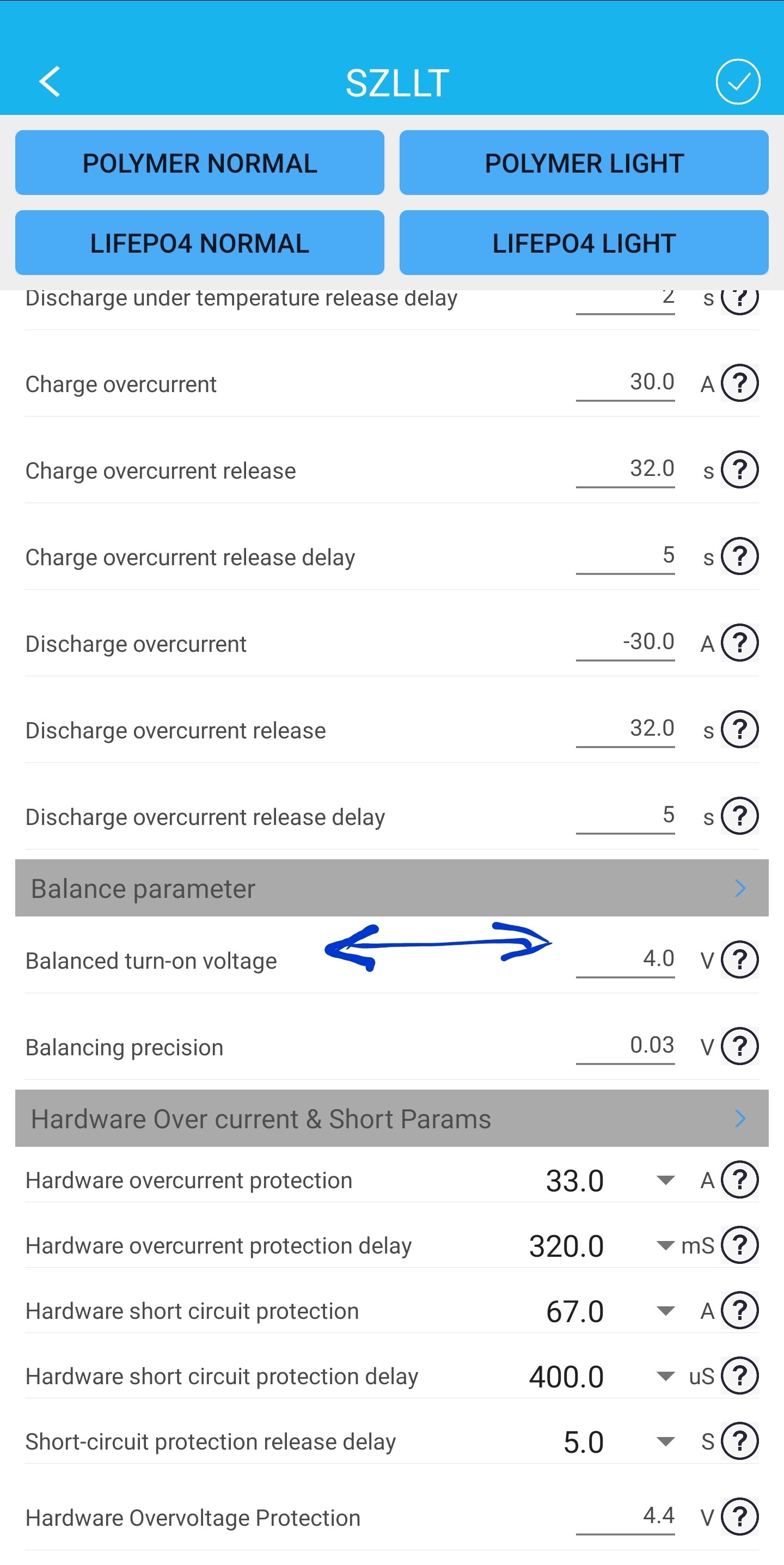

At what voltage should balancing turn on. (P42A 12s8p, LLT BMS 12s)
Whatever you like. 4V seems like a good value to me

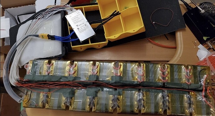

I fixed it. It was wrong to simply put the balance wire for each p group on the -ve. I had to put p group #16’s wire on the +ve and the rest of the balance wires for each group go on the -ve of the group after it rather than +ve of the group - an important detail I didn’t figure out at first and no one told me :sob:
Also I replaced all the plastic wires in my battery enclosure with 20awg silicone wires. Will arrange the wires and tape them all down on top of the hot glue next.
