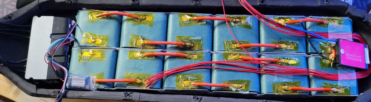

Just started pouring on me as I was riding and my LLT BMS got wet. Anyone have any spare 12s LLT BMS for sale?
https://esk8life.com/?product=smart-bms-12s
edit: nvm not in stock fck
After an IPA bath it’s good. All dry and no corrosion as it was wet for Abt 10 mins
damn that’s a tight fit. whoever buys this battery will need to use a focbox or stormcore. No room for accessories at all.
