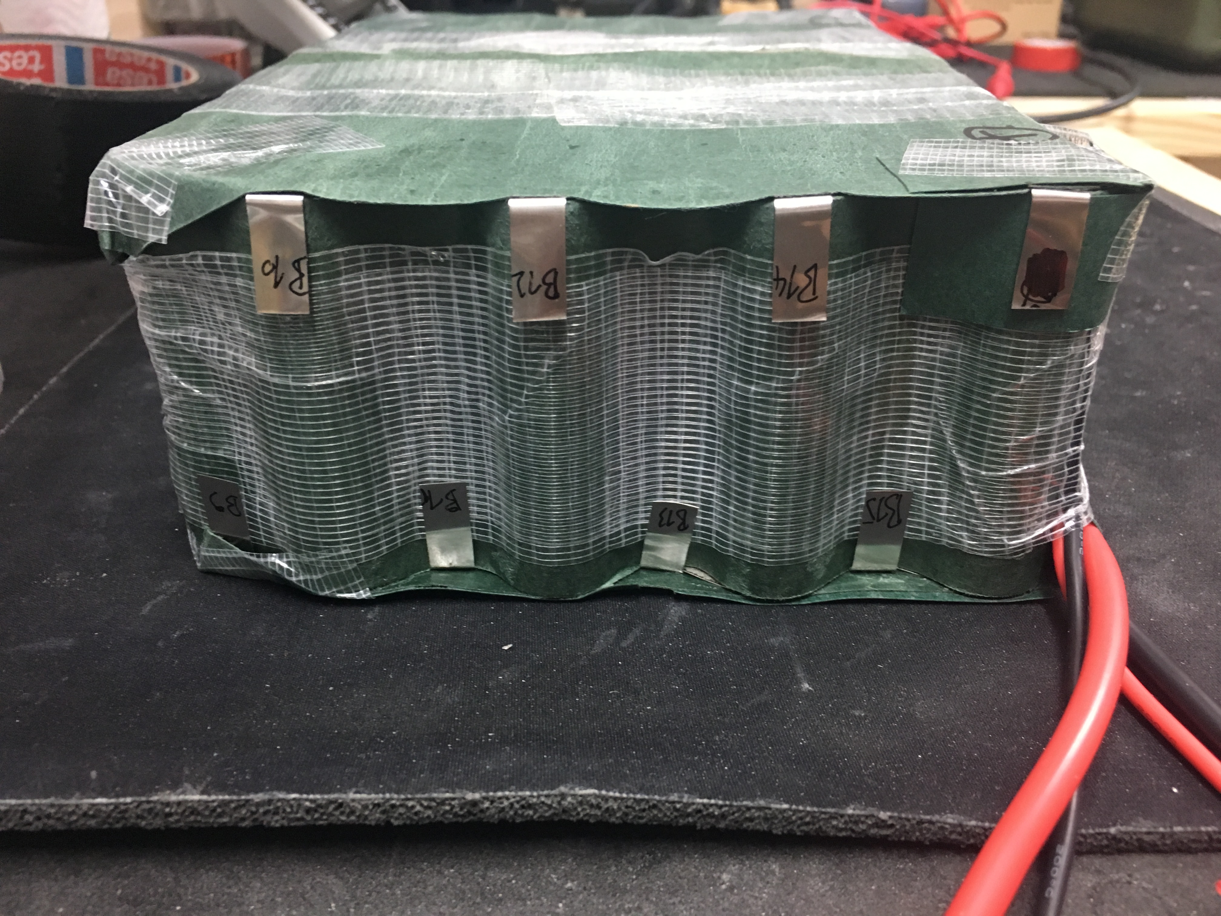

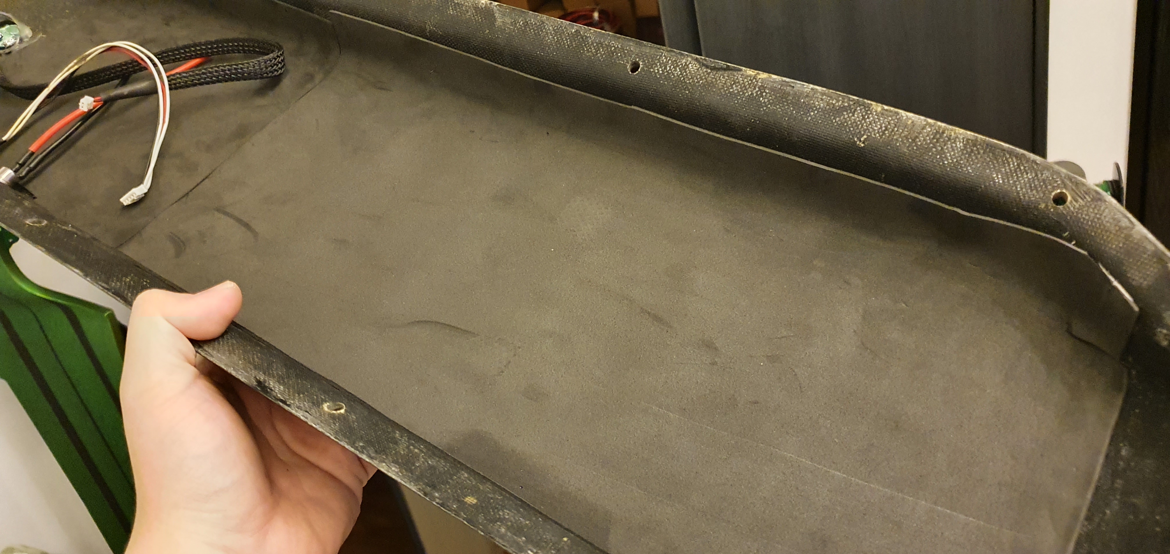

Balance wires should be deck side or enclosure side?
I velcro it facing up to the deck, so it faces the enclosure. Do put a layer of 2mm foam or similar so it has some cushion

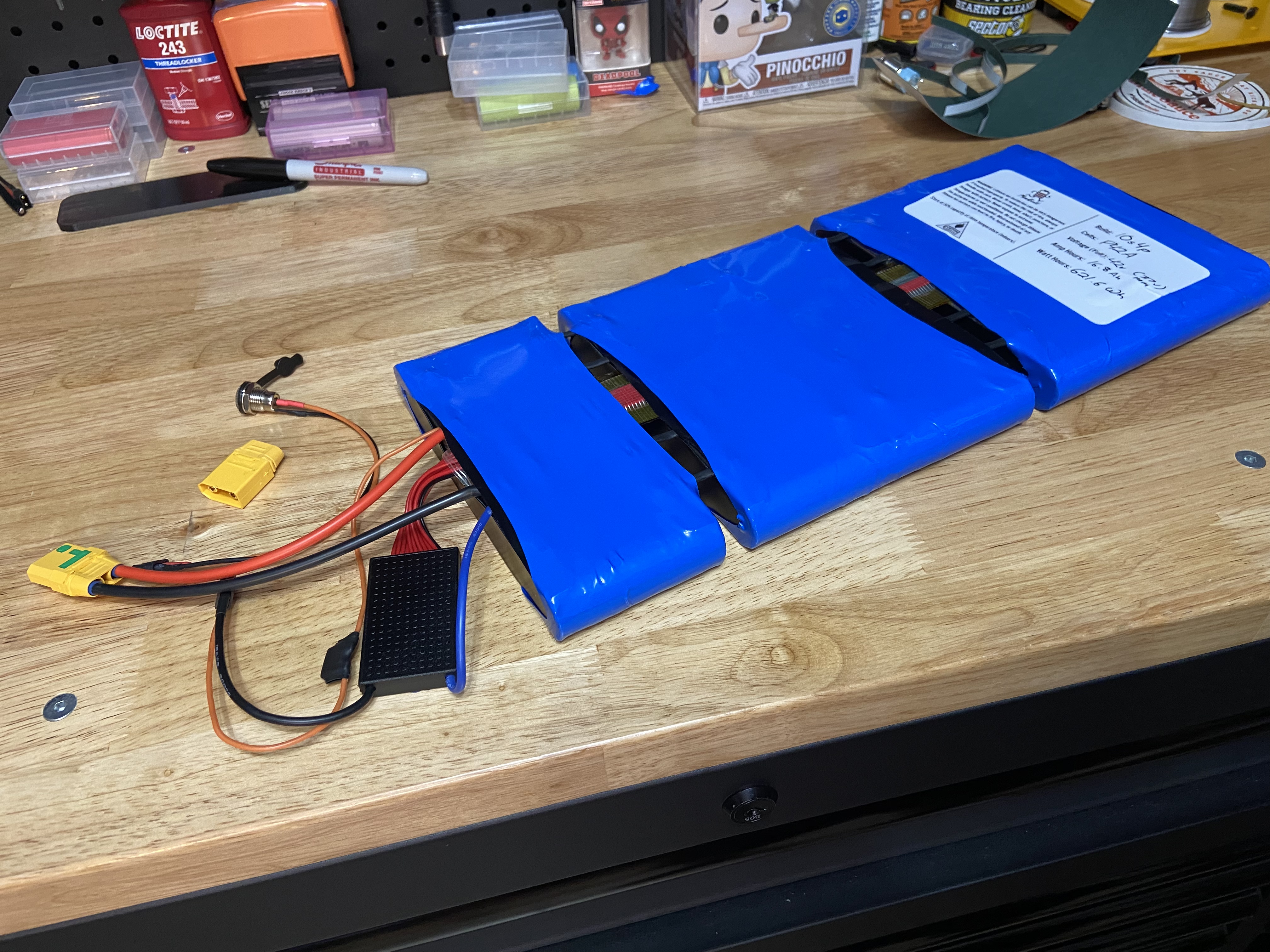

Hey! I published a build here too! If you have any feedback I’d be more than happy to hear them!
I’m sorry I don’t understand…So the wires are flush with the deck or enclosure? clean build BTW
Welcome to esk8.news!

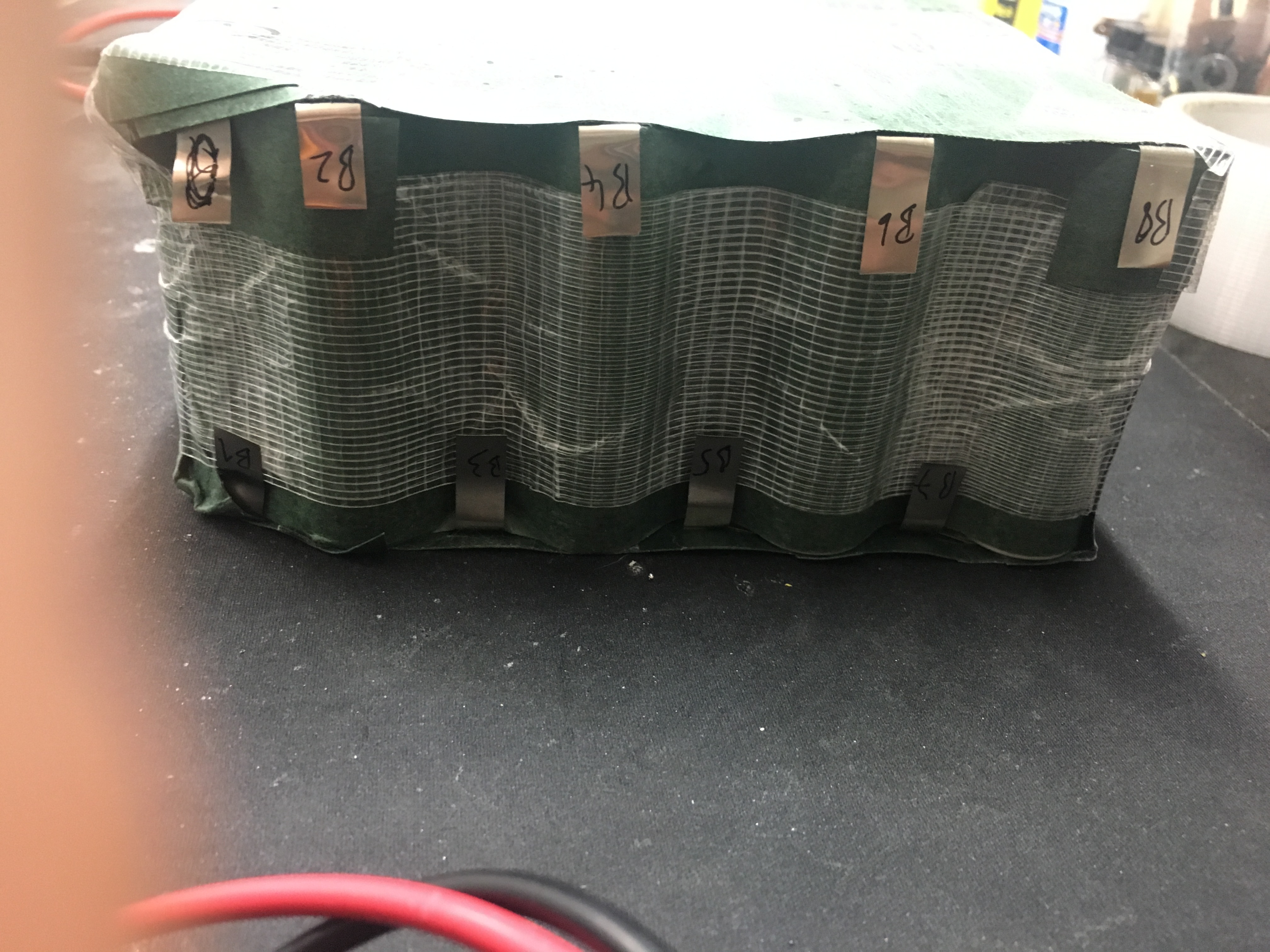

Depends. While building, I put them on top of the battery, and usually that means they end up board side. However some folks attach the battery to the deck, so it’d be enclosure side.
Depends on where the battery is going.
Here they’re going to end up board side. This pack will sit as is into an enclosure.
But here they’ll end up enclosure side.
In my opinion, it depends on how the battery will be mounted. If you mount the battery to the deck (so the enclosure is just a dust cover, not supporting anything but itself), then I would put the balance wires enclosure-side, so they aren’t squished between the battery and the deck.
If the battery is in the enclosure, and the enclosure is supporting the battery’s weight, then I would probably put the wires on the board side, so they don’t get squished between the enclosure and the battery.
Basically it all comes down to what direction the prevailing forces are, and then going the opposite.
The name of the game is preventing the balance wires from getting pinched, chafed, squished or otherwise mangled by repetitive forces.
As long as you can negate that (foam cushioning so the forces are redirected to where the wires are not, for example), then it doesn’t really matter.
