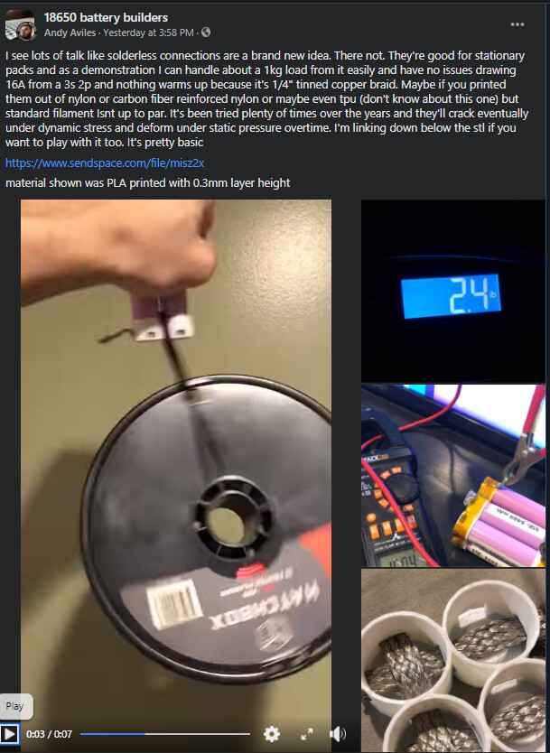

If you plan to draw current from that pack to the max, maybe not, but otherwise I think it’s fiiiiiine.
Ok maybe i weld a piece of nikel over it just to be on the save side
seems to boast the rodust connection even if the application is stationary
Quick question! What’s your go to place for pure nickel? This was what I’ve found while searching the forum: 0.2mm * 30mm Pure Nickel Plate Strap Strip Sheets 99.96% pure nickel for Battery electrode electrode Spot Welding Machine|Tool Parts| - AliExpress
Is there any place that offers pure nickel faster?
After burning a whole in my soldering iron with a small short, the battery wiring is done! Not the neatest joints but they’re all strong.
Not to bag on the idea, but 1Kg is pretty minimal when we’re talking about robust, high current, reliable connections, especially in high-shock, high-vibration environments that can easily see peaks of over 100G.
For comparison, one single M4 screw tightened to spec, exerts over 250 kilograms of clamping force.
For some applications I think that method can definitely work. Please don’t think I am universally saying it’s a bad idea.
But with the end cap being able to back off whenever the threaded plug is screwed on past a certain point (the static friction strength of the end cap on the cell) I have my doubts that method can handle high current levels and/or shock and vibration over the long term.
I’m glad you posted the vid links though! I am fascinated about clever ideas like this and always enjoy seeing them.

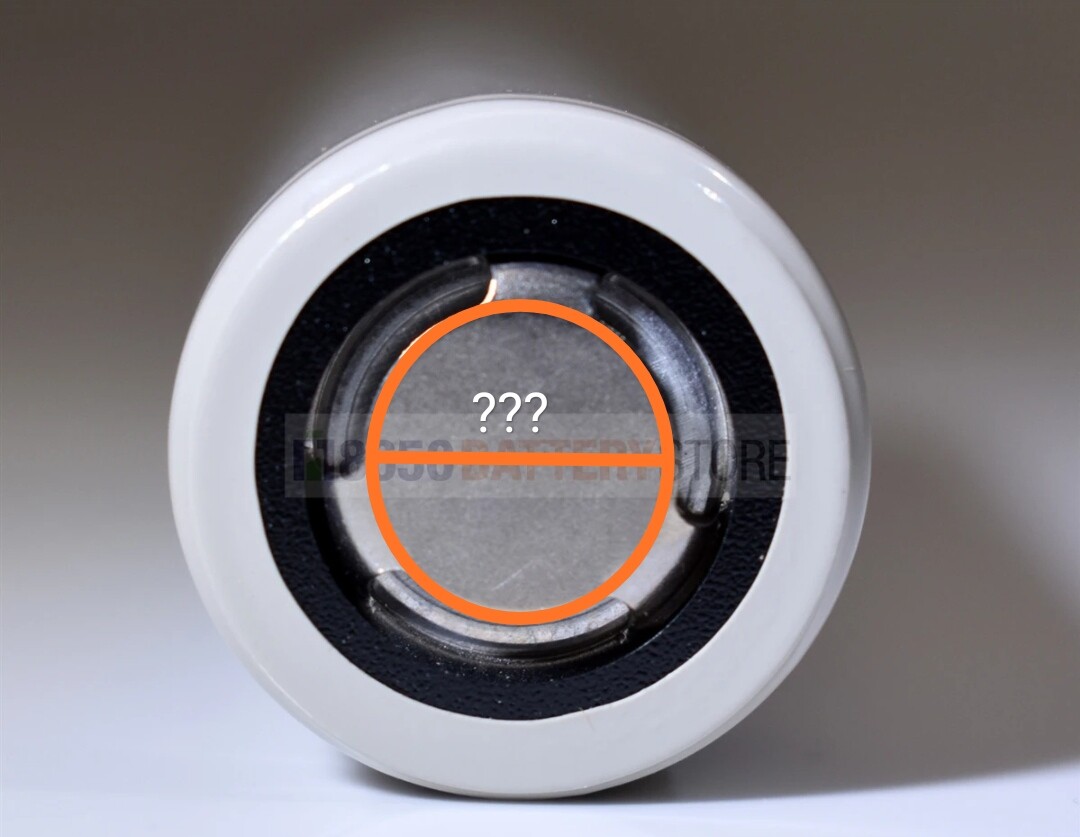

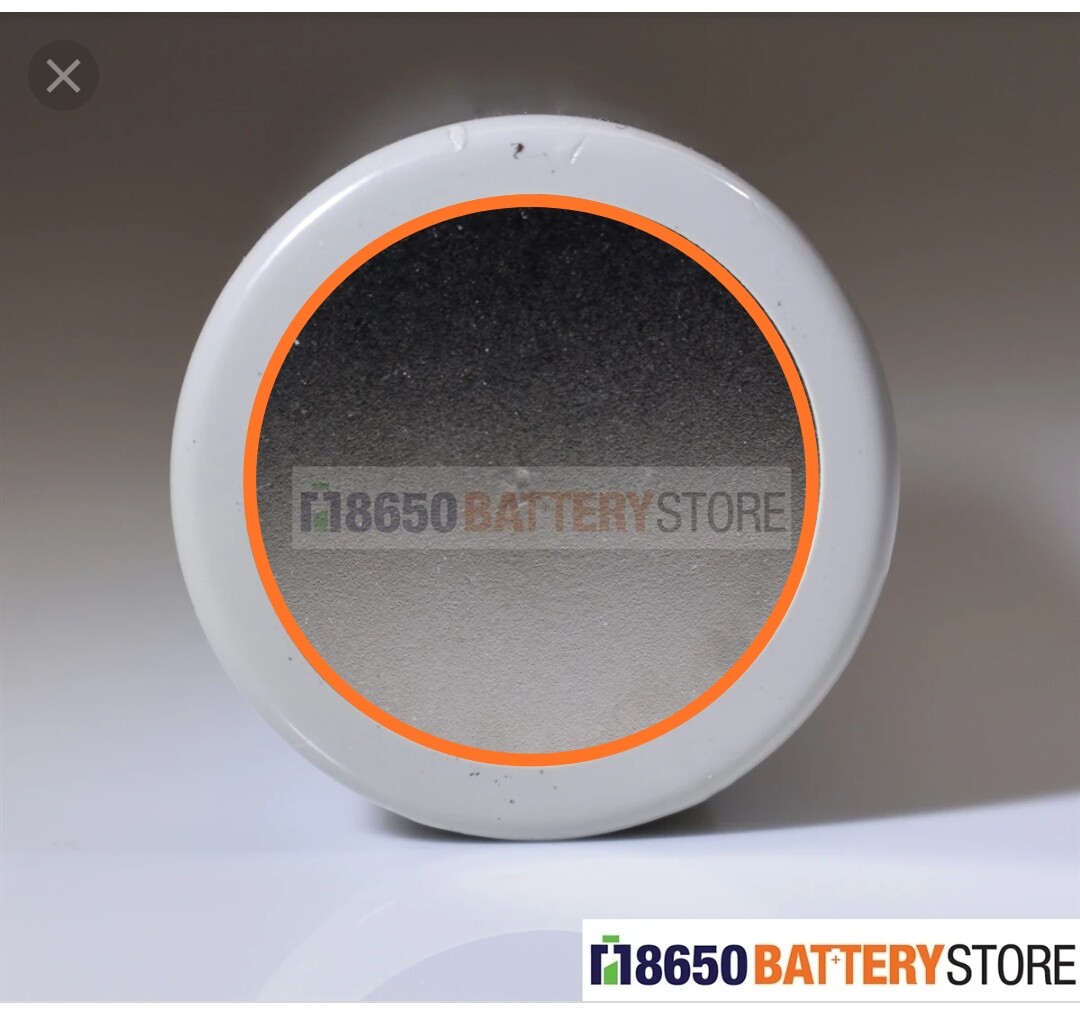

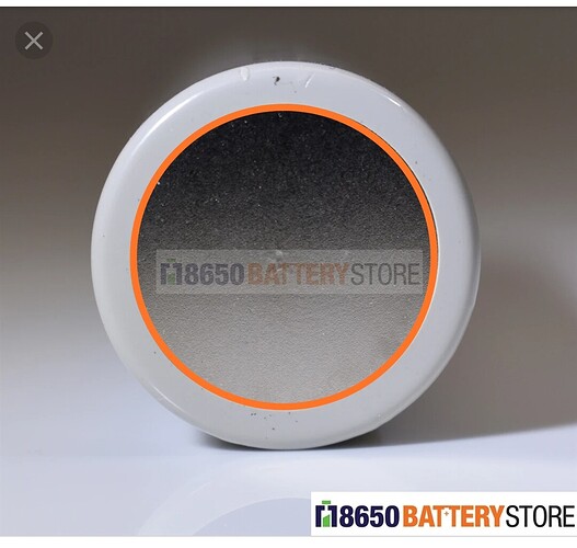

Does anyone possibly happen to know what the diameter of the positive terminal on a P42 is?
Edit:
Negative will also be really useful :smiley:
positive is ~9.5mm
negative ~17.0mm
Geez that was 10 times faster than all the time i just spent on Google :joy: Thanks a whole lot! :smiley:
How much are the measurements off?
Edit: just realized it would be less than 1 millimeter… Forget my question :sweat_smile: Thanks a lot!
Keep in mind that while the positive measure should not change, the negative measurement will change slightly. That circle is defined only by the heat shrink wrap on the cell, and that’s going to vary from cell to cell.
Thanks for heads up! :smiley:
