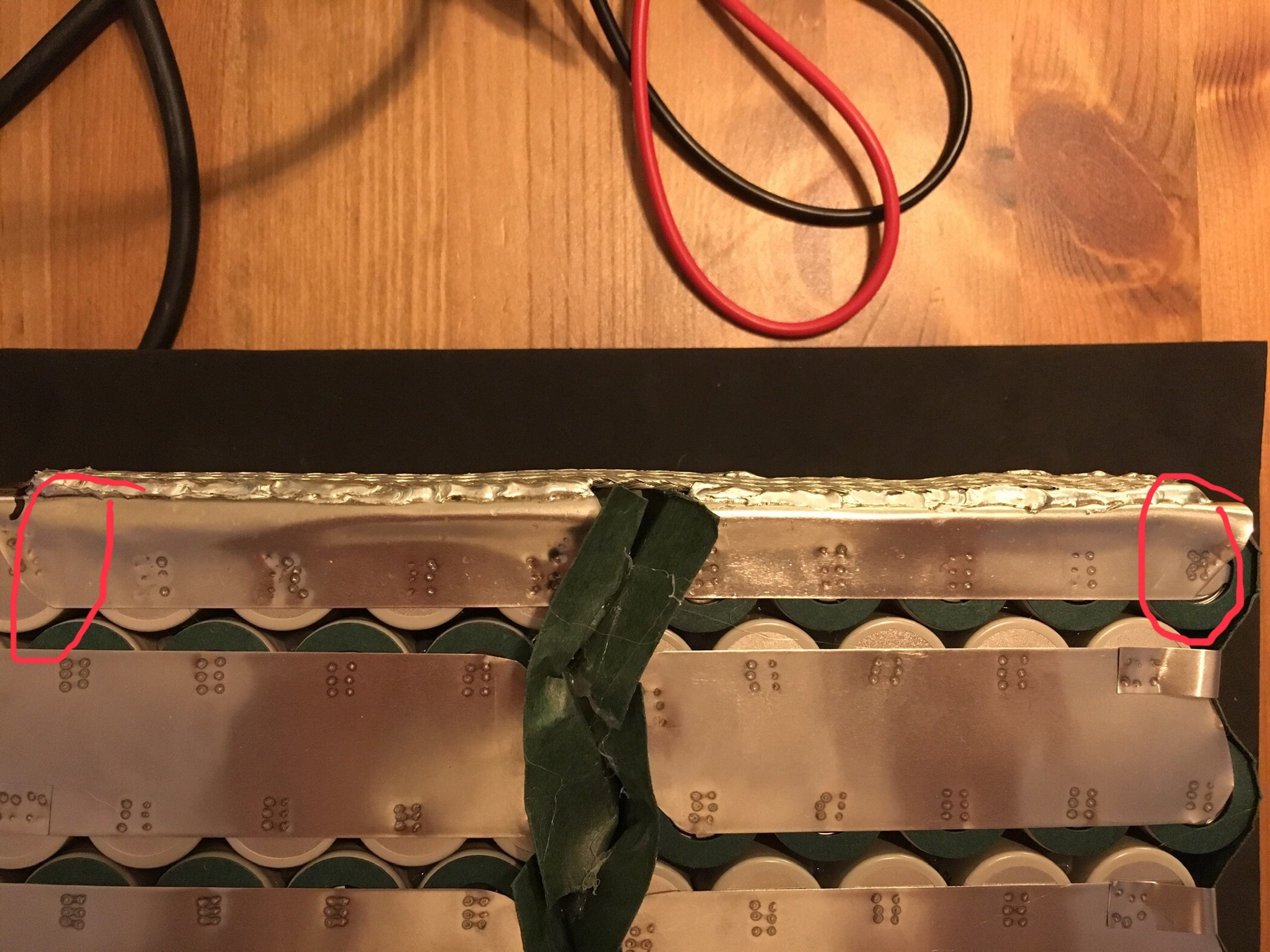

Guys is this smthg i need to take care off
The nickel strip only covers half of the cell
In the last row
