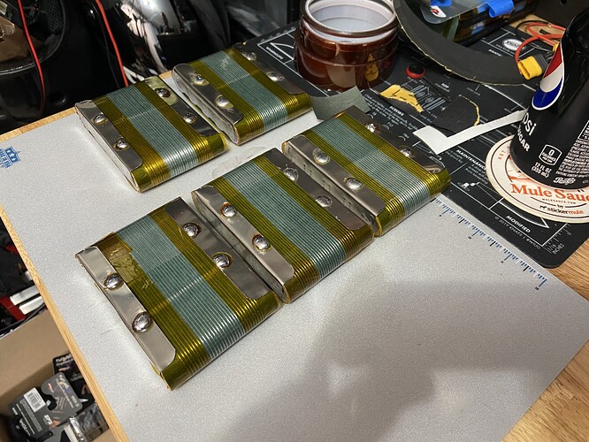

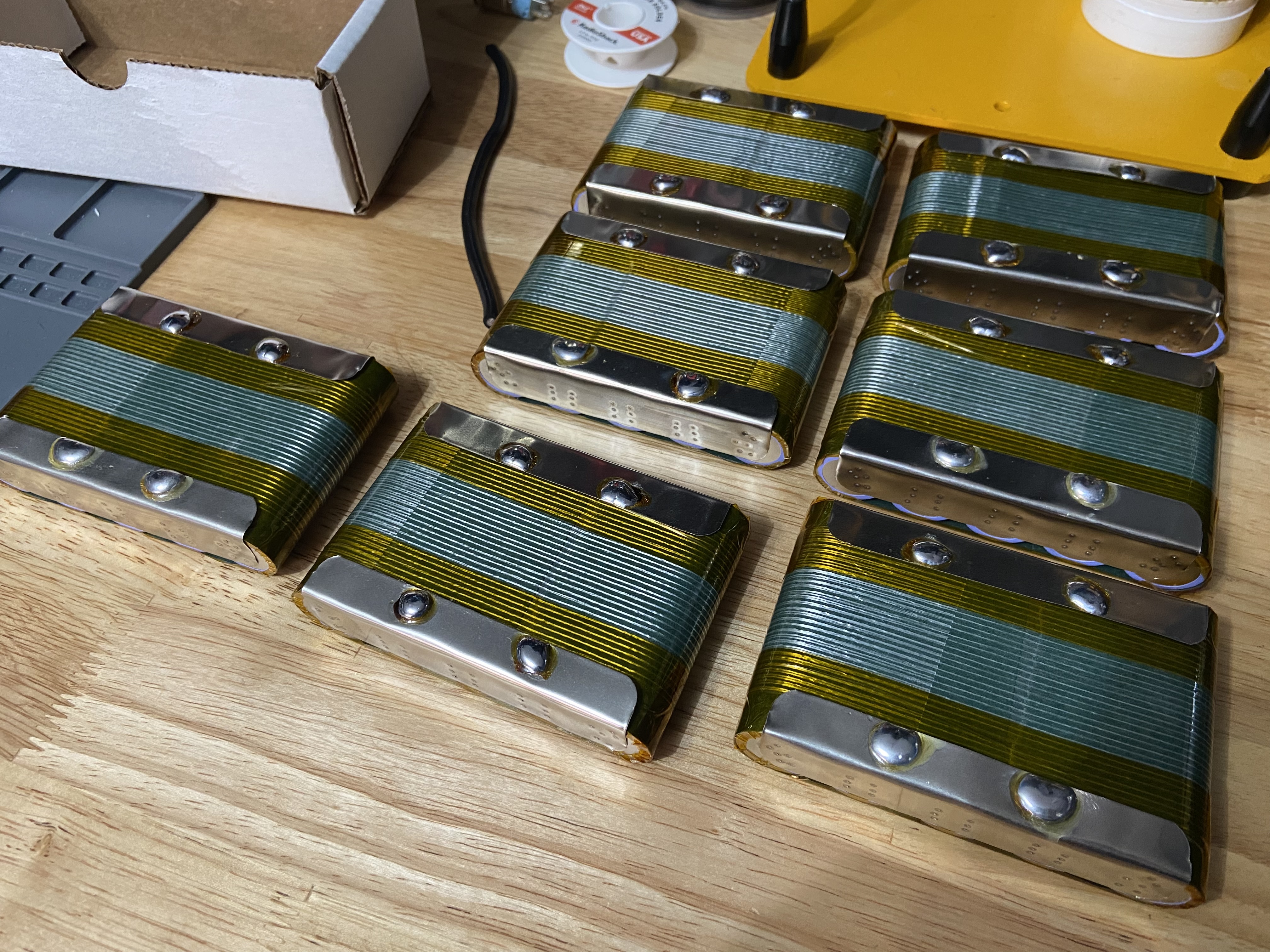

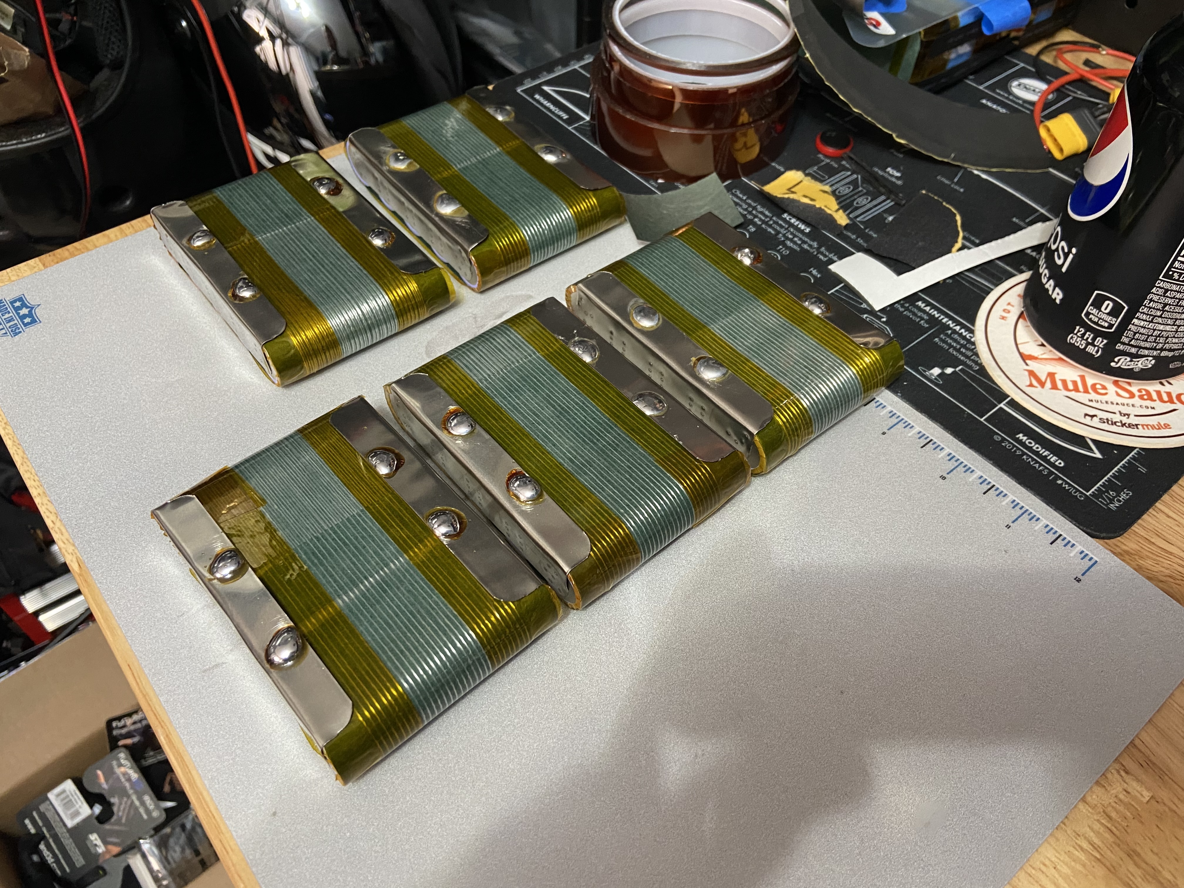

Coming along.

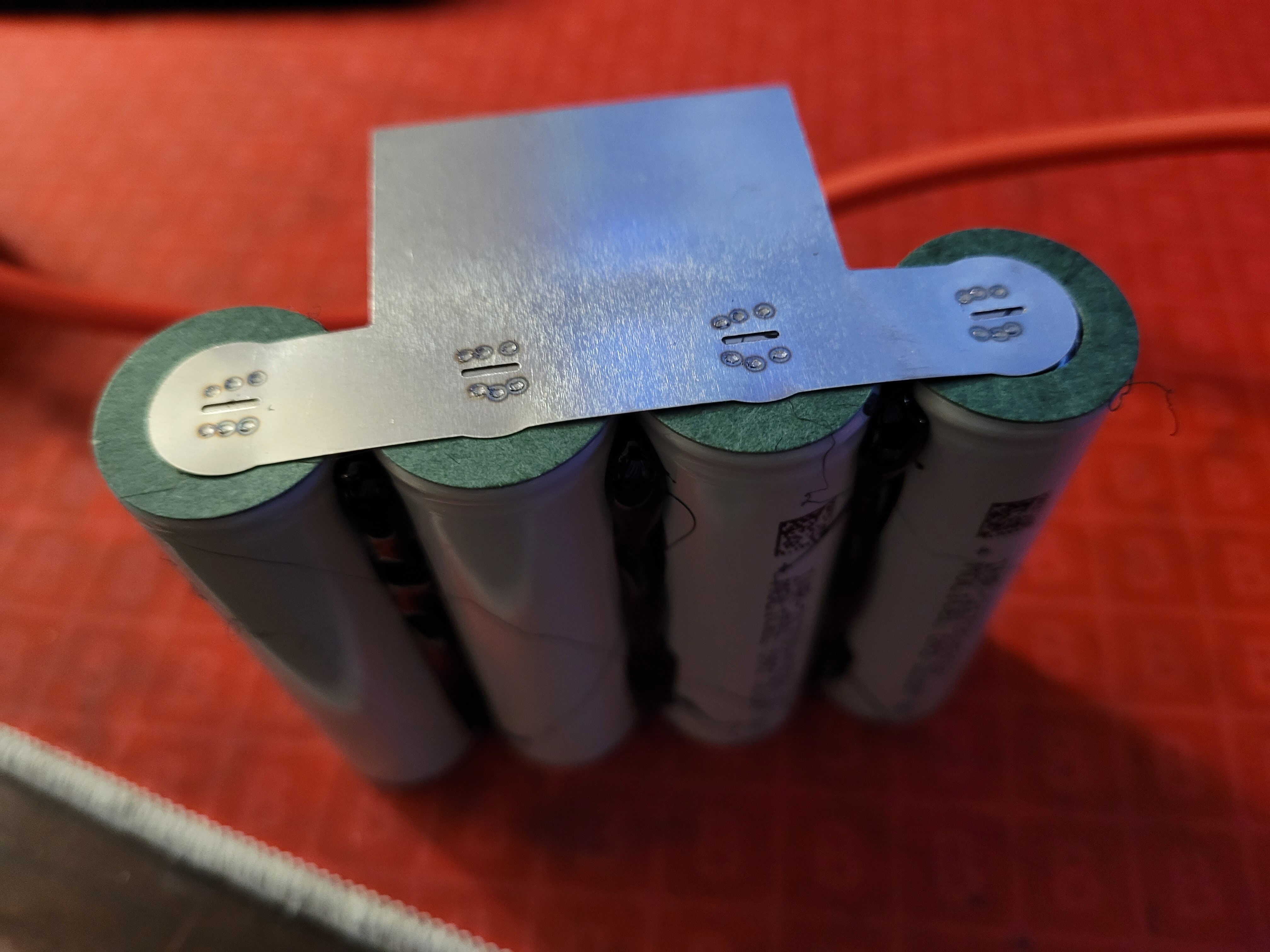

How is this?
Welds are a touch hot but not a big deal, if you switch between cells as you weld (1 2 3 4 1 2 34…) it’s gonna be fine
On the negative side you should spread it out as much as you can, aim for a hexagon along the edge of the nickel
Overall well done though!
I’m surprised that it’s hot, but its probably because I shortened my leads as much as possible. Running a kweld on 45J with a single 5ah lipo.
Otherwise thank you for the feedback!
Negative terminal will need more energy, as the voltage drops it will need to get bumped up so try to always have a full battery when you’re starting. I find it best to start on the negatives (go down the length of the group one weld at a time so it doesn’t overheat) then do all the positives as the voltage goes down
You could also keep the battery on the charger at all times, thats how I ran it while I used lipos.
Although I broke the internal connections on all of them lol
After 2 p groups I went from 12.4v to 12.25v. I’m still mostly charged, but I’ll definetly do this.
