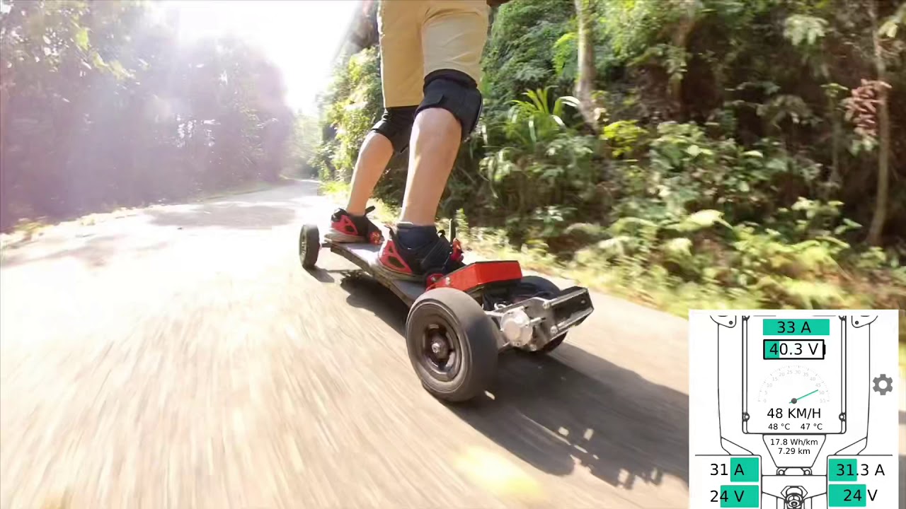

Interesting video I saw a while back. he seems like a 170-180ish pounds minimum and never really goes over 2000 watts. Mostly hovering around 500-800 watts uphill.
he seems to have the setup geared haaard for torque because he’s never pushing much motor current - it’s always limited by the battery or the battery settings in the unity. If I try and accelerate from flat, never mind up a hill, it hits straight into the motor current limit even geared 12/44 because I’m ~230 and on cloudwheels
edit: wait I just saw the speed reading, what the hell?
Sheesh 12t motor pulley, how tight are your belts?
My belt singular thank you very much, this dumbass decided a single 6355 would be a great idea
