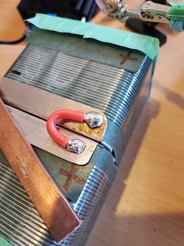

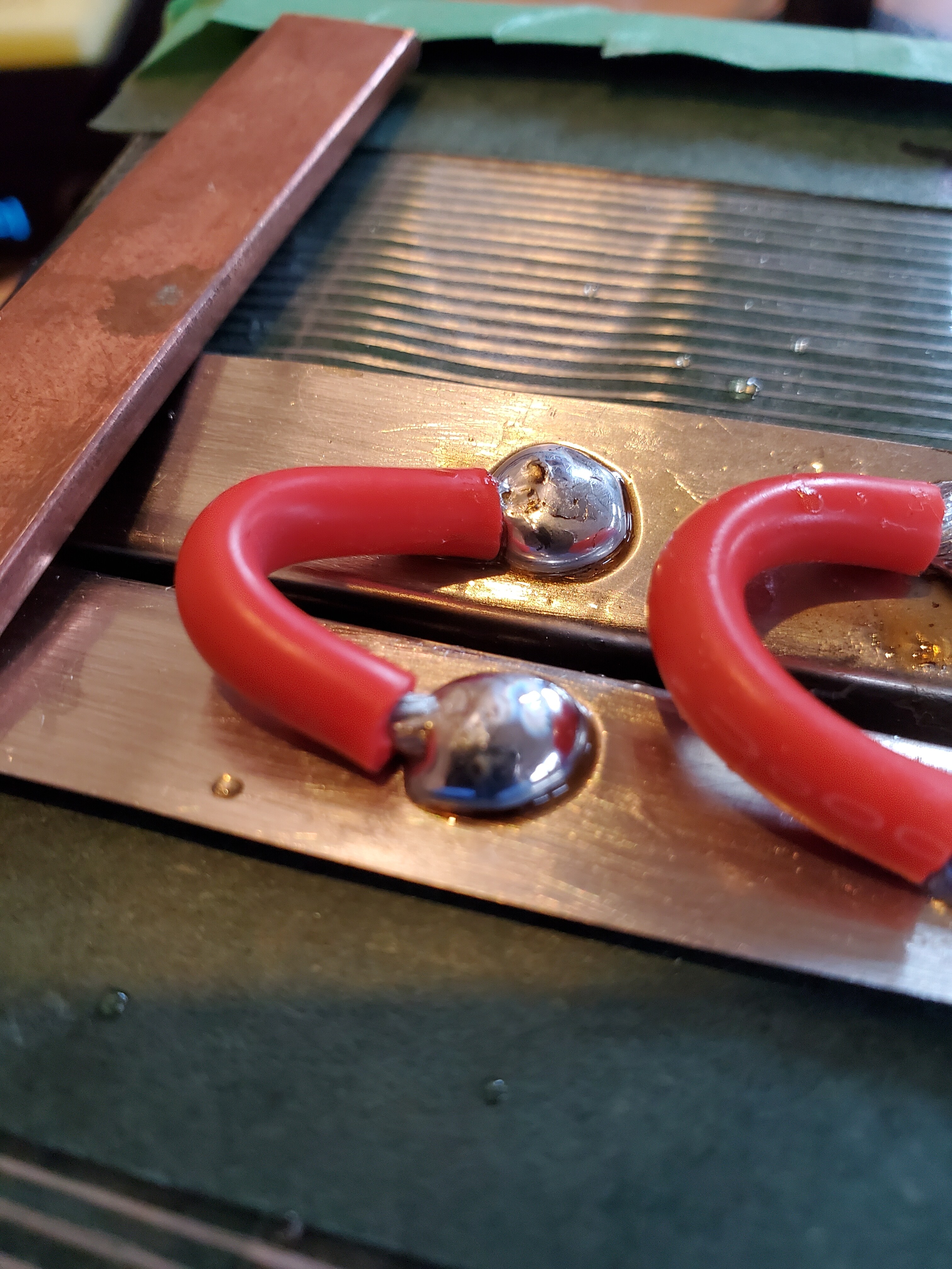

Using the recommended solder, iron, and flux. How is this? 400C
They do look like they’ll hold. But the upper one is better than the lower one, and ideally you want the solder edges to blend to the nickel not form a bubble that cuts back at the nickel
I agree with @A13XR3, the solder should transition smoothly down to the nickel and not appear to be just sitting on top of it. It should be a shallow ramp of solder up to the wire and not a sudden bead of it.

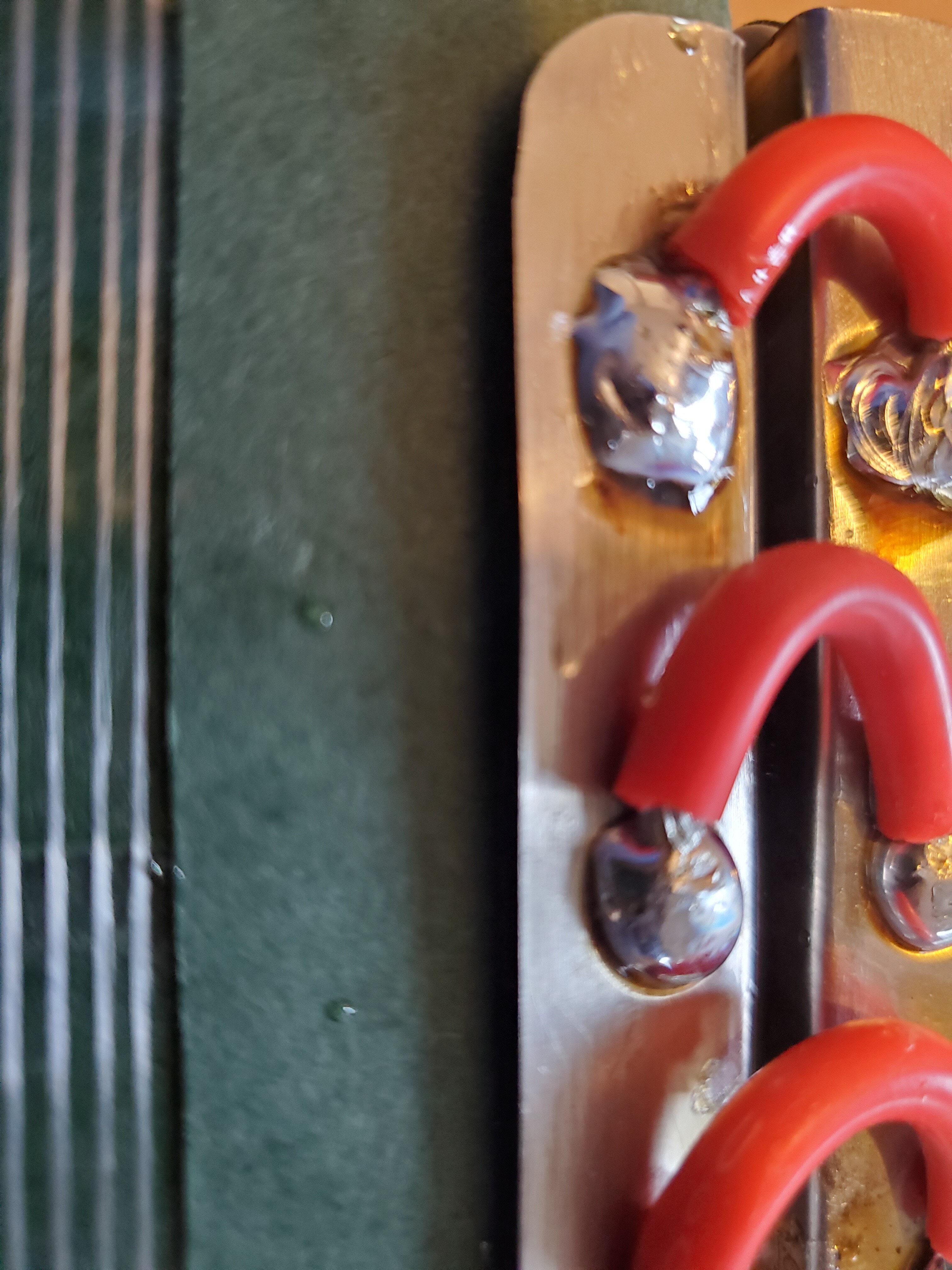

How do I do that? Is this any better?
Yep, getting better. Make a wider solder prep area for the wire to be soldered too. I presolder a little pool about double the width of the wire end.
Great idea. Thank you
Like the top not the bottom?
:+1:
Top right one looks good! If you’re able to go hotter (can’t remember if the recommended iron was a TS100, if so it can’t do it without modded firmware) then I’d go for that, it’s a big lump of wire rather than sensitive electronics. The lithium only really cares about the total amount of heat that gets transferred into it, so it’s basically sensitive to duration of soldering rather than temp of the iron and higher temps will get the job done faster.
