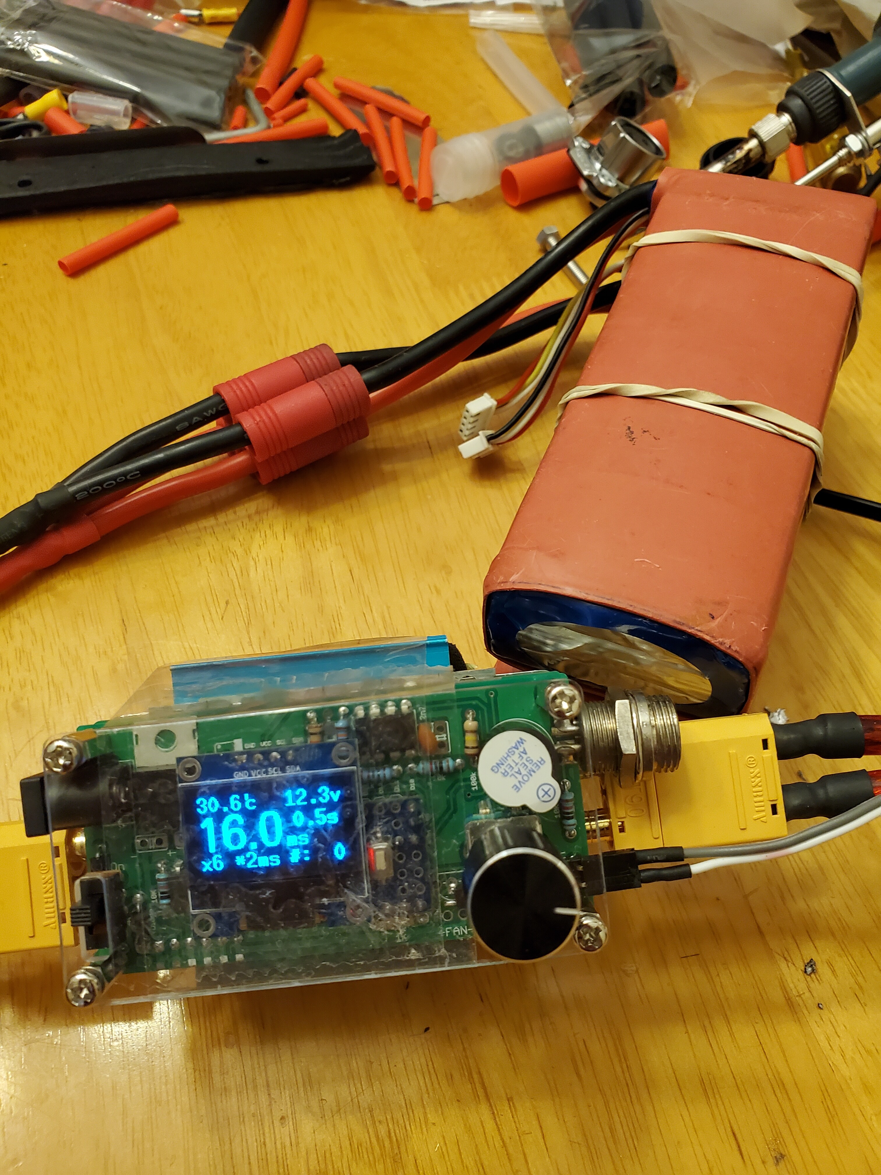

I have a boss level spot welder with two 3s lipos in parallel and 8awg wire. I need these max settings to get a weld with 0.2mm nickel where it sticks to the cell after pulling? Does this make sense? @Anubis

…and these are some of the welds. I can pull it off with my hand but not easily - is that good enough? How come some of them look so different? It’s the same settings
What welder is that? Gonna have to be a no from my pov.
