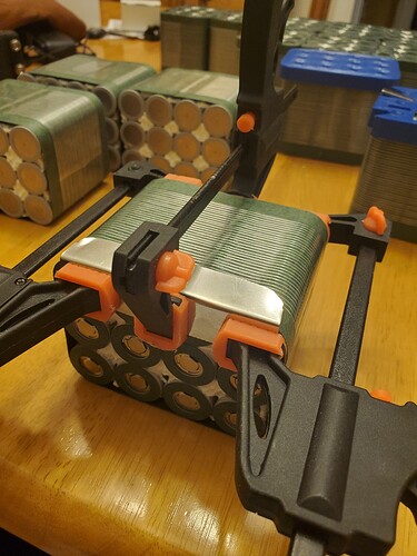

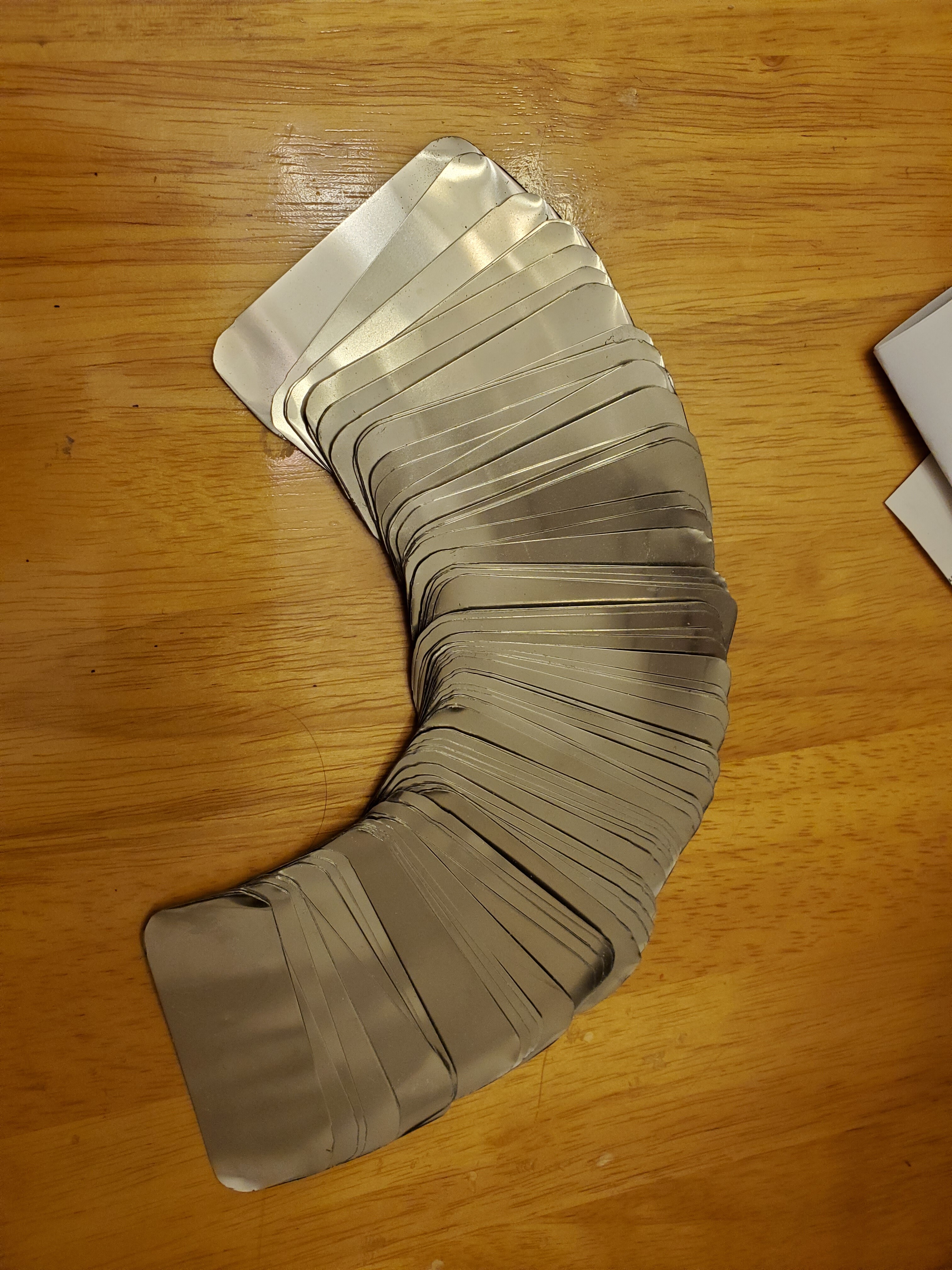

The part didn’t melt. Though the little blue circles to align the nickel broke over time. I should have made them into rails. I have metal dust all over me. Took 7 hours cutting my nickel :sob: 96 of these pieces.
Any tips for folding the nickel? I will fold one piece half over the top cell of the p group for the series connection wires. I will first solder onto this fold then spot weld so that the cells don’t experience that heat.

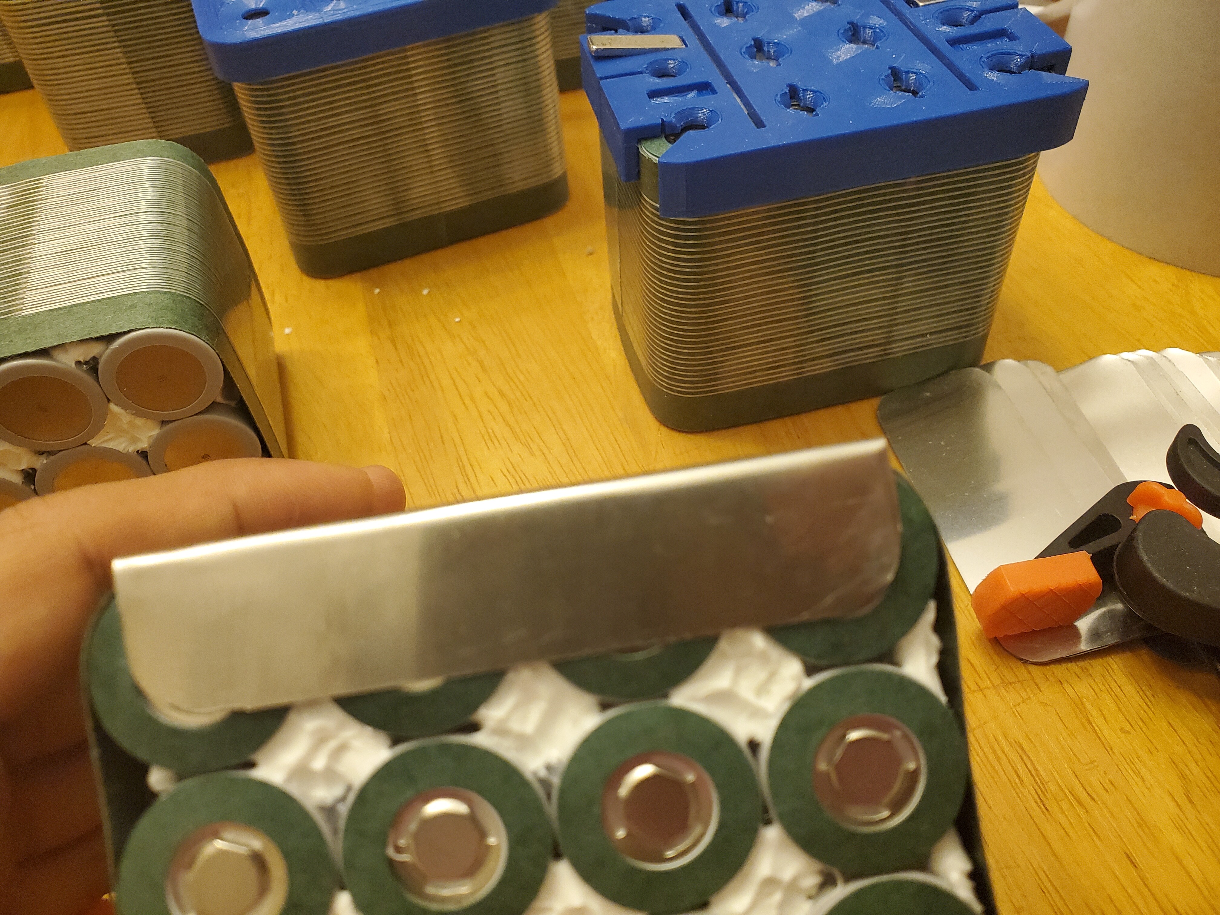

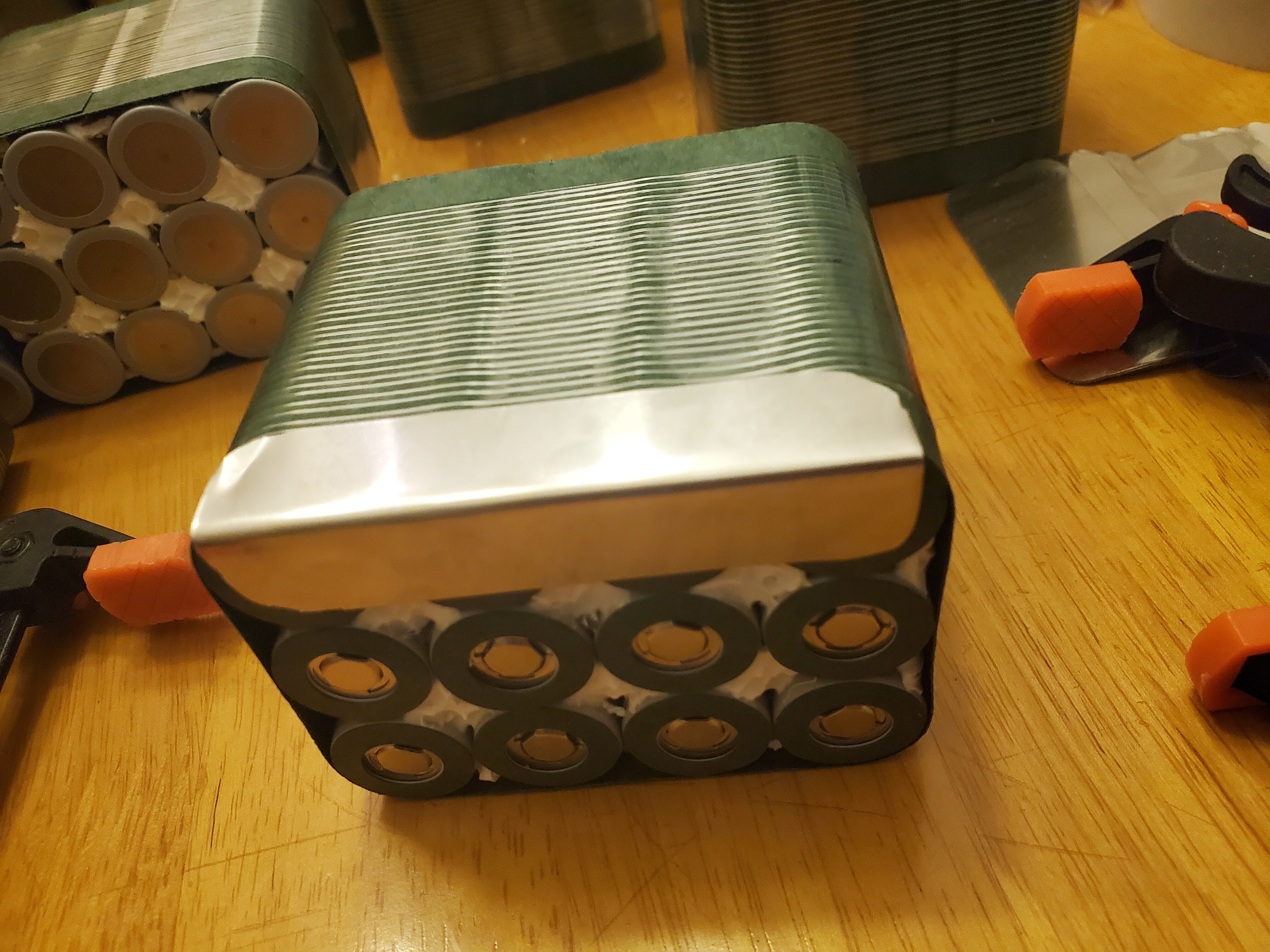

Does this look okay?
When I fold the nickel on the p group, the angle is obtuse. Then I bend it a little more with my hands to make it exactly 90° or a little less. Is that okay or does that make the nickel weaker at the bend?
Omg someone made this for Shua that’s fucking amazing
Yepppppp hahaha
That looks just fine to me.
You could always make a 3d printed bender-thingamajig with a few degrees of springback built in so you get a perfect 90 every time, but that’s up to you.
Unless your spacing is 100% critical, it should be okay if the nickle isnt perfectly at 90deg the entire way around. Once its spot welded, you can bend over the edge easily (Unless its .3 for some reason)

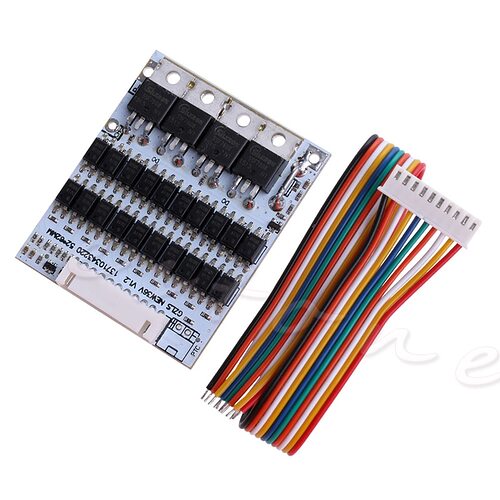

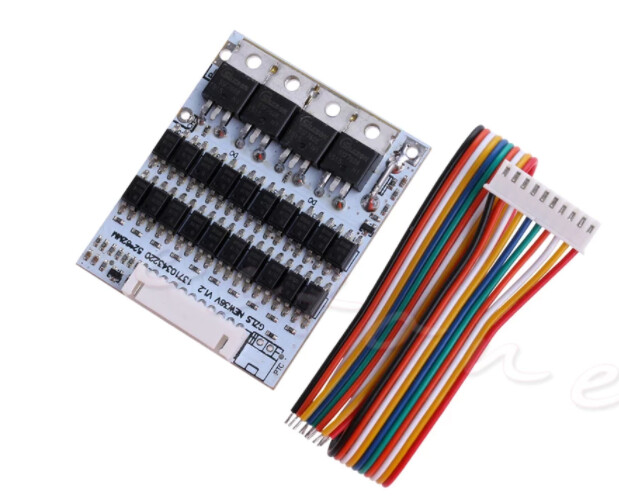

Hey does anyone know the balancing behavior of this 10s BMS?
I checked an old pack with recycled cells and it doesn’t really balance it. I waited with 42V connected for 3 days and nothing changed. The highest cell is at 4,25V
does not change. Does it only balance above 4.25v or is it broken?
Did you only connect the balance lead or the main lead too?
