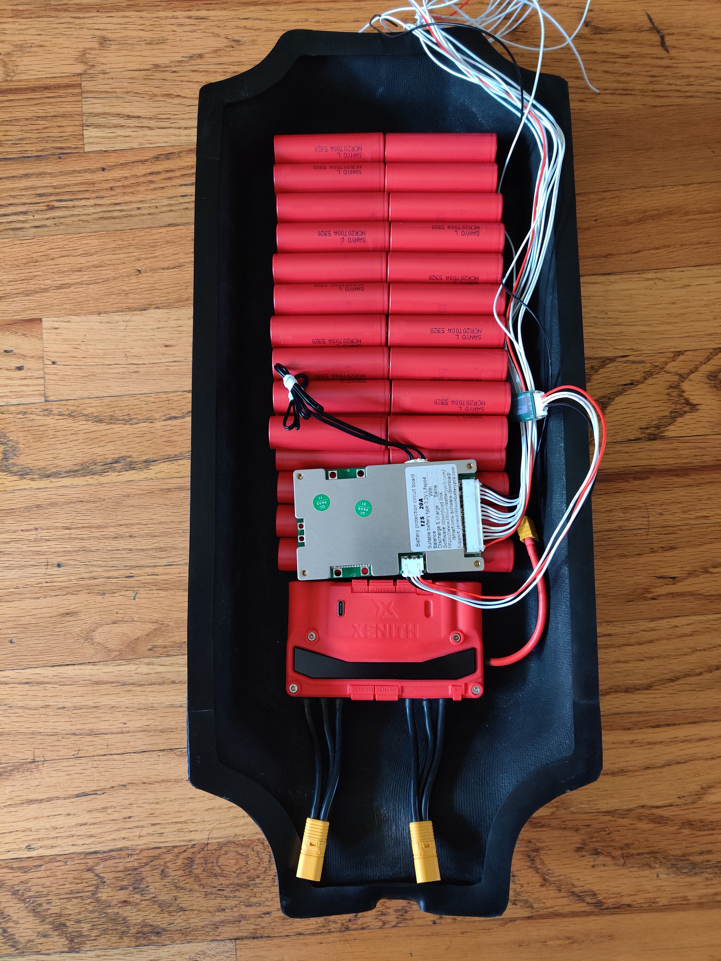

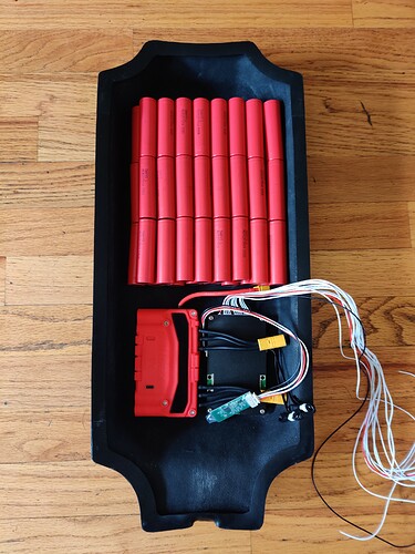

How should I layout my battery? I’m thinking of using the second orientation.
Also I guess a better question is, does it matter?
I would personally go with this one:

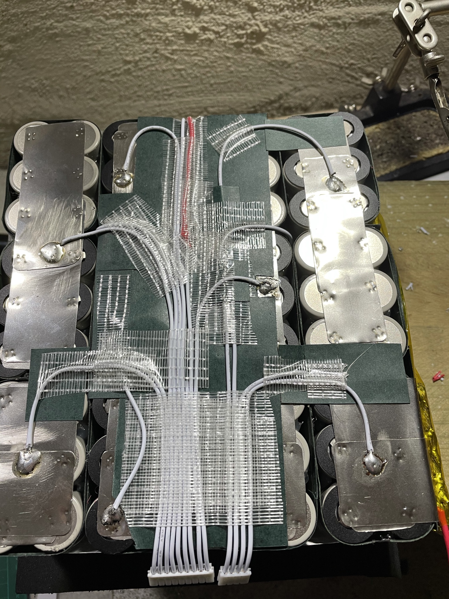

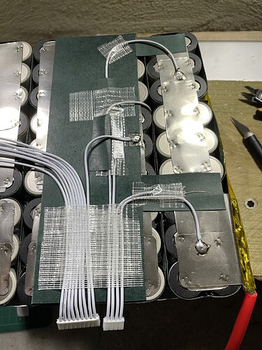

I did my best to prevent BMS leads from touching. Another lesson learnt in battery building is to be sure I test the BMS position first. In this case, I would have been better off moving the BMS to the side as it would have resulted in a cleaner result with not so many overlaps.
Ohhh well, the job is done now and it’s charged to 50.1 so happy days.
My only comment is that for your next pack try to avoid the center 3mm of the bottom of each cell. That is set as a “no weld” zone by the manufacturers due to that being the location of the internal spot weld for the negative connection metal tab from the spiral roll of stuff in the cell.
Welding externally to that same point could potentially affect the quality of the internal weld. I wouldn’t worry though about this pack as long as it tests out well. It’s just a “best practices” thing to make sure nothing could potentially happen.
Sooo many little bloody gotchyas, another item added to my little black book of battery building tips and tricks. Thanks, heaps @Battery_Mooch . What amazes me is how the professionals make it look soo good and easy. Building a better is time-consuming, stressful but also very satisfying in the end. After I took those pictures I spotted something I wasn’t happy with too so I had to fix it. There was a BMS lead sitting on a P group nickel join with no insulation below it :astonished:
