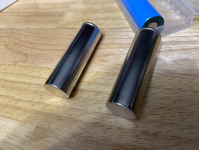

How do those two P42A cells compare visually without the wrap? Use a magnifier if they look similar.

So real cell is always on the right (from 18650battstore).
The cans look identical. The font for the printing is identical, the bottom of the can looks like it turns glossy at the pole on both. Positive poles look identical. Texture looks and feels the same.
Real cell printing:
The wrap itself is different. Which worries me. The known real cell has a glossier finish to the wrap, and didn’t tear as easily. It kind of stretched for a bit before it tore.
The new cell kind of just tore.

Do you have a IR meter?
Would be interesting to see mooch test the fake cell, and see if it is actually fake or just an older cell with a different insualting ring application method
Check underneath the top contact. Is the surface of the venting disk under the contact identical for the two cells?

If you can measure the IR and do a capacity test, that should be a pretty good indication. Do you have a dummy load right now? charge both the batteries and put a 10/20a load and see what voltage sag you get.
Yeah. It feels like all the tests you will ever do can only really tell you if they are 100% fake but never really tell you if they are 100% real. Annoying.
Yeah, I’ll rig my Kunkin up to do that. First I’ll throw them in my charger and check capacity and IR. It’s a VC8 so it should give me some information.
If the venting disks for the two cells looks identical across its entire surface then you might have two genuine P42A’s.
But, in my opinion those M&A cells are rewrapped P42A’s. This could mean they were either purchased unwrapped or that they were early samples and rewrapped to hide that fact. Either way I have no idea when they were made or what internal condition they are in.
There’s no way those are authorized cells wrapped by Molicel in my opinion. None of the major manufacturers have ever used self-adhesive top insulating rings and never will as they come in sheets and can’t be used in high speed assembly lines.
