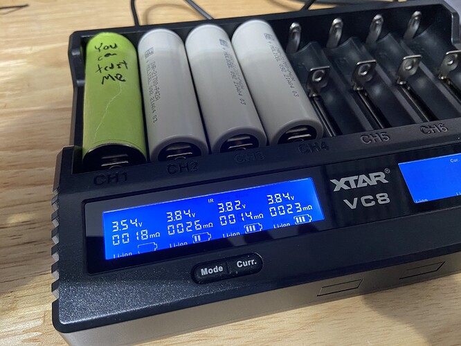

Retest IR at least three times, removing and reinserting the cell each time. If the results are not within a milliohm or two each time then they’re just too inaccurate to help unless those cells are verrrrrry far apart in IR.
You can press up against the bottom charger contact a bit when taking IR measurements to help with consistency

Say the IR and capacity and discharge curve on both those cells are identical. Surely, it means they are the same cell? The odds that there is some black market factory making fake cells as good as Molicel are slim to none. Am I missing something? Lifecycle perhaps?

Here’s what I got:

The legit battery should be the same voltage as the others no? AFAIK, charge level effects IR
Looks like they’re all about the same DC IR range.
I’ve gotten about 16mOhm-18mOhm in my tests.
Ideally, yes, they should all be at the same SOC. But considering the wide variation in the IR readings I don’t think the small changes in the IR due to the charge level will affect things much.
Certainly worth checking if possible though.
TBF, we already know the IR of the legit batteries so probably not worth the hassle.
Alright, well I’m grading the capacity of those cells now, which may take some hours since the VC8 charges them, discharges them to measure, then charges them up again before the test is done.
However given all the unknowns here, this doesn’t seem like the “fresh and genuine” claimed on the sale page. And I’m not going to put these into a 12s5p Prototipo for another person without being confident in them. I’d rather eat the time and hassle and negotiate with the person to go with something like the 40T3 cells that are available currently.

This is likely the last installment in testing the P42a cells in question. Charger finished grading the newly received cells, and the known real cell is still charging.
Results for the 3 tested cells show 1,636mAh, 1,780mAh, and 1,799mAh.
A bit off from the expected capacity…
Yeah… just a few percent off. :rofl:
Is this from 2.5v to 4.2v? Even the real one seems too low capacity.
