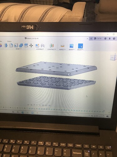

4s12p compression pack design.

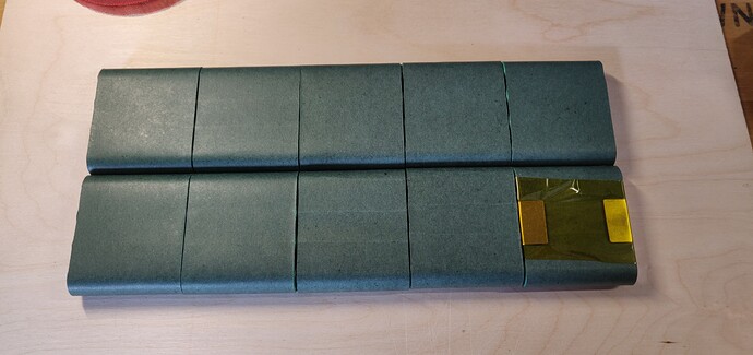

Any critiques on my battery building? It’s a rebuild of my old poorly made 12s3p pack into a 10s4p 25r pack with proper techniques. Used neutral cure silicone for each p group, surrounded by fish paper and @BenjaminF fish paper rings, use a small bit of Kapton to ensure the edge cannot get caught. Using a Boss welder (pack supplied by @Fosterqc… Thank you :relieved:) and 0.2mm pre cut nickel (tinned with blobs as well) and four welds per cell. The tabs of the nickel are bent over the edge of the p group using the cell ring circles to double up the fish paper and lessen the chance of wear. Lastly the p groups are connected together with 2x 12awg high strand count silicone wires from turnigy. I’ve Still got alot to go until it’s complete but I figured I should ask before I get too deep. Thanks!
lol! was thinking about asking how many more cells you needed haha. LMK if it gives out on you.
Could have gone down an AWG on the series wires I think, good idea to give extra in case one somehow came off I guess.
Looking good, up next mastering the balance wire arrangement!
I had actually started out with 10awg but it was just too stiff and flexing the nickel rather than the wire, it’d work better in a segmented enclosure where you can have >1.5" of wire. Tinned copper braid would be best in this situation? But it’s PRICEY and is it necessary?
I’ve got a plan for it!
Nope it seems to be okay, trickle charged it for a few days, we still have to use a longer delay than we’d like on the welder (some welds are a little hot) but if we want to fix it we could probably get a 3rd parallel pack :joy:
I think he meant down in size (up in gauge) to 14. Double 12 should be very sufficient for a 4p pack.
I did a brain dumb yes
