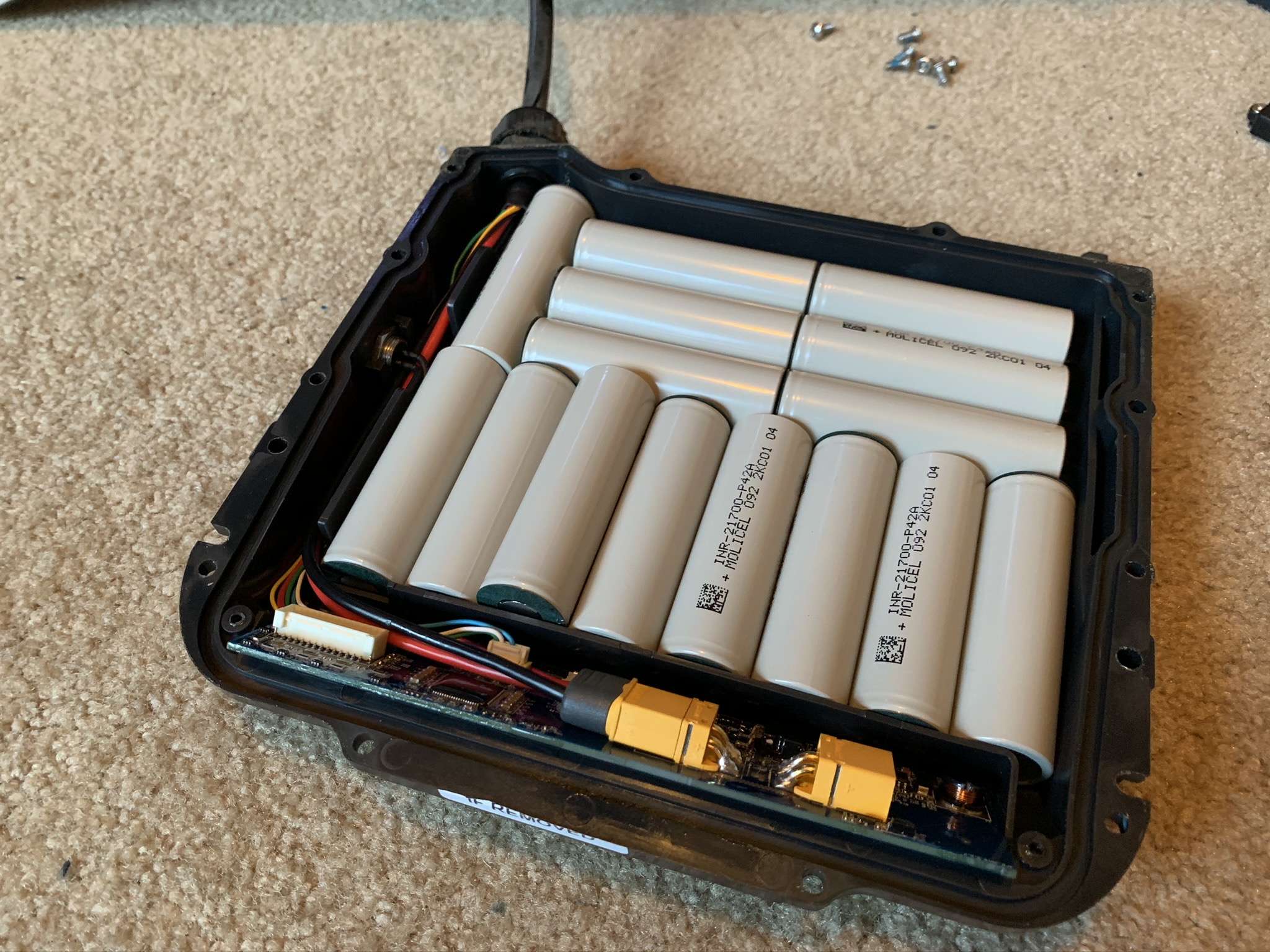

A friend wants a OW pint upgrade battery.
I can build one but I don’t know the layout and details.
I believe the stock one is 15s1p 18650 and the chi upgrade packs 15s1p 21700?
Does anyone have pictures of the layout or other information?
Thanks in advance c:
I got you one sec
15s1p P42A, follow the Chi video for where you need to remove material.
This is what it is - that one cell is sticking up because I didn’t remove the panels yet.
Here is @TheBoardGarage’s video, its very useful.
Wow that was quick.
Thank you so much!
Thanks for sharing, @JoeyZ5
:+1:

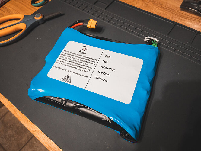

@Simeon
Remember the XT60 is wired backwards. Positive and negative wires are on the opposite spots as they normally would be.
And the ZDP connector and crimps are mildly frustrating. Take your time with them, screwing up one could potentially mean a restart of the whole connector.
Lastly, one thing that was helpful, was to leave the pack unwrapped so that I could properly distance the balance connector. I put the pack in the box, gauged the distance, then taped down the wires. Took the pack out, secured and shrink wrapped it, then installed it. It helped to eliminate unneeded stress on the balance wiring.
