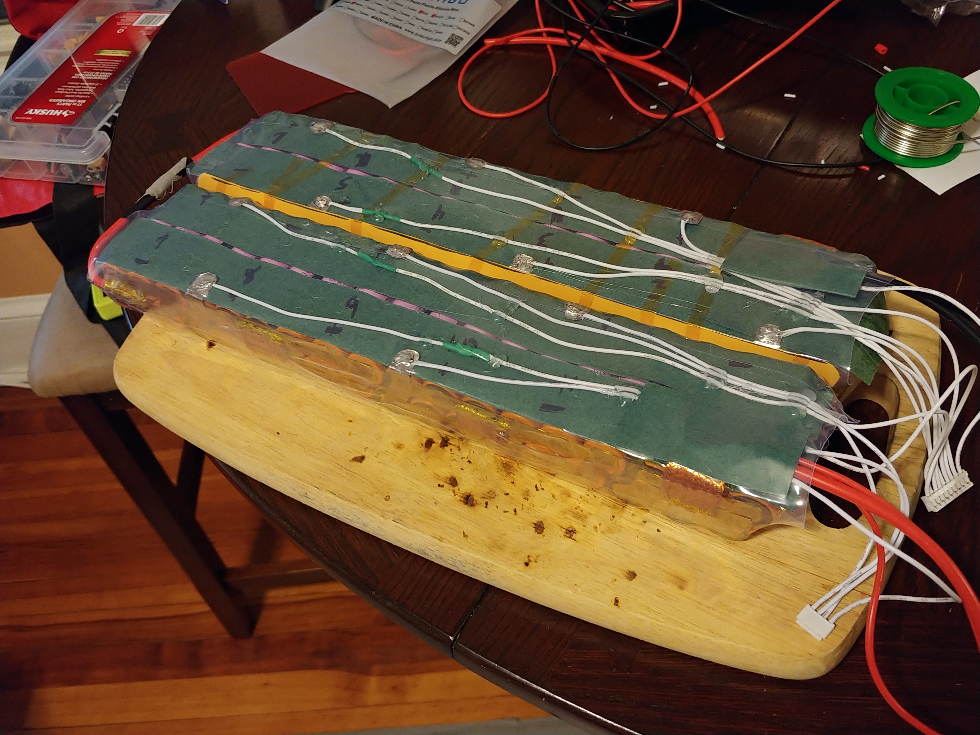

Been building packs for a while, finally started selling them to fund more personal builds since I just can’t scratch the itch enough these days. I’ll get pic of the actual welds next time, I had to get these out asap. How does this pair of 40T packs look?
The crossed balance wires may be a bit of a concern with vibration and abrasion…
I try to cross them in the spaces created by the cell arrangement gaps so there is no pressure on the crossing and they’re all taped down. If I’m worried about the spot specifically, I’ll tape the lower wire down as well.
I thought that might be the case. Good work

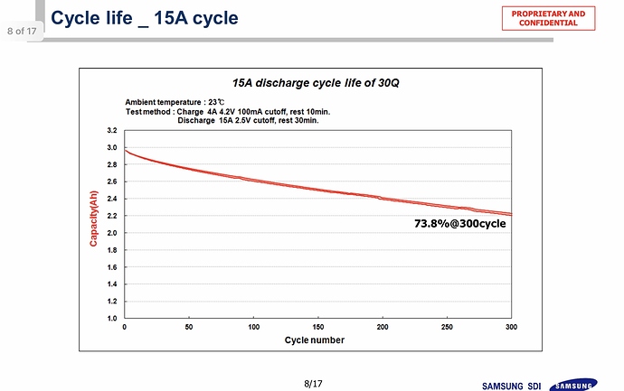

Hey all, been doing some cell research. I currently have a pack using 30Qs, they seem by far the most popular choice. Then I read these spec sheets:
Samsung 30q after 300 cycles is 2200 mAh capacity.
The molicel p26a at 90% after 500 cycles (how?!) is 2340 mAh.
I know a lot of people got shafted on these with an imrbattery sale, but has anyone else used these and can speak to their longevity?
Can’t say about the Molicel, but 30Q is a cell designed for power tools use, not for long life, I saw some tests that after around 500 cycles they simply die, no mater how well you took care of them
The truth is, 500 full equivalent cycles for our use is still a lot
