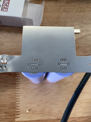

Hi guys,
I’m dialing in my malectrics welder, and trying to find a sweet spot. How do these welds look?
Left is 17ms and right is 19ms.
Too hot, the welder should not be poking holes in the nickel.
Ok thanks man! I’ll get a few more in and turn it down. I started at the 26ms that malectrics recommended and was working down.
