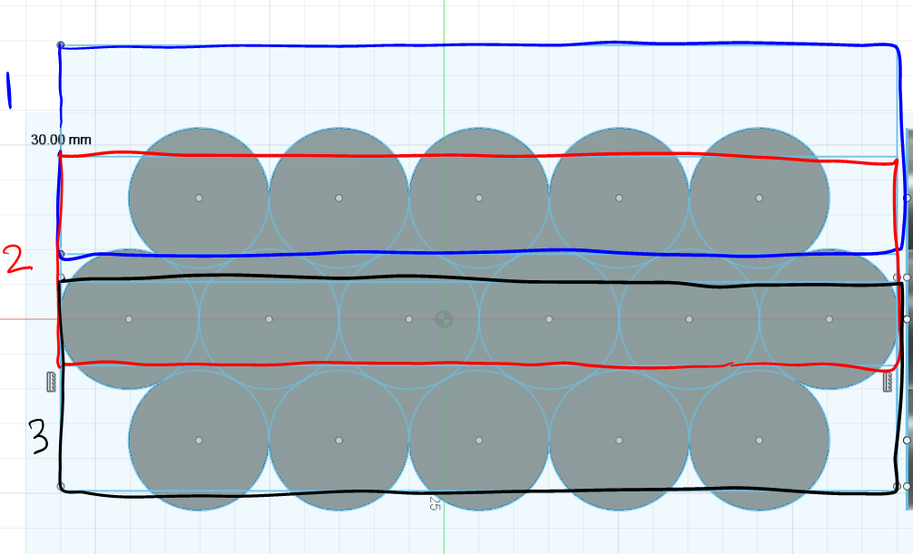

Im about to buy supplies to build a battery. It will be a 12s 16p staggered 3 stack 21700. Can I use 3 sheets of 30mm wide 0.2mm pure nickel like this? 1st will be bent over cell body for series connection. I plan on having the bms max of 100A continuous meaning at 16p, max is 6.25A. People recommend steel city store, is this the right one? The last thing I want is nickel-plated steel. Do you think 5 meters will be enough? 0.2mm * 30mm Pure Nickel Plate Strap Strip Sheets 99.96% pure nickel for Battery electrode electrode Spot Welding Machine|Tool Parts| - AliExpress
That’s the right one.
No, your setup with require around 8.86m, that is 72x 128mm strips. I would go with the 10m roll.
What you could also do is order this too:
https://www.aliexpress.com/item/4001349560425.html?spm=a2g0s.9042311.0.0.28764c4dxzVxgS
and use it for all the cell connections, then use a piece of 30mm folded over the top for the series connections. 3m should be pretty much exactly enough (125mm strips). Using 50mm+30mm nickel will be more expensive in the end. Basically less cutting and welding using 50mm+30mm but cheaper to just use all 30mm.
Though with 50mm wide nickel it will be harder to place the welds correctly in the middle set of cells.

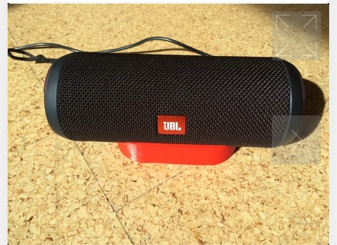

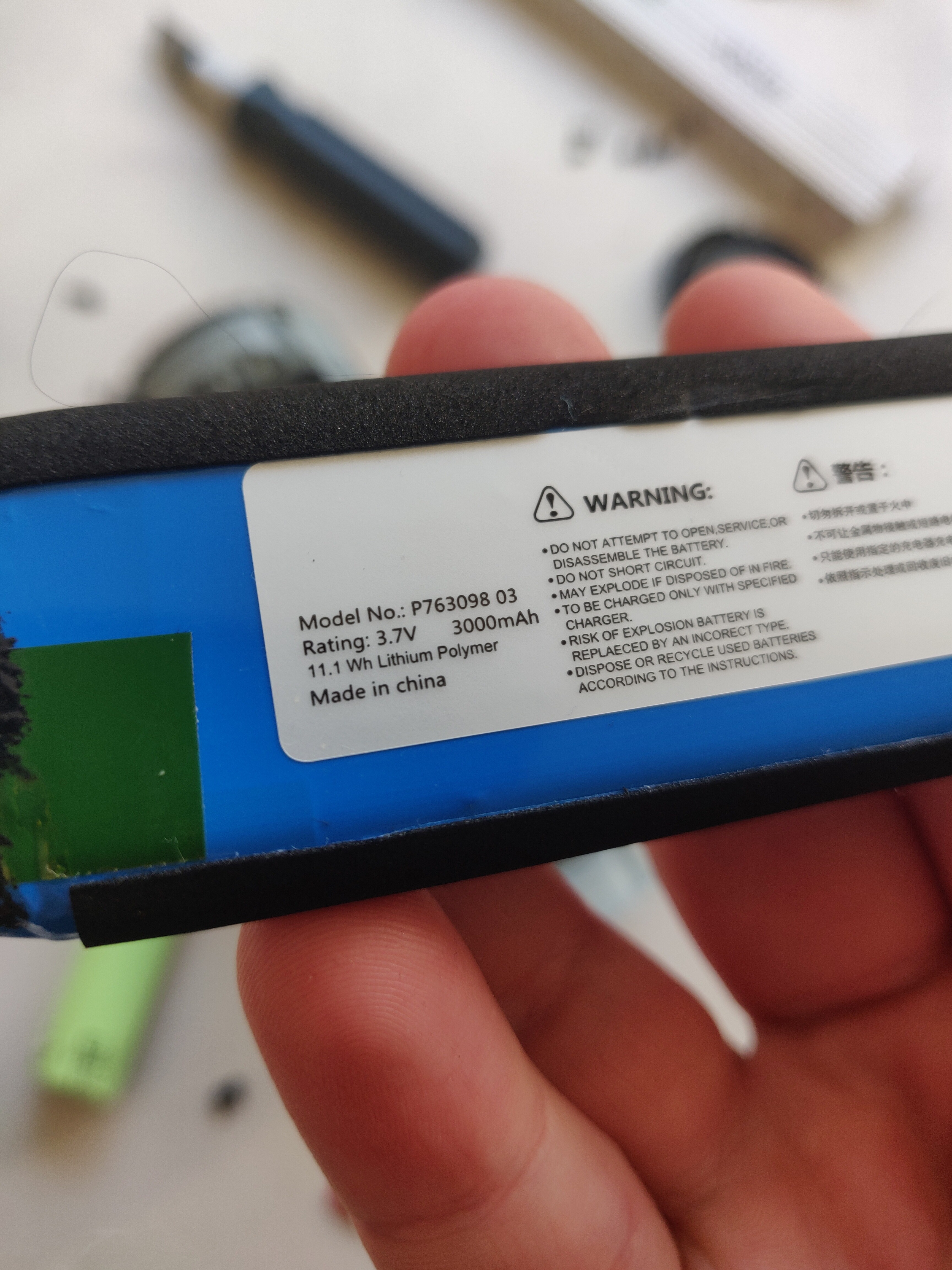

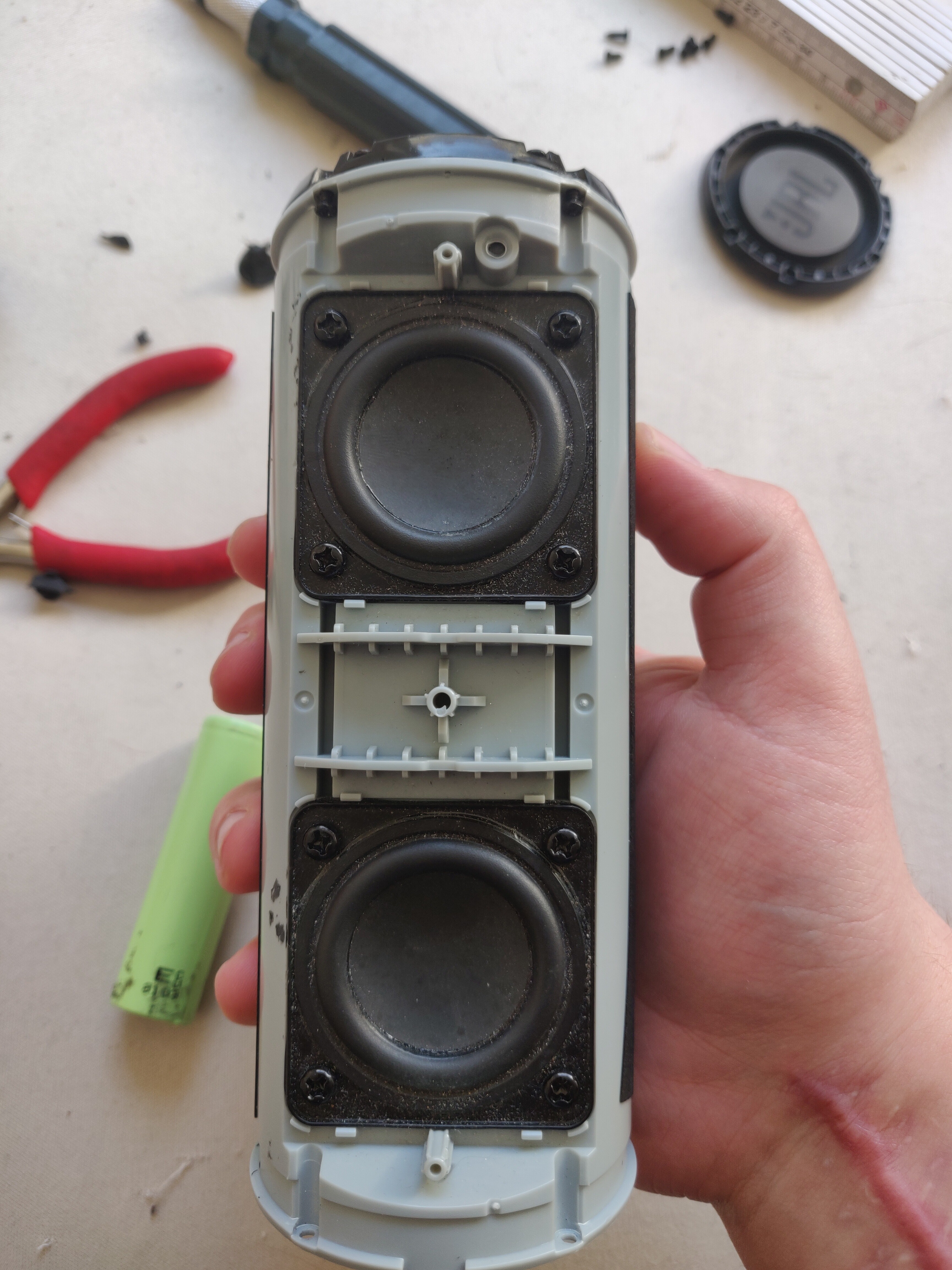

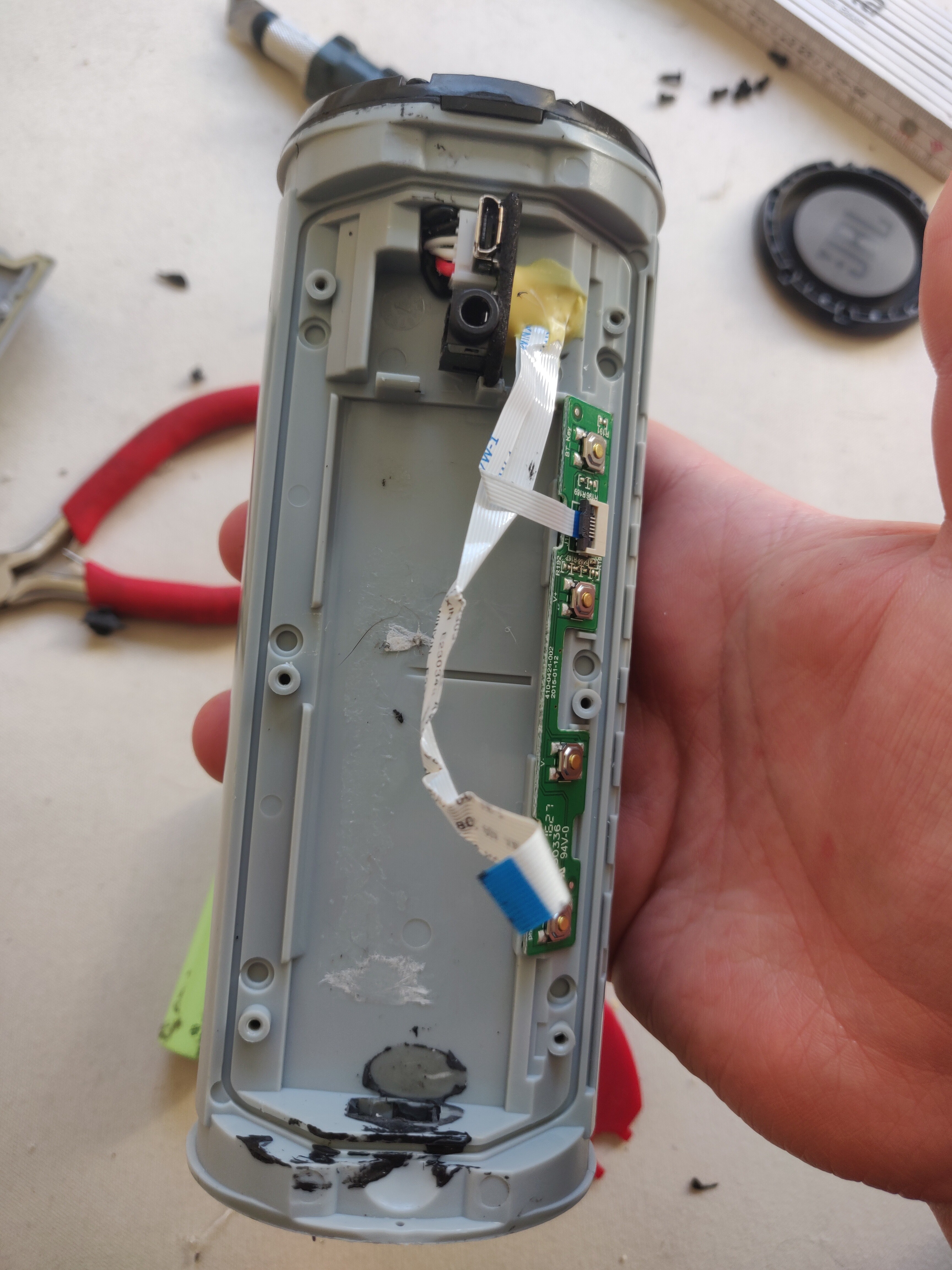

My JBL flip 3 speaker battery is pretty much dead and I don’t want to shell out 20-25€ for a new potentially shitty battery.
I just finished disassembling the speaker to see if i could fit a 18650 but there’s no way.
My idea was to mount the batttery on the outside and integrate it into a stand with a cable running from the connector to the stand.
like here
Thinking about doing either single 18650 or dual in parallel. I think in this case it’s not a bad thing to solder the 1 or 2 cells together.
